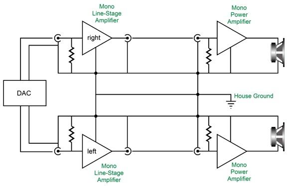

Technically, multi-channel all-room or home theater amps can be called multi-channel mono amps since each channel can have a separate input and output capability.

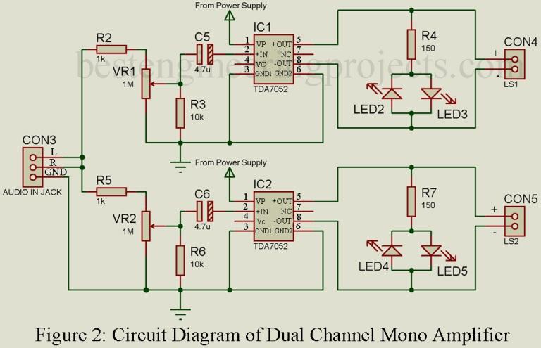

I did find some cool schematics though.
Each symbol for an amp in that diagram has a single output.
I'm trying to find the unicorn circuit symbol of a mono amp that has multiple unique outputs, not a single output connected to 2, 5, 30 terminals.

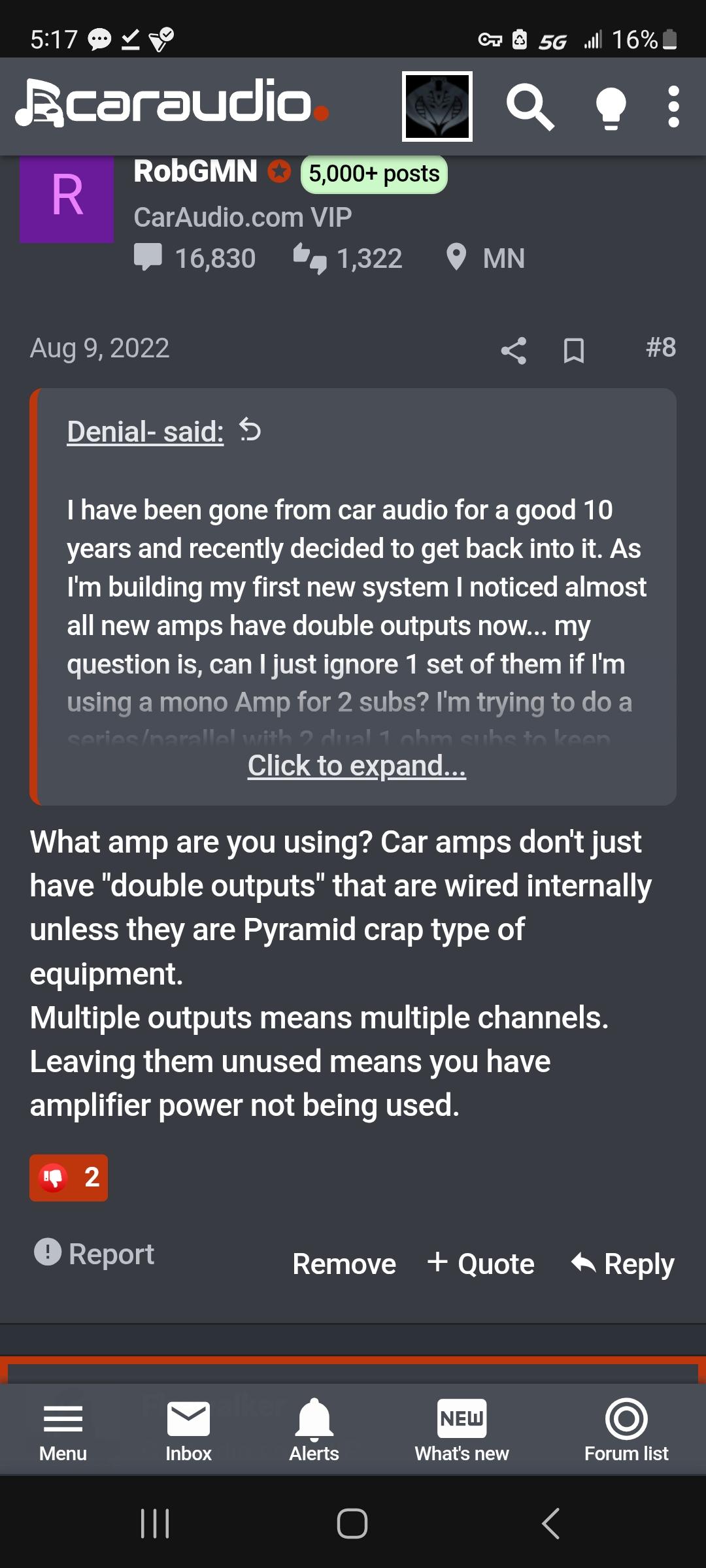

Let's get the question in context...
This reply
From this thread:
That's why Rob is asking 😉🤣

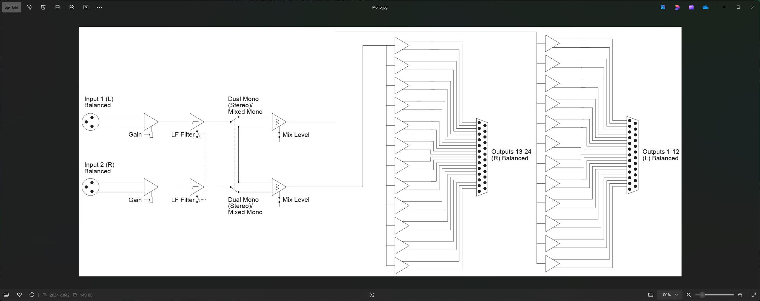

So, multiple monoblock amps in a single box, like Dox says.

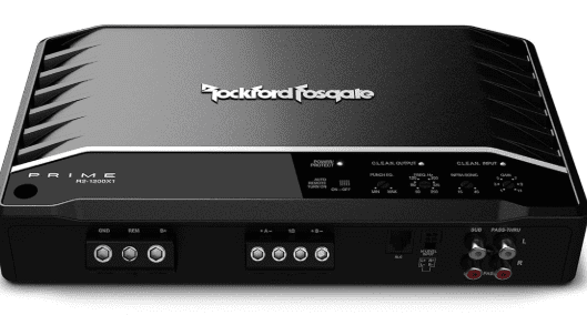

Anyone know of a monoblock car amp that can be bridged to itself for more power?
How would I wire this one to do it?
