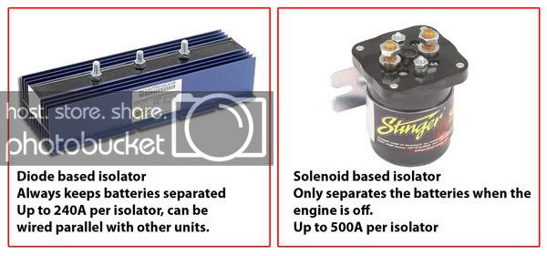

First off, you DO NOT want a solenoid based isolator. You want a diode based unit. Your friend might not know about them. They keep the battery isolated even with the engine running. The solenoid type only disconnect the batteries with the engine off. The proper type of diode isolator should be less than $100.
Secondly, since you have plans to upgrade to the 1500W amp, you might want to go with a solution that will be up to par for that system. If you want to buy something to work with your current setup, chances are you will need to upgrade again when you upgrade your system.
My suggestion (similar to above) is:
1) Big 3 (done)
2) Biggest AGM battery you can afford in back
3) 200A diode based isolator (see picture below for reference)
1) Big 3 (done)

Battery Isolators:
Many people listen to their stereo without the engine running. This often leads to dead batteries and a vehicle that won't start. A battery isolator will let you completely discharge one battery without discharging the starting battery.
Different Types of Isolators:
There are 2 main types of battery isolators. The diode based type and the relay (solenoid) type.
Diode Based Isolator:
This type of isolator is basically two very high current diodes in a heat sink. The diode based isolator has the advantage of long life and trouble free operation but many of the diode based isolators cause a .4 to .6 volt loss which means that the batteries will not charge to as high a voltage as when they are connected directly to the alternator.
Solenoid Based Isolators:
This type of isolator uses large high current relays to control the flow of current. The advantage of the solenoid based isolator is that there is virtually no voltage loss across the contacts. The main disadvantage is that the reliability isn't quite as good as the diode based isolator.

Nope. You can find them on eBay for well under $100. You should look for one that is rated at or higher than your alternator's max output rating.
So, if your alt is rated to make 120A max, then you need at least a 120A isolator.
oh alright gotcha i put a link for the seloniod one i need the other one the bar one, i just looked on ebay, the 200A ones are like 150-200$cdn and i found 140A for like 100-130 what would be better the 200 amp or 140 amp id prefer not to get a new alternator as it would be a month or 2 till i can get one.
