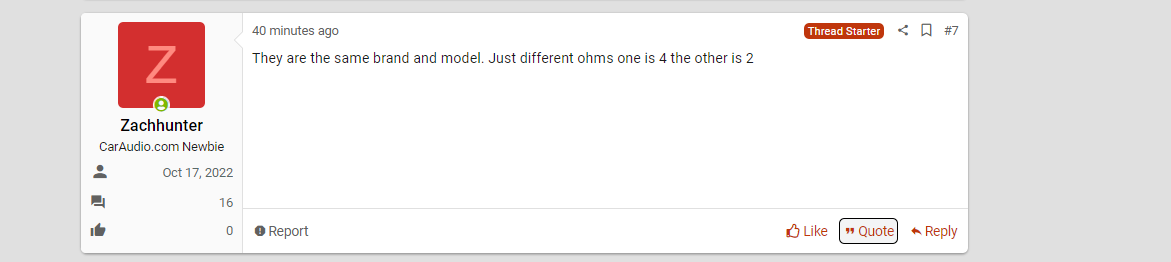

Both are comp r 12s both are dual voice coils. One sub is 4 ohms the other is 2 ohms. This is how I got it from the guy. They are the same sub. Different ohms. This is my issue
OK. SO they are two different subs. I asked this specifically to avoid confusion for you as a neo, and for the people here trying to help you.
