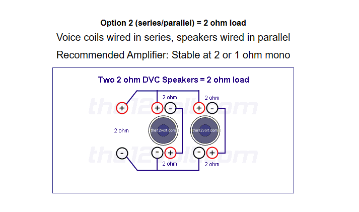

Dual DVC-2-Ohm in different sealed enclosures
THIS

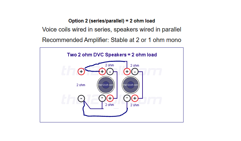

IS THE SAME AS THIS:
One coil + to the other coil - (on each).
The other + & - to the terminal block.
Terminal blocks wired straight to the amp, connect the wires at the amp terminal.
