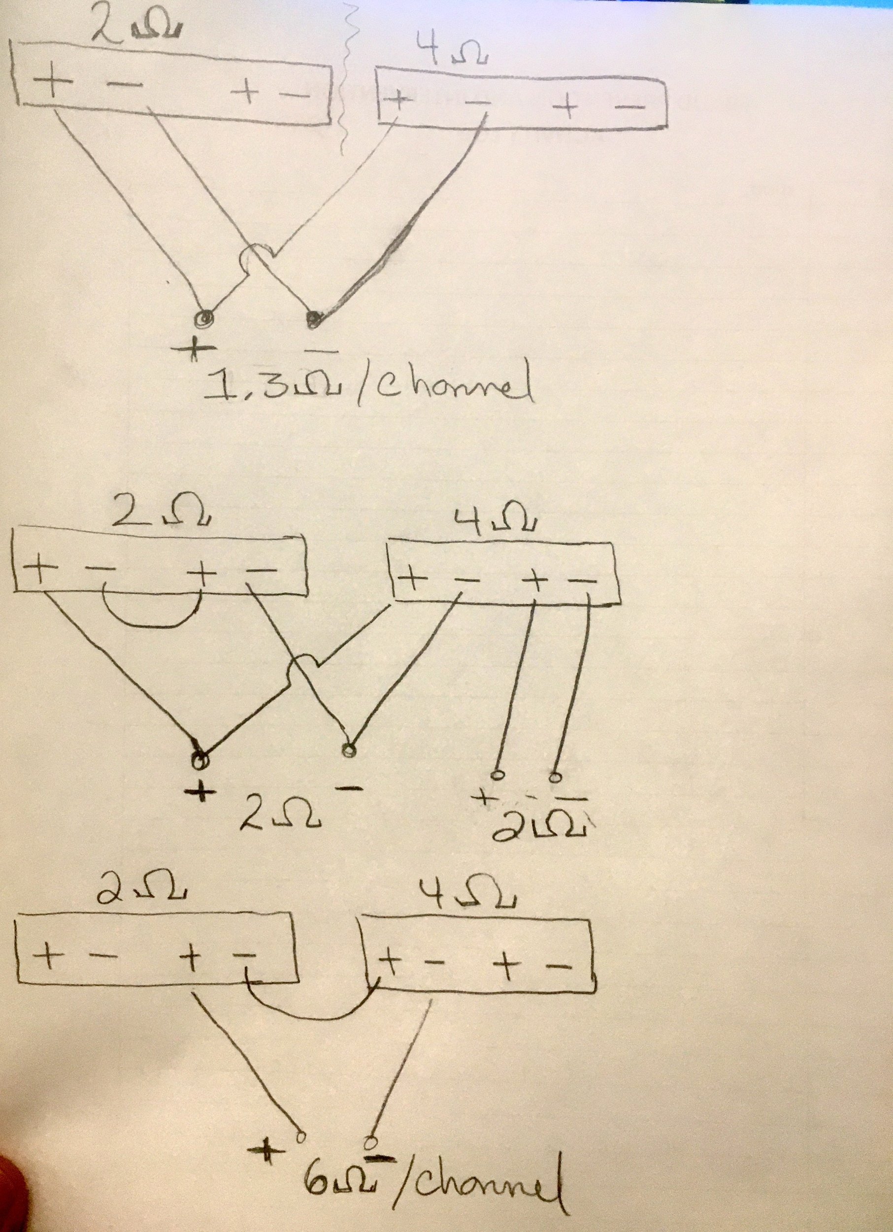

Different ohms on subwoofers.
Jesus Christ.
Don't.
Subwoofer impedance must match.
Sell the 2 ohm. Get another 4 ohm and buy a monoblock amp that is 1 ohm stable.
End Thread
It's not a big deal to do it that way, but he'll be getting the least common denominator of the two subs.

As long as you don't overpower them, there is no danger of harming your gear, once you get a new sub so they are both the same, you will likely...

THIS IS THE SAME AS THIS: One coil + to the other coil - (on each). The other + & - to the terminal block. Terminal blocks wired straight...
