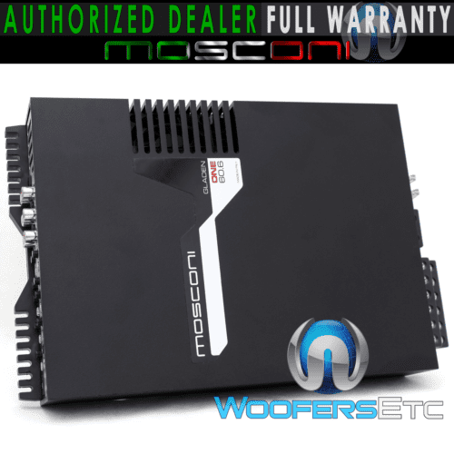

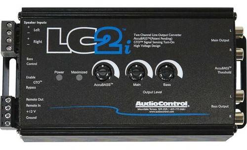

Or consider getting a line out converter and installing a 6 channel aftermarket amplifier, like this:
LOC:
And amp

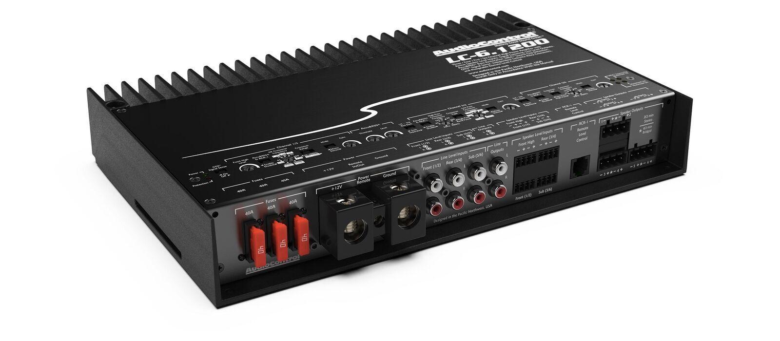

or
Or this amp which doesn't need the LOC:
