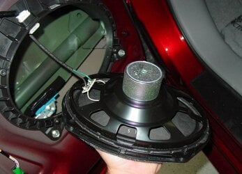

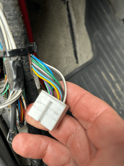

One more question..before I screw up I might as well ask you. Trying to splice that amp into the door speaker. Im confused about the correct wires. I see all kinds of conflicting info out there. The first pic is from the wire harness in my car, the other red one is from crutchfield. It shows a grey and green wire. Is that the right one? is the right and left side of the car the same (in terms of speaker wire color)?

I couldn't say forsure
You would need to make sure you have the right wiring schematic
Sometimes manufacturers change the colour from inside the door to outside the door where the harness clips
Maybe best to start a new thread in the wiring installation category
