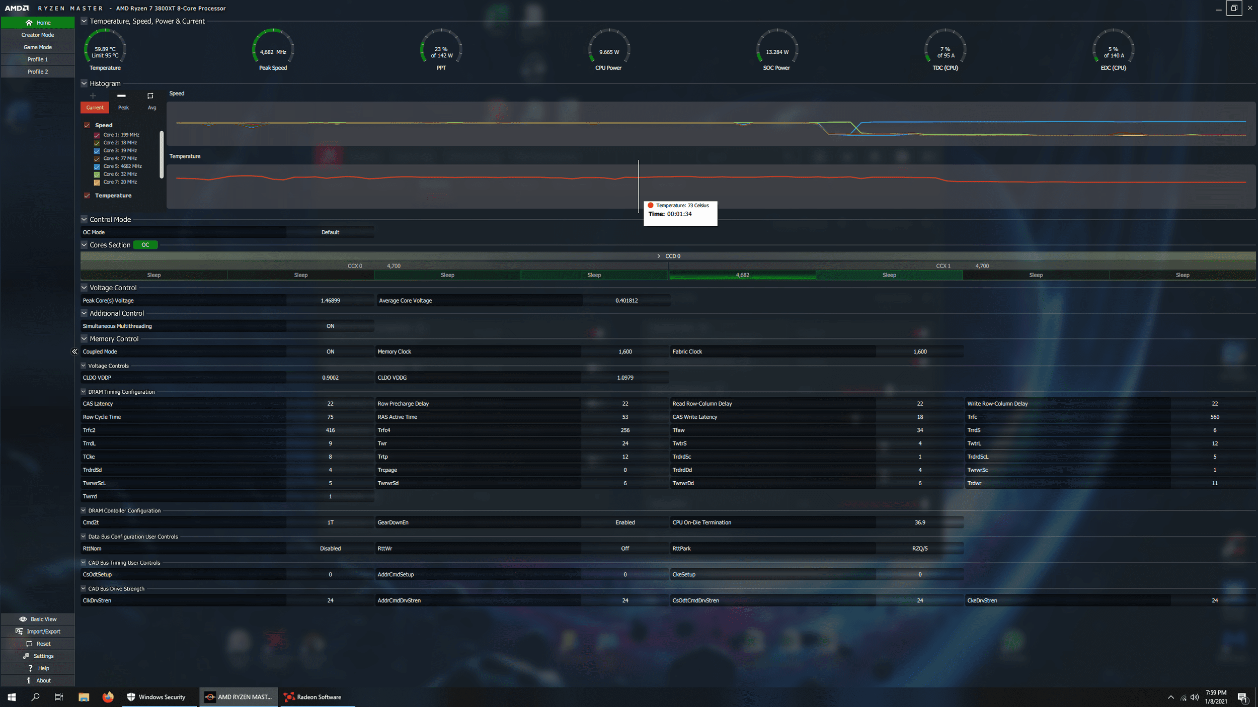

Holy crap. I spiked at 80 degrees C, thanks to windows defender. Look at my CPU speed. My CPU is NOT overclocked.

I mean dude I was hitting 4.7 ghz without overclocking, which is the max overclocking speed. Windows was using 100% of CPU during that, I was watching it. Spiked to 80C shortly then went back down as soon as my fans kicked in.
So that huge CPU spike, based off what I've seen during normal usage where I'm not maxing out the CPU, I set my own AIO curve. It's very low until it hits 45C then it ramps up some to 60% speed @ 60C and then it's basically straight up to 90%@ 65C and the BIOS makes it be at 100% by 70C no matter what. The auto curve was pretty conservative so I had it start ramping up from 0C-45C is 20% speed (~800 RPM). Then it should hit about 1680 RPM (60%) by 60C, then 90% by 65C, then 100% (~2800 RPM). I'll adjust as I see fit. I keep Ryzen Master open literally whenever I'm on my computer, so I'll watch how it spikes. I didn't like how it spiked to 80C, even though it wasn't going past that. That's 176 degrees Fahrenheit. I didn't take kindly to that kind of heat, so I want to try to enact stronger cooling at an earlier stage.
I also set my fan step up back down to 0 seconds since they won't step up from ~65% until 65C, and then they have a 12 second step down time. That way if it's hoping around, those fans will still be ******* in air through that radiator for 12 seconds no matter what the temp does. I've learned a lot about what heat levels should be under normal usage. This is a 3800xt, so it's gonna get hot no matter what. My max wattage rating on this CPU with overclocking seems to be 142 watts. That creates a lot of heat.
Good news is that it drops very quickly once the processing is over. In literally about a second or two it went from 80C back down into the high 30's, so the cooler is working. I think this 3800xt BISH just gets hot LOL
Temps would be higher if you hadn't done the MX-4 I can tell you that right now. AMD seems to run hotter for some reason yet I have people telling me that Intel runs hotter. I know mine doesn't run all that hot when I am gaming and pushing the system. But I have seen Intel as well get that hot. Thankfully that is what those liquid coolers, the better paste and fans are for.
Yeah I've seen some people saying they've reached like 95-100C and many people reached 80C+ so I think I'm good. I'm just not familiar enough with the limits yet to know what good or not.
