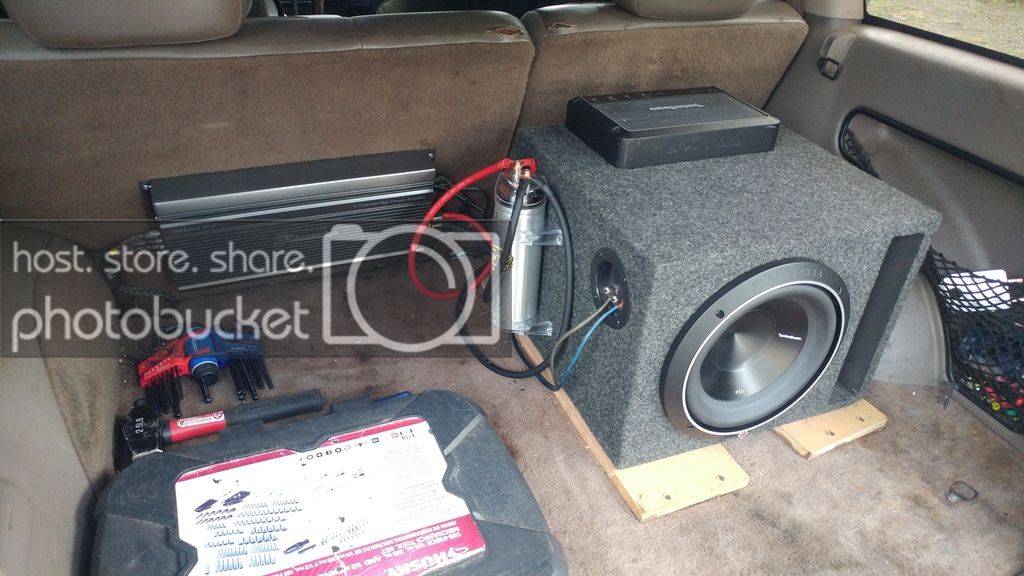

Here is my tiny ten.

I know everybody and their mothers are quick to say "don't waste your money on a cap, buy an AGM or second battery" and that is fine if you don't mind running more cables, securing the second battery for safety, the added weight of an extra battery(s), the cost of quality, multiple batteries and so on. I am not against running a second battery, not by a long shot. However if/when I decide to do that then it becomes an investment because I won't be buying 1 battery for the rear, I will be buying two of the exact same batteries. The OEM size for the vehicle and the exact same battery for the system.
Since I have a "small", "modest" system and I don't want to spend the money on batteries, I am upgrading my capacitor. I am removing the 2 Farad "band-aid" stinger cap and installing my SPC5010 Stinger 10 Farad hybrid cap. Weighs less than a battery, cost me less than a battery and looks cool. Anyway... here it is.
the fuck?? how is it cheaper? that sh*t is 160 bucks. You dont have to get a group 31 battery even though a sam's club duracell platinum (deka intimadator) is about 180 that will literally be like installing 1000 of those stinger caps... You can get a much more compact battery for less than 100 that will still outright destroy that stinger cap... literally makes zero sense paying for that snake oil err i mean cap.
Why oh why on earth would I ever get an automotive battery designed to start a car and make it run a stereo system???? They make batteries designed for stereo systems. If I invest in a multi battery system, they will be the right kind of batteries. It was $138 shipped. The batteries I was looking at are like $320 per battery.
For the most part a battery is a battery. Find decent cca and reserve
Those deka batteries have been proven to support a few thousand watts alone
Also You can throw a battery in the rear and use it without replacing your front battery although it is good to use both as agm. (Again I know many people who mix agm and wet cells and they work fine)
You could even put a smaller $100 agm in there and that would be better than that cap
A super cap bank costs about $250 and is around 350F. Those are good to help support roughly 3kw with other supporting modifications
