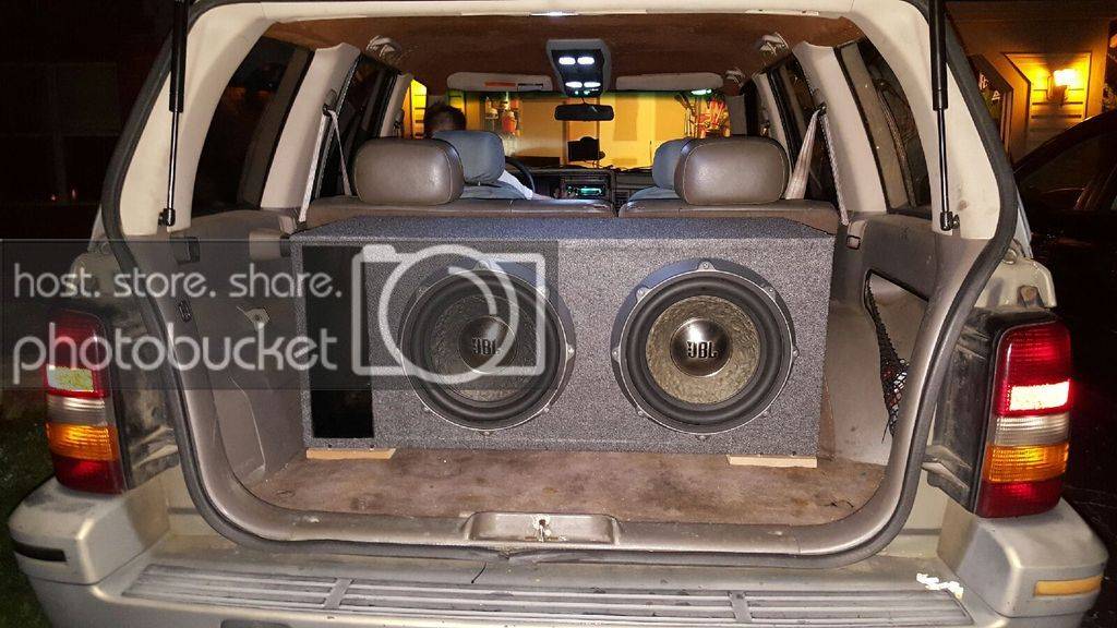

My old subs and enclosure that I built, tuned to 27.5hz roughly. It weighed over 200lbs with the subs installed which is one of the reasons I downsized to a single 12, then to a single 10. I'm just not a basshead anymore. I like bass but I am happy just hearing the music now.
