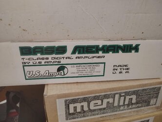

Anyone know why the car audio industry stopped making T-Class amplifiers? Also what makes T-Class special ? What's the pros and cons of T-Class? How does T-Class do against other classes ?. I have googled T-Class and done some research but I would like to hear about it from guys that have actually used this class of amp in the field. Id appreciate any knowledge IMG_20250414_140704756_HDR.jpg

T-class are more efficient than AB, but not as efficient as D class. I had one of the Blaupunkt T class amps. I couldn't hear a difference in sound quality. I would assume a Bass Mekanik edition of a US Amps would be high quality. I would google search for that specific model/series and see what you can find.
Tripath chips are expensive and have a limited lifespan. They generally are not worth fixing. That is why they never caught on.
I was thinking something like that. Where it cost too much to produce so it wasn't implemented in future models. Lifespan is also a big problem especially if it dies fast. Thanks for the reply I appreciate it

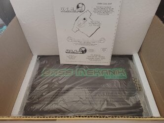

I have 2 brand new T-Class Bass Mekanik amps. I was thinking of actually using them but I might just sell them instead
