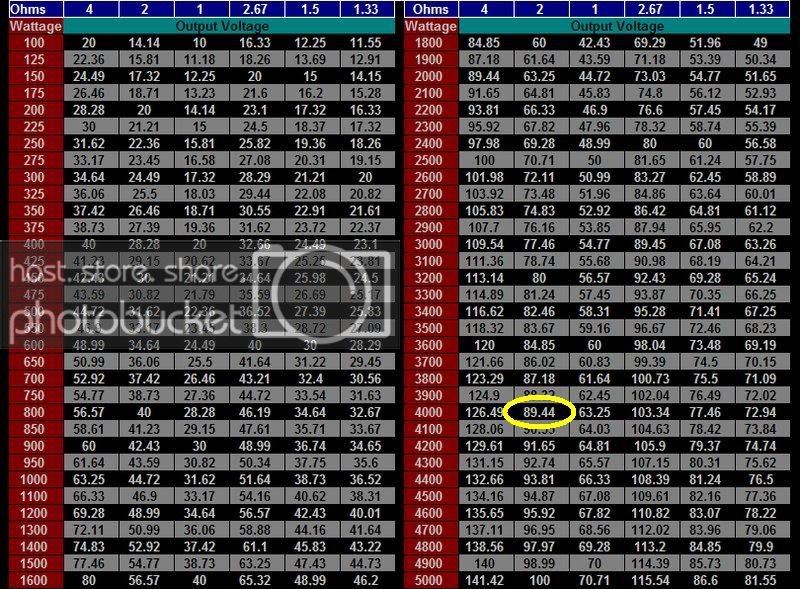

Set your gain with a DMM on 50hz with the DMM set at VAC with the speakers unhooked. Match the numbers to your amp. Will get you close then fine tune by ear.
Circled number would be VAC at 2ohms with 4000 watts RMS.
