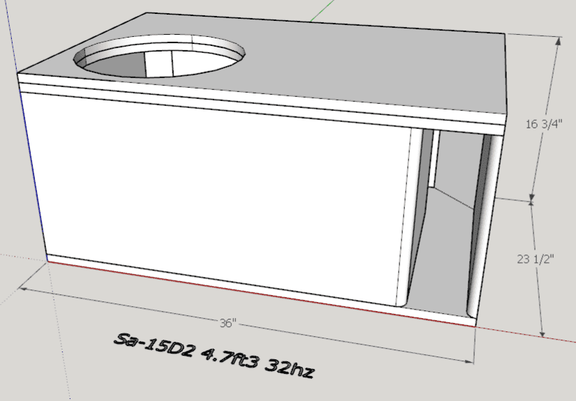

I went out and meassured the trunk, and the design of it is kinda stupid.. the space closest to the rear seats have this kind of curve that takes up alot of space. I would have taken some pictures but its kinda late and dark. But this is excactly like mine. The thing you see on the top of the seats can also be removed https://www.google.no/search?q=Bmw+e46+wagon+trunk&source=lnms&tbm=isch&sa=X&ved=0ahUKEwiCsc2-3b_aAhUDhiwKHZqUATYQ_AUICigB&biw=1745&bih=885#imgrc=MFk96KuEwOpn3M:
The numbers I got was H20 x W36 x D23, and I could maybe go up to 27 in depth if needed. Are you sure that box isn't designed for an E46? Hahaha.

I'd go with a single 18 inch sub in the space available to you with the dimensions you provided.
Really id do a single 1-1.5k 15" sub in an enclosure
tuned to 33-34hz and add a decent AGM battery or 2 if needed...then watch voltage. A 1.5-2k amp would match the sub well and if voltage drops too much , cross that hurdle if it becomes a problem.
