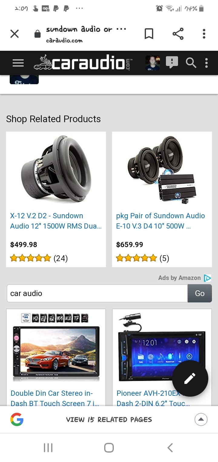

Ebay look uo sundownaudio ported 2
5 cu ft box ull find 1 for 289$ well worth it!!

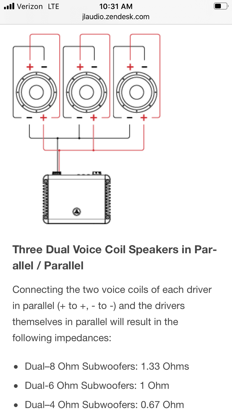

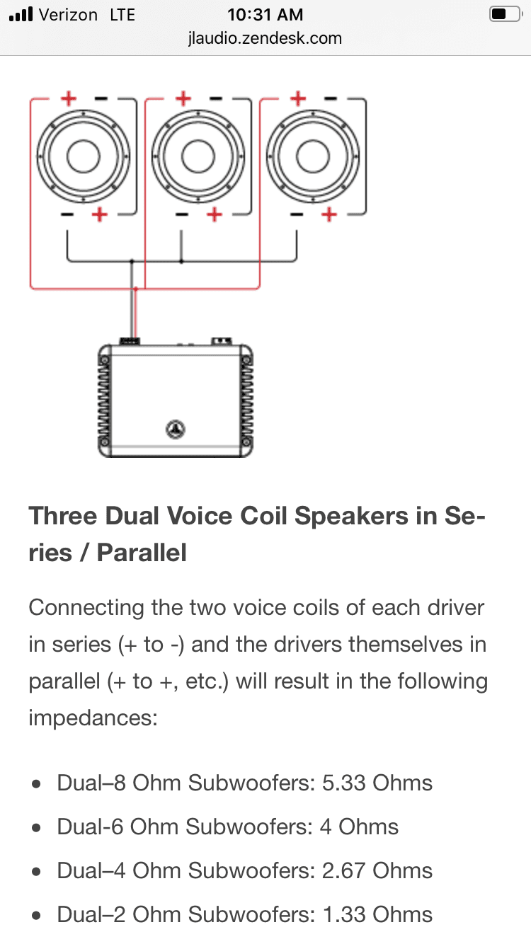

Don’t buy a box off eBay. Have it built. And with 3 subwoofers, which im guess they are dual 4 ohm subwoofers, would wire to about 3 ohms in series or about .5ohm in parallel. So either you will be seeing less power by adding a subwoofer or you will damage that amp in due time. Your gonna have to get another subwoofer and amp (my choice) or ditch that new subwoofer and go with 2 subwoofers and the amp you have or just get another amp if you want to run 3 subwoofers. And them subwoofers want about 1500 rms a piece.
