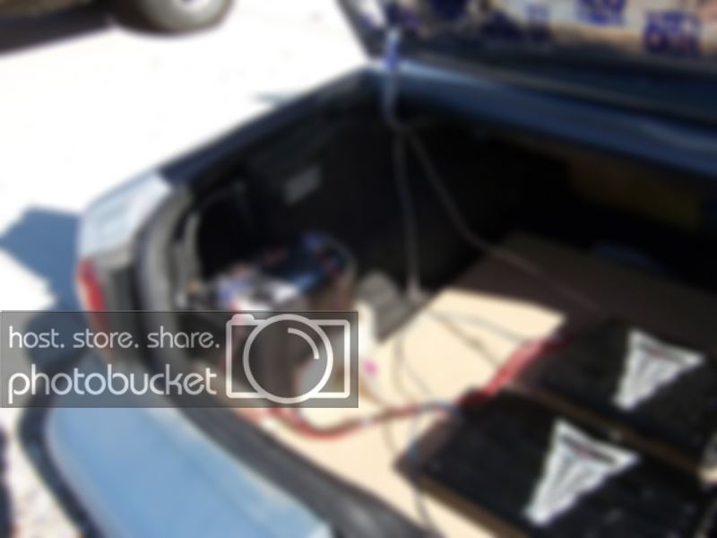

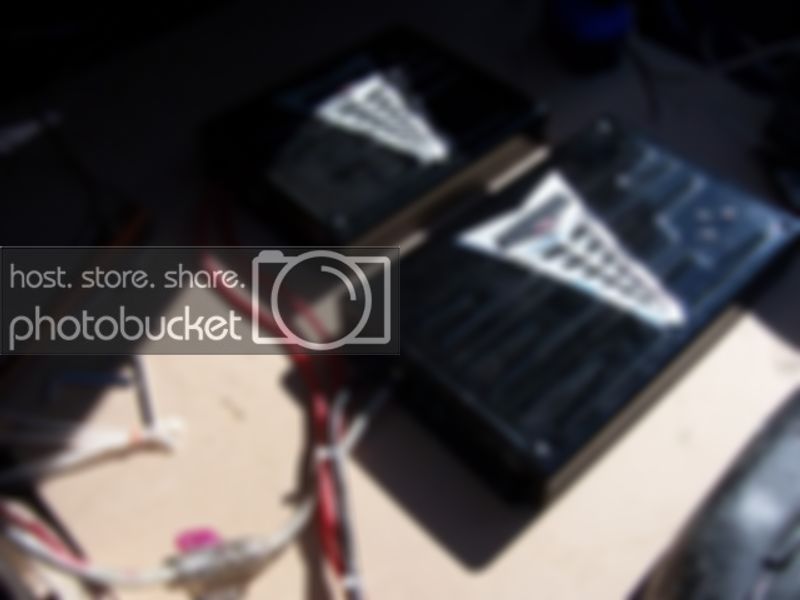

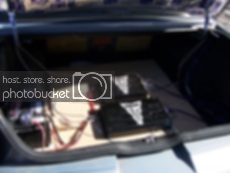

Got the front stage done! Took me a little bit since I had to run out to the store and handle some other stuff, but nonetheless its done!
Got my amps temporarily mounted in along with my battery in the back. Wired in the tweets, plugged all the rca's into my deck and flipped it over to 3-way.
Already sounds great after just a little tweaking. I went for about about a 15 minute cruise and started dialing everything in.
Ive got the mids crossed at 50hz with a 24db slope....they LOVE it!!!
The top end is crossed at 2.5k @ 24db.
The tweets were a little hard to get dialed in. I knew it would take some tuning to balance them out with them being in the a-pillars. I started off messing with time correction a little but the top part of the stage was still waaay out of balance.
I flipped the filter setup from L=R to L/R, then dove into some adjustments with the tweets. I ended up turning the level on the left tweet way down in the crossover, which helped, but not enough. Then I crossed the left tweet at 6.5k and the right at 8k....all with 24db slopes as thats what has sounded best so far.
Now the fun starts, I get to drive around and tweak it!!!

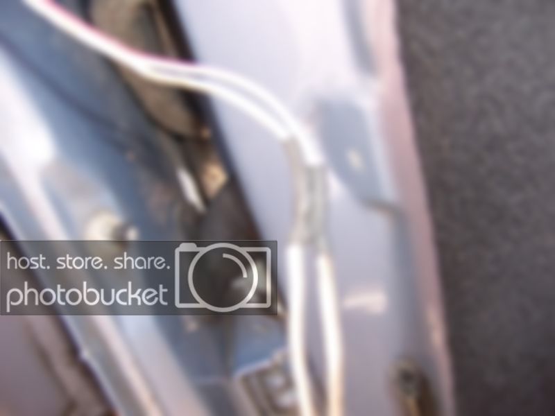

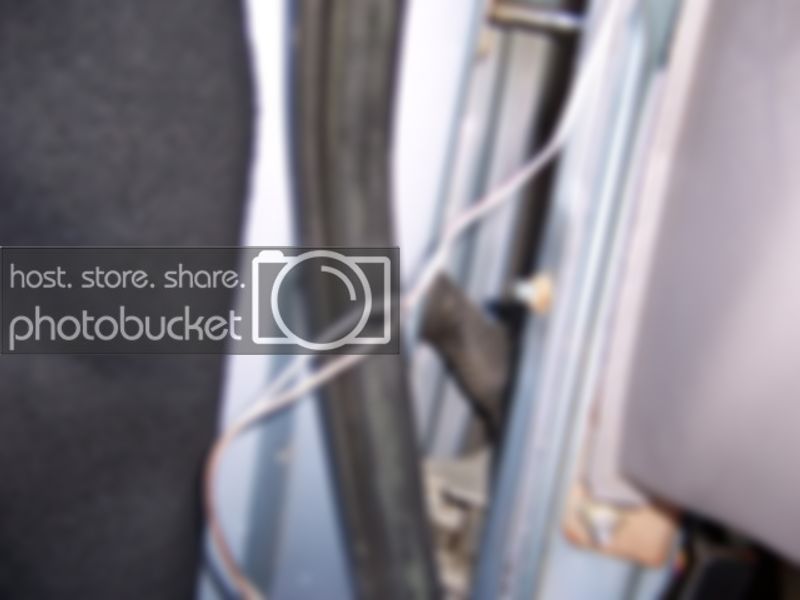

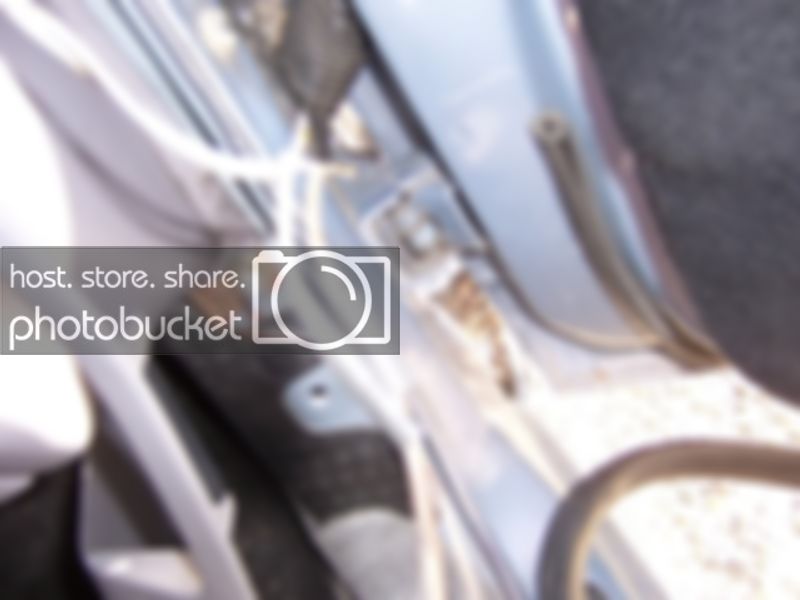

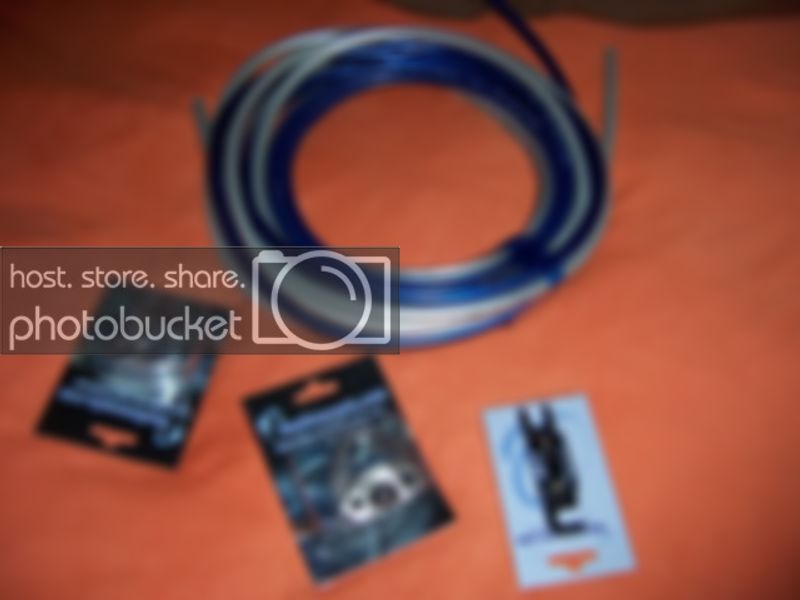

get some techflex and heat-shrink for the wires.
All the connections are heat shrinked....thats whats in the pics.
Everything in the trunk right now is temp just for dialing in the front stage.
I still gotta make the sub box and false floor, but all the wiring will be hidden under the cover panel.
