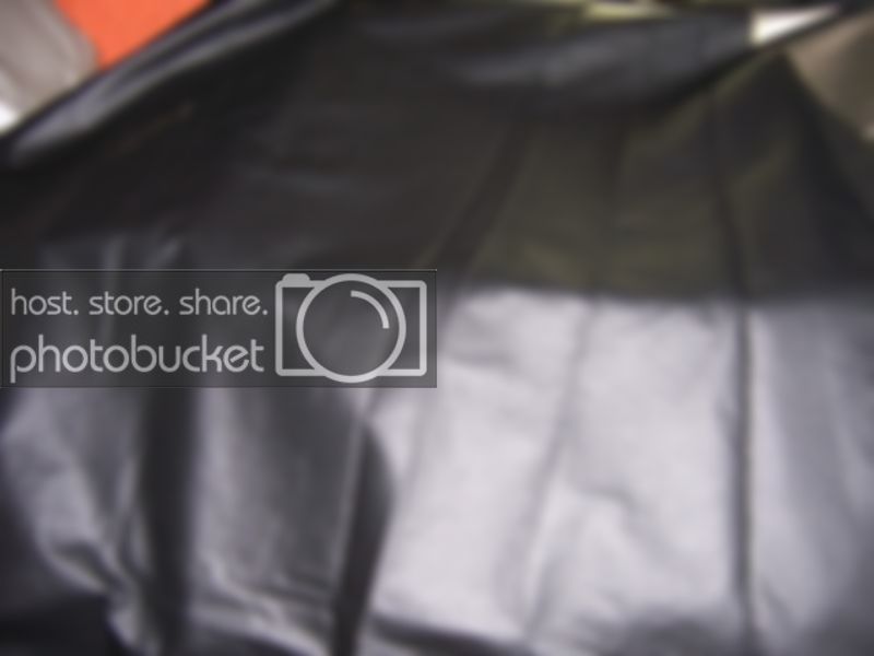

Oh yeah vinyl showed up today!
//content.invisioncic.com/y282845/emoticons/woot.gif.aaa6090e619a97b6090d16dd863c5a69.gif
Ive got lots more than I was expecting too. I think I should be able to cover a lot with what I have.
It seems like pretty good stuff, especially for the price. I was impressed by how much stretch it actually has, with a heat gun I think I should be okay covering the doors.
