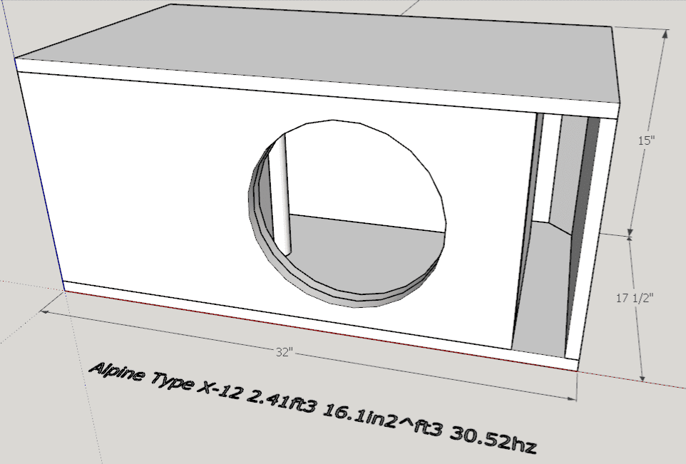

Hey everyone,
I just ordered a 12" Alpine type X 4 ohm dual voice coil subwoofer. I believe I want a vented box for a deeper tone and more reverberation, but I am unsure of what internal volume would be best or if there is an ideal amplifier to pair it to besides the $500 Alpine X amplifier.
Any advice?

What vehicle and space are you willing to sacrifice in that vehicle? I think a bigger (2.5ft3ish) volume and lower (30ish) tune would sound great IMO. But of course it'll eat up some space to slot port it, around 3.8ft3 gross is the one I'm playin' around with currently... but it looks like I'd like the response... //content.invisioncic.com/y282845/emoticons/thumbsupwink.gif.129404938effda6ad9cca39e7f4b58a3.gif

I liked the way it modeled up... strong af right where I prefer it and it still gets low.
You got an enclosure design for your application yet?

OP, the type X has been an excellent woofer for a very long time and is solid up to 1000W. Build a proper box and it'll do well for you. You are a bit limited with the whole 2 ohm final load thing, but there's probably a handful out there or you could always get a Korean 2K (Soundqubed 2200, Twisted 1.8k or similar) for probably a little less than the Alpine and it'll get you about the same place. Stay out of the total junk brands (anything Grandpa recommends) and you should do fine.
