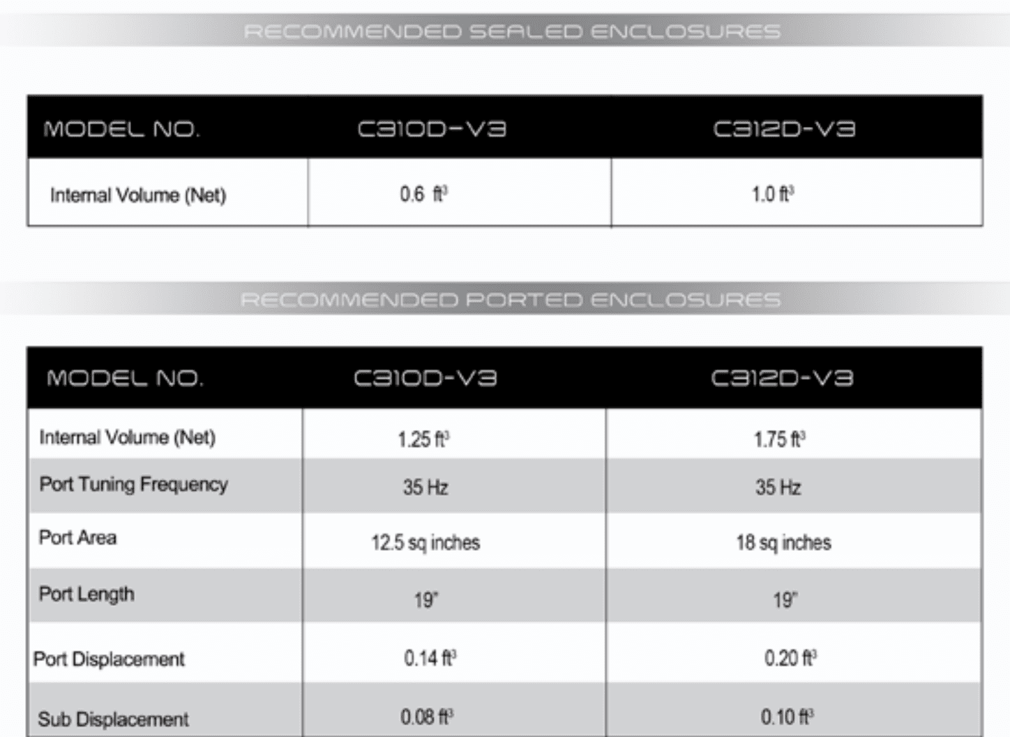

my trunk grows in size the further it gets away from the seat. once i get past the wheel wells which is about 16 inches away from the seat it's roughly 48 inches the height grows as well so i could certainly make a bigger box that isn't just a rectangle. i just have no idea based off the t/s specs how much internal volume i need or how big to make a slotted port or how long
does having 2 subs in 1 ported box make the suggested port size double?
i also found this.
would everything double in size for 2 speakers?
internal net volume 1.75cu ft to 3.5?
port area 18"sq to 36"sq?
port length 19" to 38"?
and the displacements?
i also found this.

Go with your 12s. Get a box that is 3.5-4 cubic feet tuned between 32-37 HZ. port area 42-60 inches. That will work with your 12s and also work with a ton of other popular 12s on the market. Fire to the rear and sound deaden your trunk lid if possible

right now they're in a box that is 31.5x14.5x19 outside dimensions but the port hole is only 1.5 inches wide and like 16 inches long by 13 tall. to me that is way too narrow but that's what sub box pro said to build.
i appreciate the help dude.
yeah. That probably is 3.5 cubes or so, but the port is super small. It would be tuned in the low 30s being that small, but I’m surprised you aren’t hearing really bad port chuffing and it’s not going to let even close to enough flow come out of the port. Probably 6-7 inches of port per foot of box space. That’s not going to give much bass. It needs to be at least 12 probably
