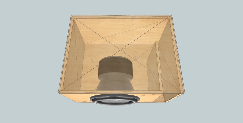

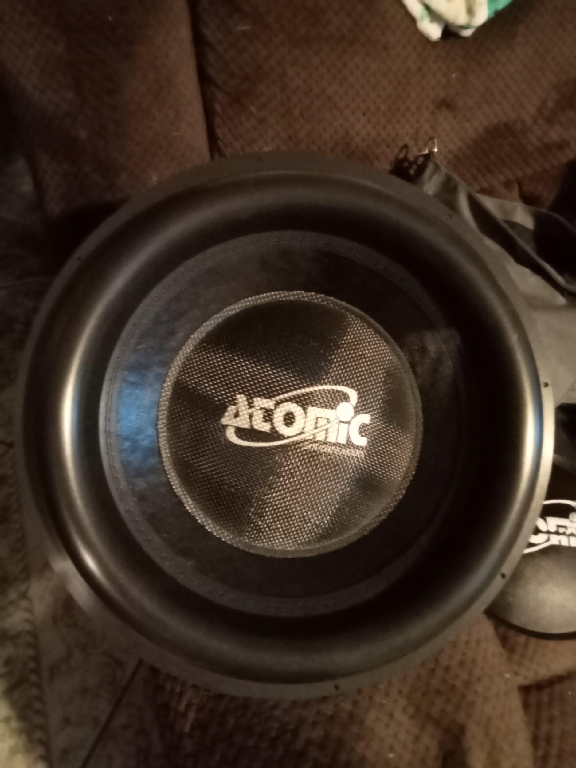

I need help making a Speaker box for 2 15s Atomic E.L.E ported i have a 1999 Dodge Durango i have plenty of room
I called atomic sent msg to jeff and nothing i have no specs at all im running blind i bought the speakers used and im putting brand new recon kits
Wow, you did this? Computer drawing and graphics. That's great. 36 hz. The box volume then matches the lower frequency hz, where the point of the graph increases, then cuts off or flattens. For this particular speaker. I see one other minor problem though. This is an old speaker. Newer cars will not make an older speaker sound good. But a older cars can definitely work on 36 hz, newer subwoofer. Car mechanic talk. It will have the power to power those subs. But yours, it may not produce low bass as intended. Frequency response may be good. But at 36 hz and at that specific box volume, output as planned desired, may not be possible. Reason speaker is already used and older. Not going to put in those performances on high output and lower bass reproduction. Just because it's already a used older speaker. May not work as planned. Hoffman's law in action. Thanks who ever gave me this. I think I was on some other name. I forgot. But three code names so far set up and changed. But google gave me this name. Nobody knows me. That is just my alias. Hopefully Mitchell Fosgate III will last. Speakers. Definitely buying one. But planning it wisely. Or it will sound like some videos I checked out on youtube. Good for the toilet bowl. Too much static. Why do they listen to that kind of music? I don't know. Just fad or just want to be like me. Set one up too. ;)
If you were to test these speakers, 4 or 2 ohms, may still be there and not burnt out. But at lower frequencies on a older speaker, it's not possible because the speaker is already warned out and already old. Whereas if it were new speaker, yes. Good deal. I'd go with the new speakers, only you'll need to pay for it. How much is one good subwoofer at 36 hz, 4 ohms and new? Any brand. Say JL Audio for example. Capable of producing the lower hz or tuning frequencies. $499 dollars for one. Money wise, you'd have to be certain you're a electronics geek or at most an electrical engineer. Otherwise if you're the average car audio guy around the corner, no way this will work out as planned. Not seeing this done.

WTF are you talking about? I would put this Atomic against any newer speaker. This is one of the best subs out there.
Read his post. Hes reconing them. So they will be new.

5.8ft3 ain't huge for a pair of 15's, comon'. A single sub but not a pair.
Op stated 2... No measurements given on available space so...
I don't have a Dodge Durango sitting in my driveway to measure.

I'd go 3.75ft3-4.25ft3 e@ and tune 32hz as there's no parameters available that I can find. 4ft3 is where most 15's shine anyways and a sub that claims 1000-10,000w is suspect in the 1st place in my book. I'd provide airspace and sufficient port area (55in2 e@) then go from there and see what happens.
Hard to say without parameters but I'll wag this one... haha

There are also other subwoofer models in that site and it seems to be a recurrent theme. All ported boxes seem exaggerated.
The box posted was for a single 15, but I agree with your general box size statements.
Yes, I think the member misread the initial post by op. I do things like that from time to time, usually I delete my response and repost a BS cover story like... Oops.
