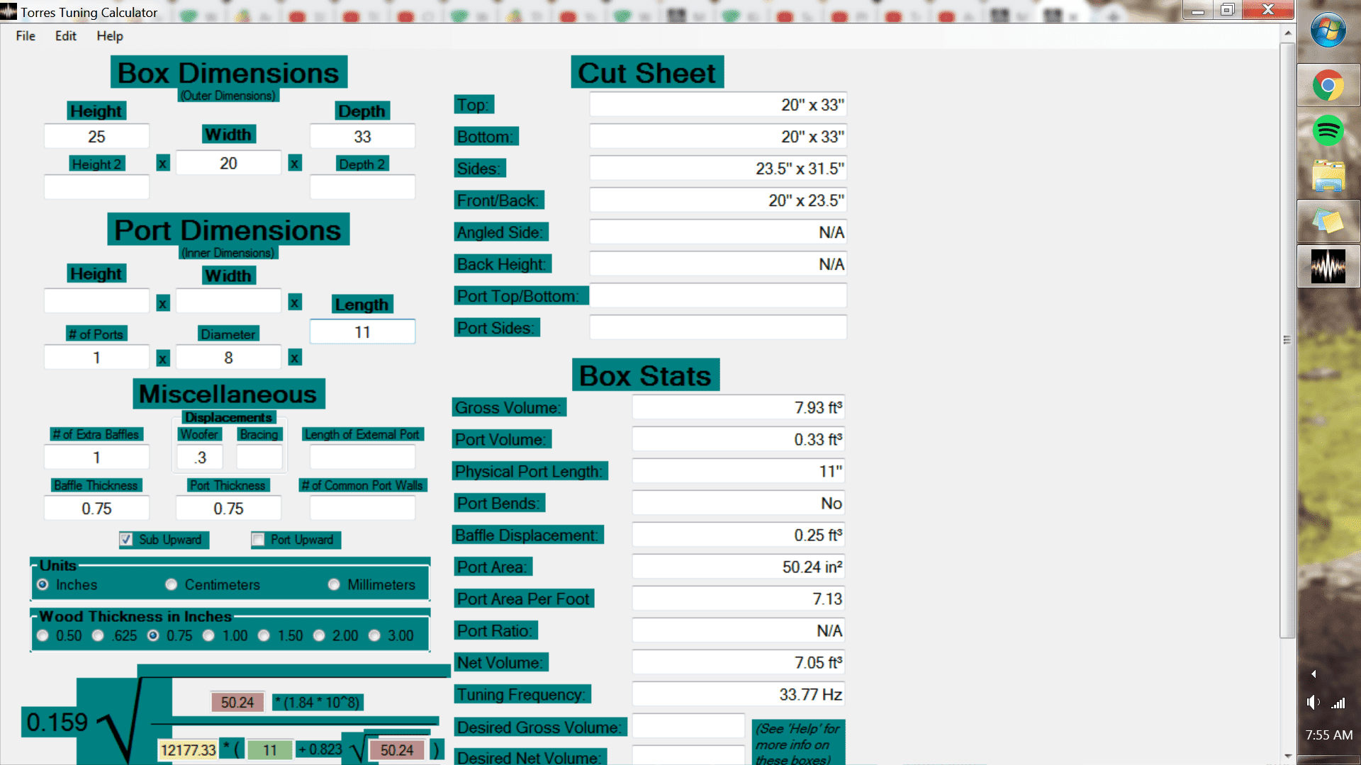

download torres box calculator, play around till you find your airspace and tuning.

There’s more to it then choosing your air space and tuning. You need to be sure the port is the right dimensions and your air velocity is right for your power. My enclosure turned out to be over a cubic foot bigger than recommended since I like to tune high for my music style. If I would’ve just went with recommended air space with a higher tuning it would be peaky
