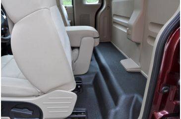

See that shelf in the floor? That's the space. It measures to about 11.5" from the back wall. For some reason, mine doesn't have that tan plastic tab. It's a carpeted flat back wall. The maximum space I have is 11"x48"x16". I'm more flexible on the 16", as in, I prefer to adjust that measurement over the 11" and 48".

you'll want the subs firing forward port to the side. You have about 3.71 cubic feet gross to work with and about 2.5 ish cubic feet to work with so two 10s or one 12. would be optimal.
