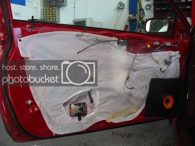

how much midbass you gettin from the 720c's? i run the same set in the kicks.
Is so-so. Love the smoothness of them though.
I need to get some sheet metal and self tapping screws and put them over top of the gigantic holes I have and then deaden over that. Once that is done, it should be right were I expect it to be.

Deck looks good, nothing wrong with the comps in most peoples eyes. Deadening is a solid job if you ask me.

That spot is horrible for tweets. That spot is bad for passives or any unsealed electrical device.
i would've just stuck those tweets in my kicks or a-pillars with mounting tape or velcro for a temp install instead of cutting a hole in my door panel.
But whatever floats your boat.

And did you miss where I have said I have done many installs like this with no problems with putting passives where they are? Of course you missed that. You read only what you want too. Gotcha!

anyhow, why do you think car come with moisture guards???
people won't be able to see your tweets in the kicks.

I'm not going to get into all this, but I have used Velcro on temp installs, and only recently actually flush mounted my L1s into my A-pillars. Before that, I had my Type-R tweeters and CDT tweeters in various positions on and off axis on Velcro for the past 2 years. The kicks were perfect because they were more hidden than your doors. Had em right under the dash. However, my mom has a 03 Focus and I know what you mean about the door panels. That being said, I would have mounted the passives behind the kicks and velcroed the tweeters to the kicks or A-pillars. Doors look good and deadened, seal up those holes, clean up the amp rack and get that box in there and you'll be good to go. I like this build because I like the car; has nothing to do with bigbang because I don't know him really.

Also about the moisture guards, that is all good.......yet, I still have yet to pull out any passive crossover with any problems or looks or wear or tear on the crossover. //content.invisioncic.com/y282845/emoticons/rolleyes.gif.c1fef805e9d1464d377451cd5bc18bfb.gif Again comprehension pwns you!

Honestly never thought about velcro on the tweets and tweeter placement. I have had other cars with tweets in the sail panels and been in cars with them in the A-Pillar and I honestly can't tell a huge difference in how they sound.
Also I didn't feel like having to spend a bunch of time running new wires to my doors, so that is why I have the crossover in there like that, which is usually my excuse on other installs, lol! Maybe one day I will do that, but for now it is fine. I have also already mentioned how this is tempory with the amp rack and what not and how I am going to deaden the holes with some sheet metal and self tapping screws. Will do that pretty soon.
