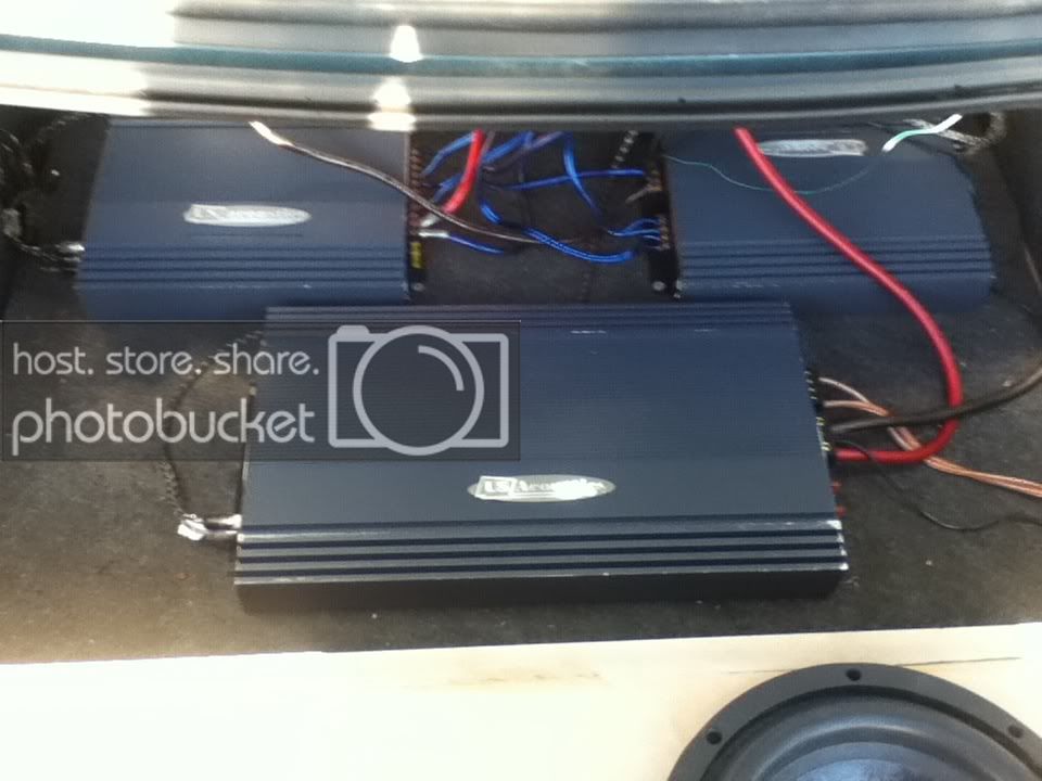

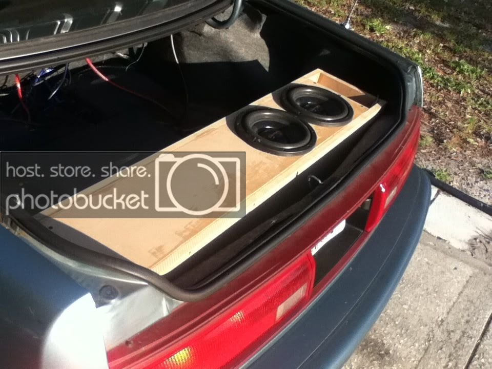

Sub placement was rear firing in these videos , i have since changed it to up firing , now its a bit louder and sounds better too.

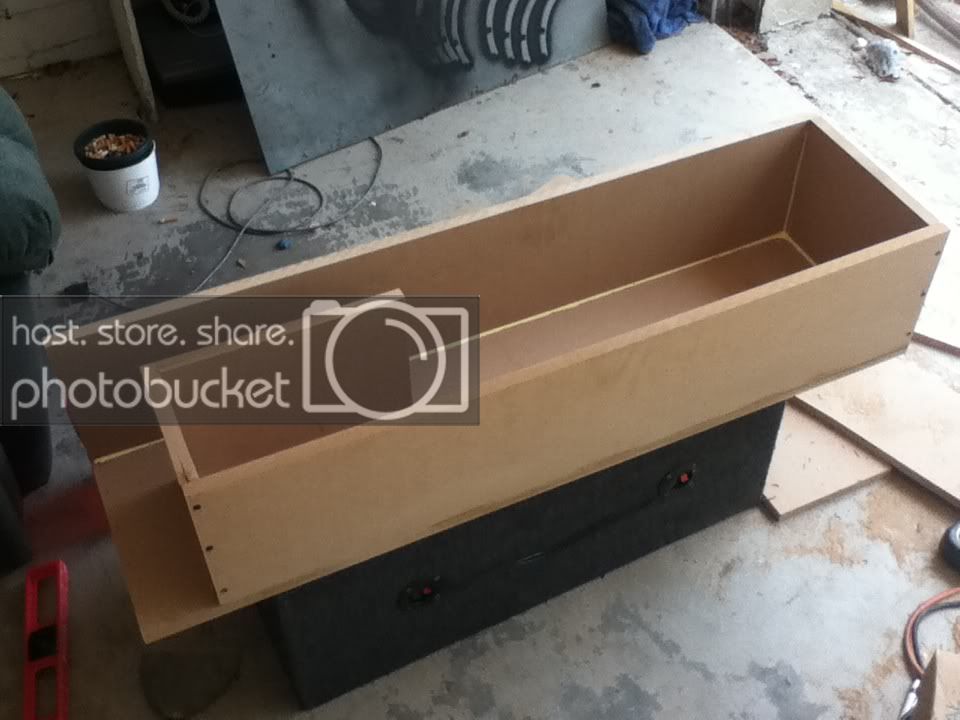

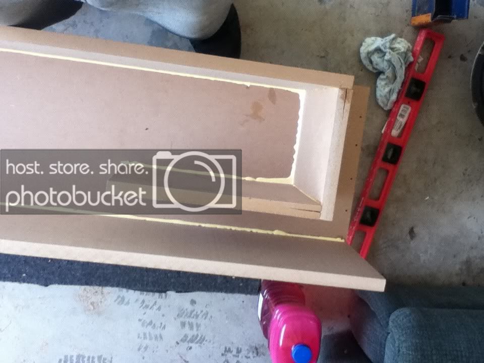

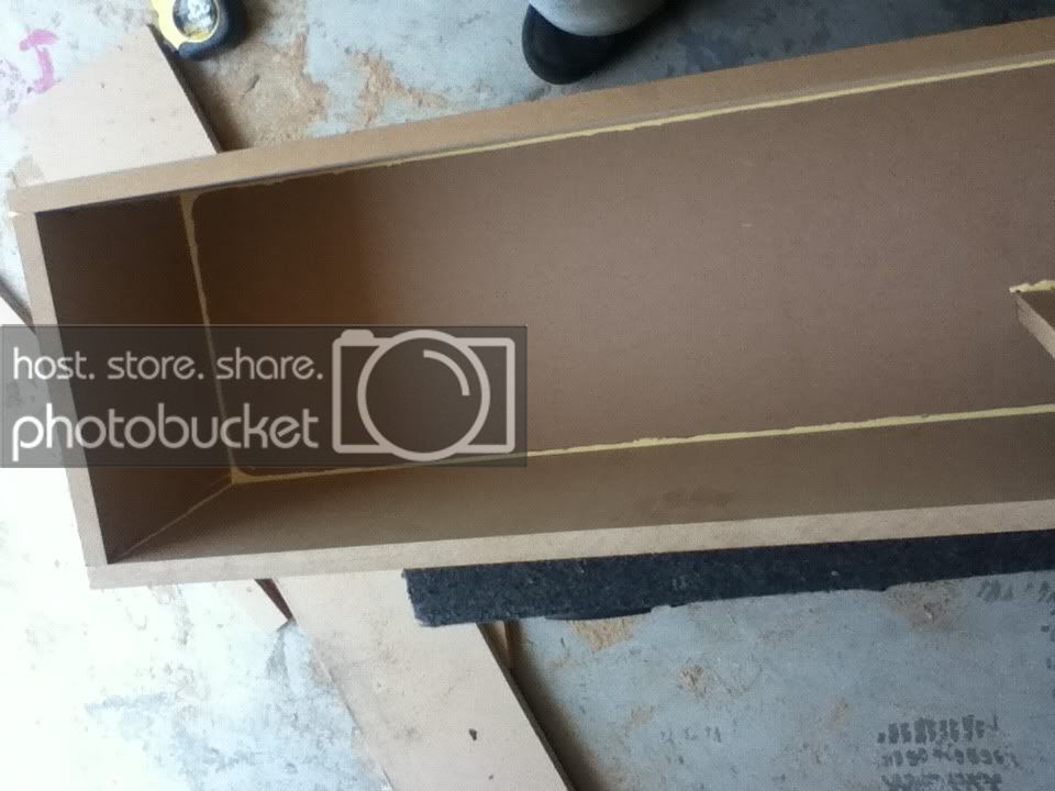

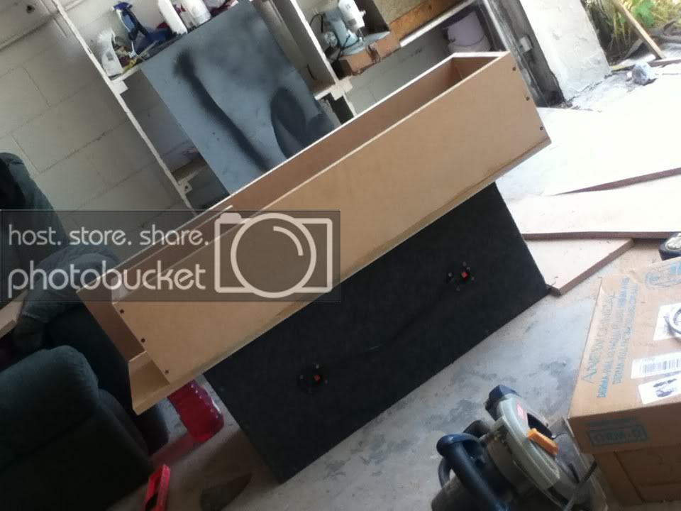

I would be more than happy to help you build a new box for them If you like. Same air space but IMO I would tune to 40ish hz this time.
At 40 hz, you should be able to get down to the lower 30's with out loading issues and should get you what your looking for.
I have a 1/4 sheet of MDF here so one more and we should be good.
