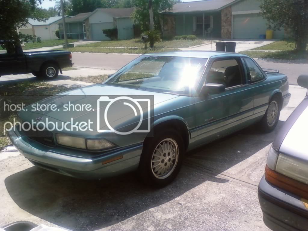

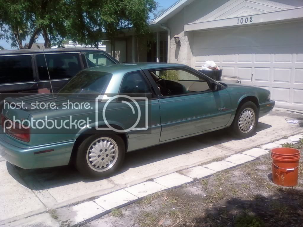

1995 Buick Regal Gransport , Series 2 3800 V6 , Automatic.

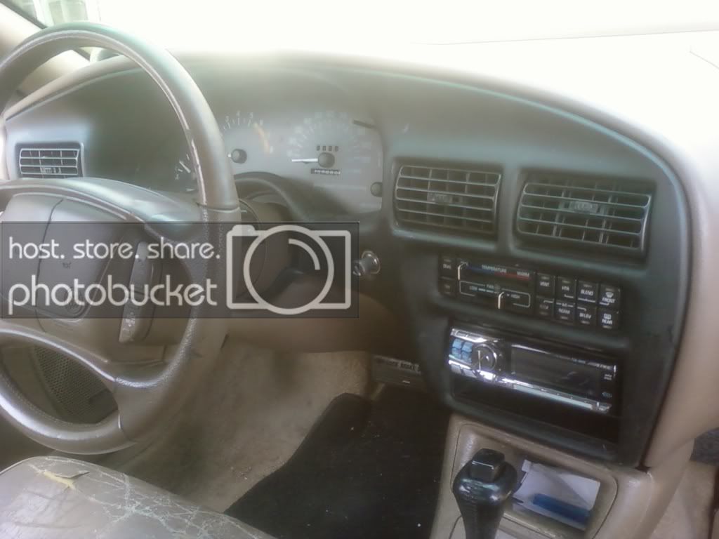

Deck: Alpine CDA-9855 (Running Active 3 Way and Time Aligned For The Driver Seat)

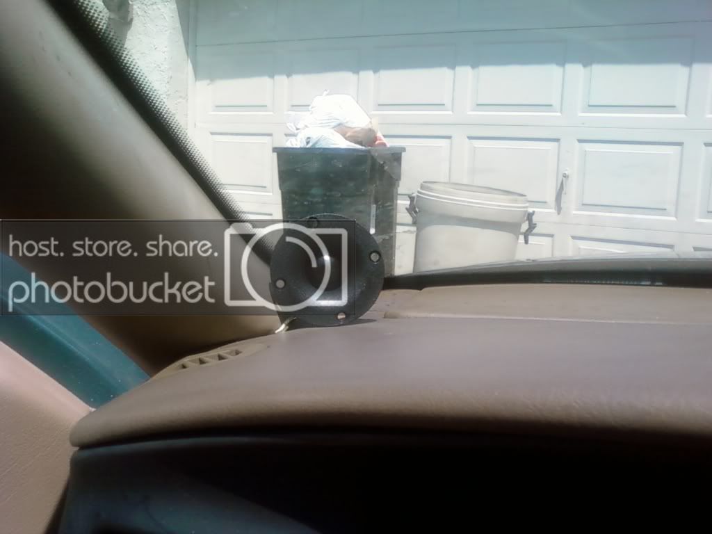

Tweeter Amp: UsAcoustics USX-2100

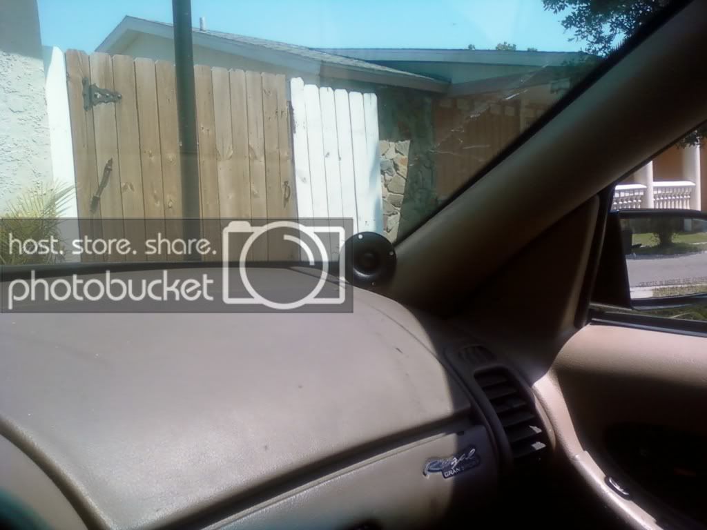

Tweeters: Vifa BC25 Neo's

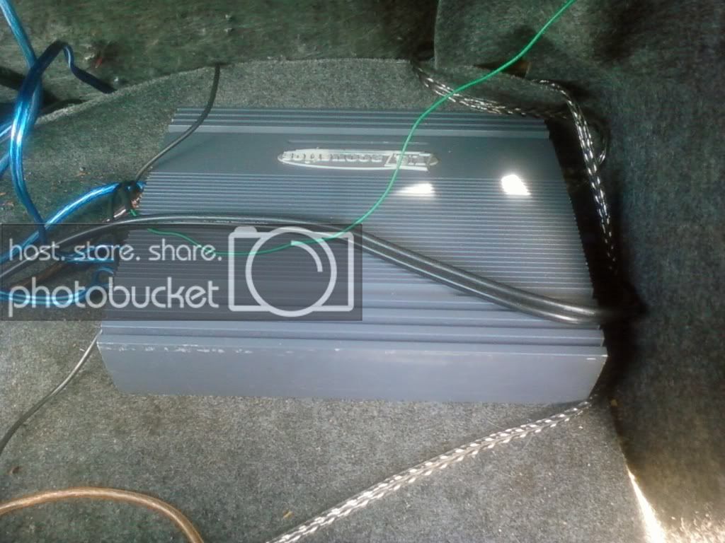

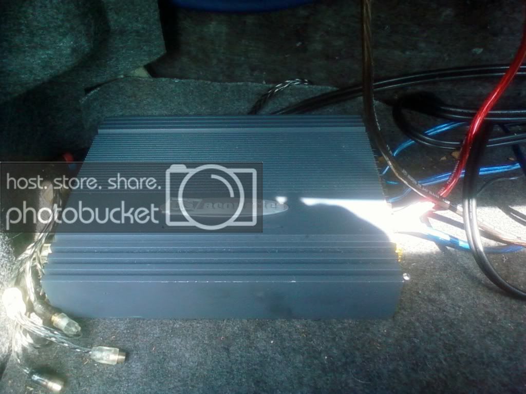

Midrange Amp: UsAcoustics USX-4065
Midranges: JBL GTO 5.25"

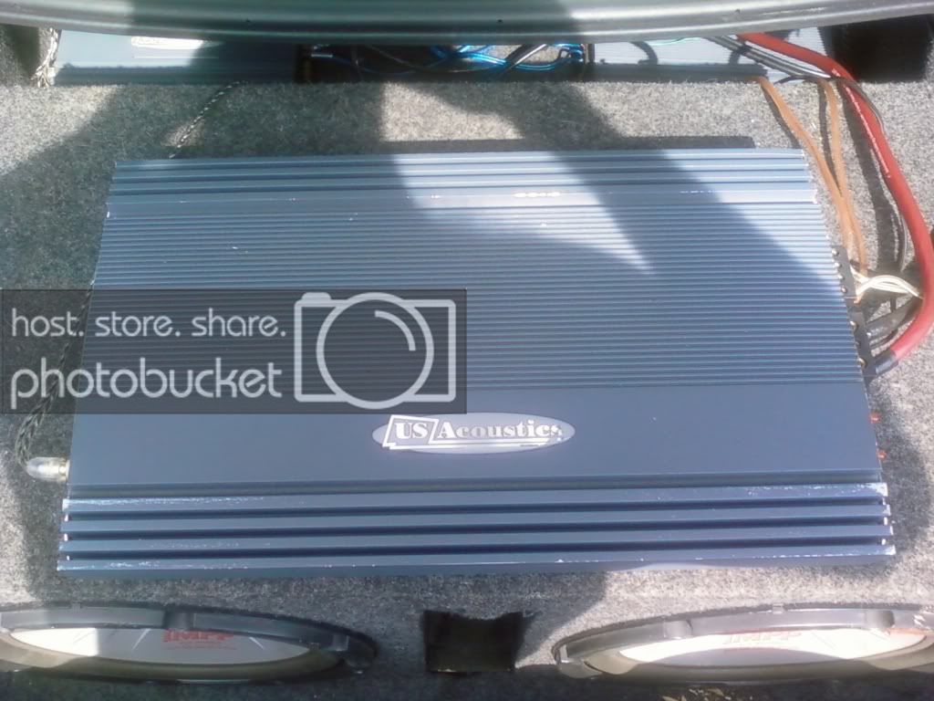

Subwoofer Amp: UsAcoustics USX-800F

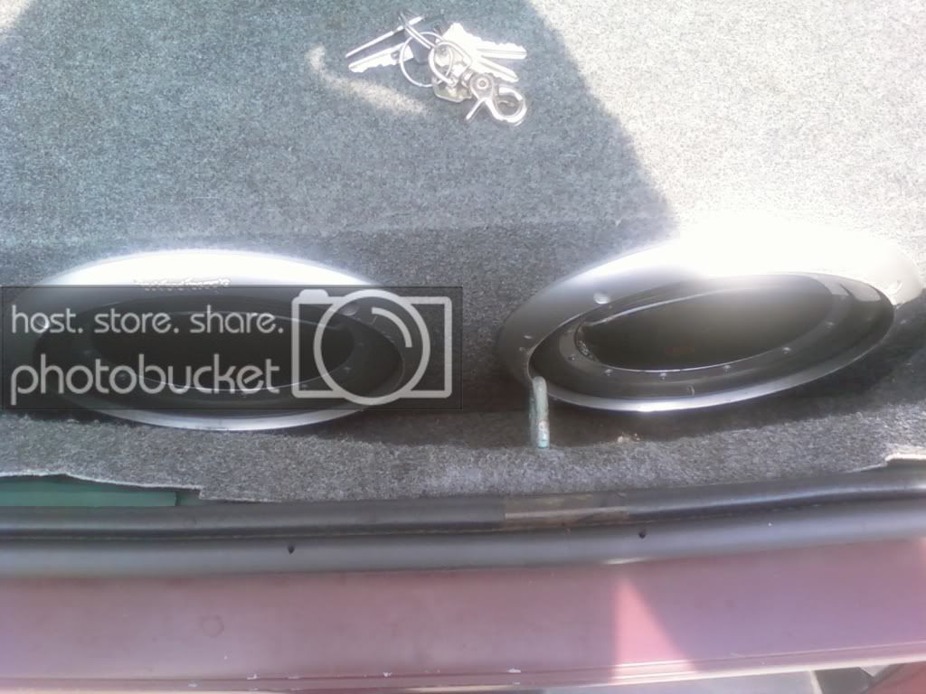

Subwoofers: LMAO!!!! Its 2 Pioneer 12's Held Together With JB Weld And 2 RF P1 10's

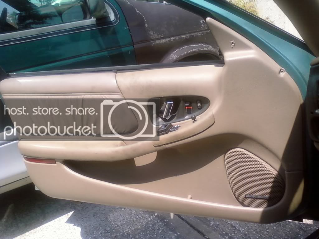

Here is some pics of the ride
Now remember , this is not final build by any means. I plan on doing pods on the a pillars for some nicer tweets , pods in the doors for some nice 8" midbasses , and in the trunk i plan on doing a false floor amp rack with a single 15 ported. Right now the amps are behind and on top of the terrible subs. Eventually when money permits i will finish this project , but for right now it actually sounds pretty decent. Will sound 10 times better when i get some respectable speakers in there.

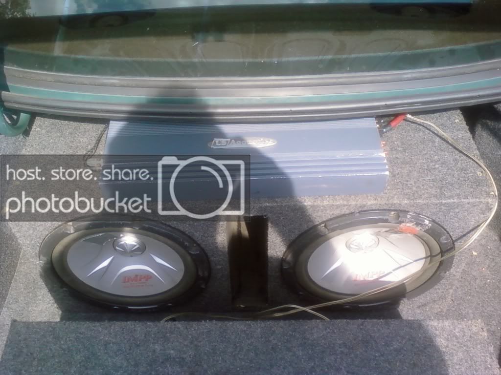

I'm using all 4 at this moment. But its only a temp thing , i plan on putting a nice SQ oriented 15 in there. Maybe a dayton HF or a mach 5. Don't really know yet. I don't have the money so i'm not sweating it. the only reason i put all 4 subs in there is because a pair sound terrible and i get too happy with the volume and eventually i'm gonna **** them up and they are my buddies. He is storing them in my garage. LOL
yup , different sizes and brands and type of box too. LOL. I got no real deal subs at all right now, and 4 ****** subs is WAY better than no subs at all. //content.invisioncic.com/y282845/emoticons/smile.gif.1ebc41e1811405b213edfc4622c41e27.gif
The main reason is the amp makes 300+x2 @ 4 ohms , and 800+ Bridged. So if i run all four i run less of a chance of getting crazy with the knob and hurting the speakers. They can't handle this amp as it is but even with gains all the way down , and a pair on it , i was running the risk of hurting my buddies subs. They seem to be ok running like this at low gains though. And its only temporary , i do not plan on keeping this crap in my trunk. Or the speakers inside for that matter. Only thing staying in this build is the electrical , the deck , and the amps.
