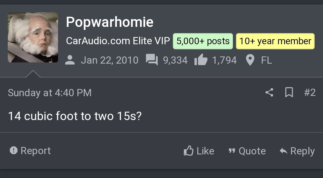

Some dude you know drops 30,000$ into equipment into some 4th order and breaks 160dB and now you're convinced that 4th order bandpass is why he's that loud and that 4th order is the silver bullet for anybody to get loud. You come right out the gate telling OP that 14 cube for a pair of 15s is too large when you have never seen his subs, never looked at specs of manufacturer recommendations, nor build a large box yourself. Then you give port advice when it is likely you have never built a box and tested several different ports for comparison, nor read the Salvatti white papers which is the definitive resource on port design.

Who broke 160 in a fourth order? The guys I know who broke 160 have done it in a sixth order. I've looked at a lot of different 15" subs and have yet to see one call for 7 cubes ported, have you? The biggest that I can think of is a Kicker L7 15" that like a big box around 6 cubes. I still stand by a 4th order blow through with 3- 15's. I also stand by what I said about changing the amp(s).
You come right out the gate telling OP that 14 cube for a pair of 15s is too large when you have never seen his subs, never looked at specs.
I think Pop came right out of the gate questioning 14 cubes for 2- 15's, not me. Do you really think those Rockford subs call for 7 cubes each? Why didn't you call Pop out? I think that I was the third or fourth person to question all of the cubes. 3- 15's in a fourth is his best bet. And, change the amps. Kiss my azz!

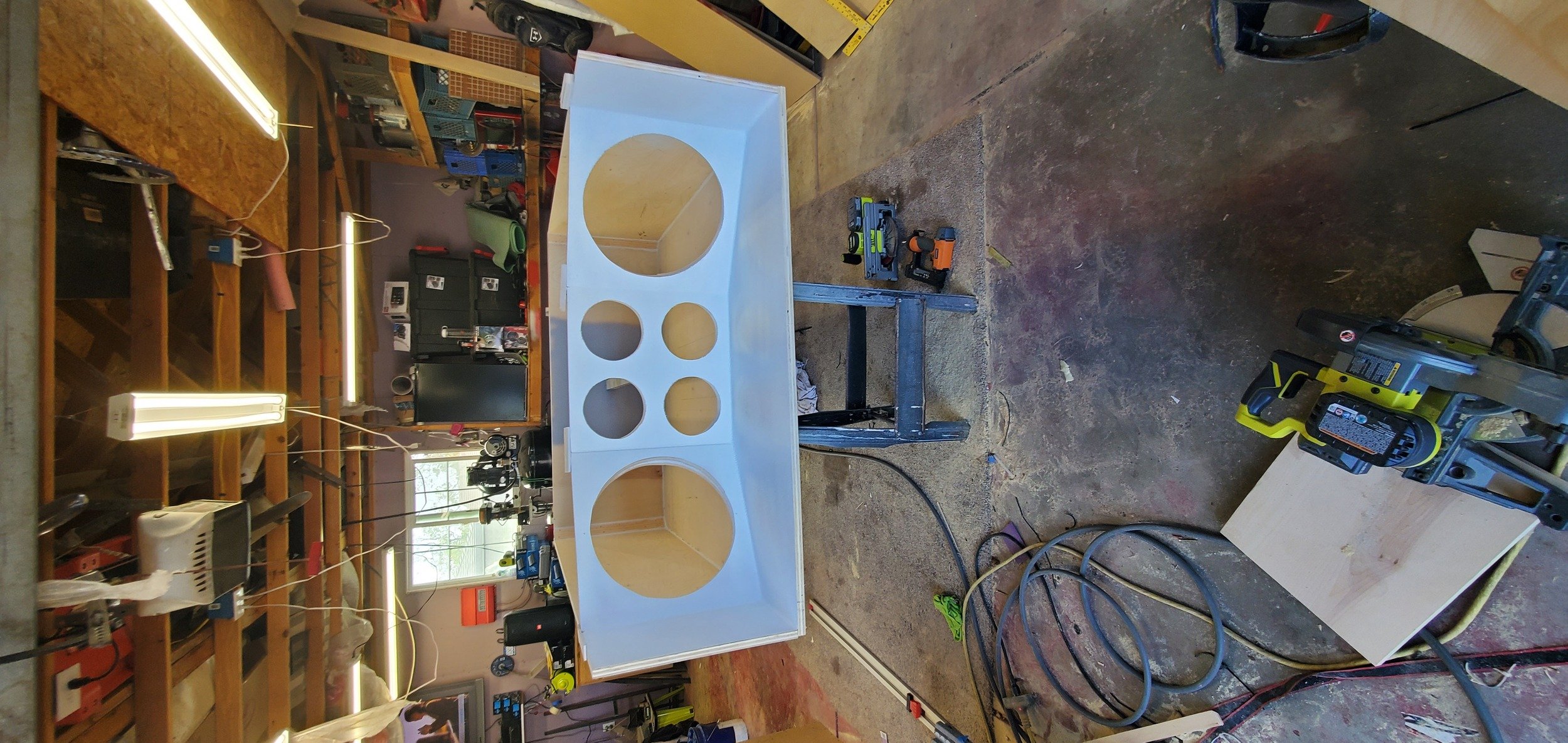

Whoa, that will be one skinny port. The width of the back wall ports will be 1.08" wide (27.5mm), but the front port will be shared by 2 subs so...
