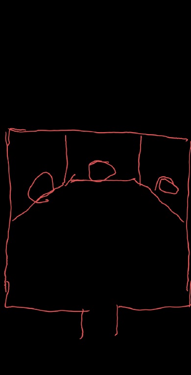

I don't have dimensions, but I think the shape should be something like this. Sorry, for the rough drawing. I'm drawing with my finger on a phone. I'll get OP a design. The problem is, I think that he cut open the whole cab of his truck.

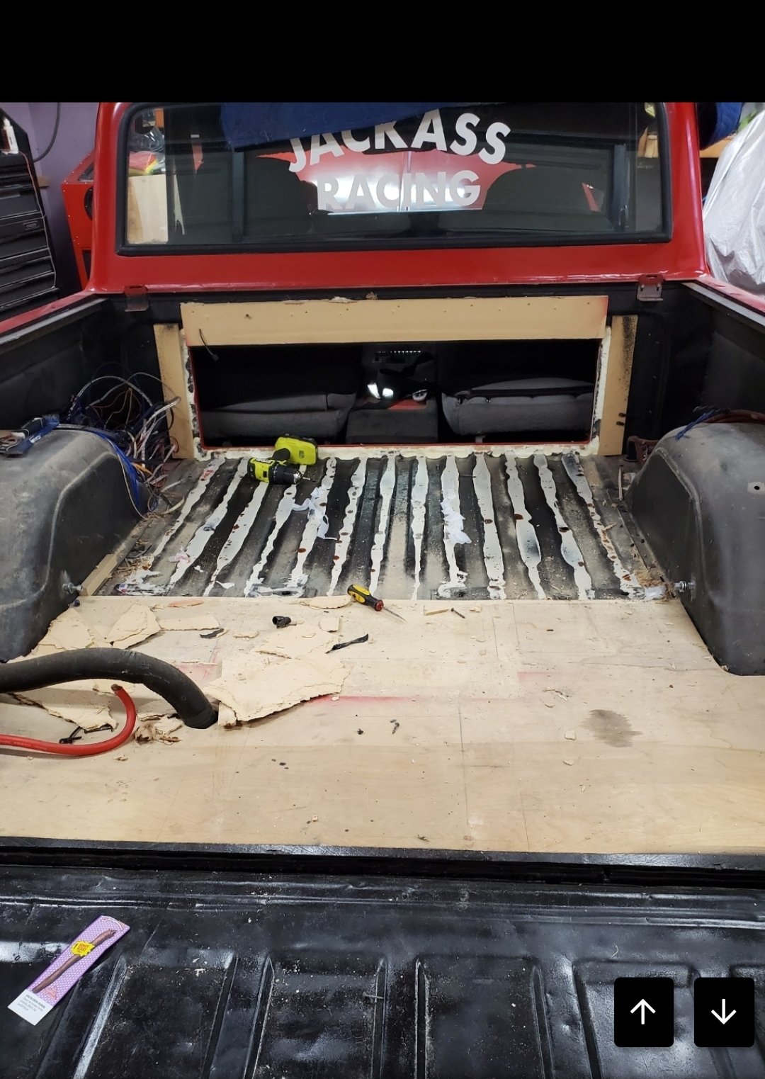

I think the biggest problem I having is that I'm super limited to space...only have 54 inches deep 17 tall and 48 with...I just don't have the space for the 4 I wanted to run...
I think 13.5 cubes would work. Each sub in 1.5 sealed (4.5) and 9 cubes unsealed. But, I think you cut out too much of your cab.
I dont think the port will be THAT big so do some fabrication. By the looks of that bed you'll get away without a boot too. Id worry about that back window as much as its cutout myself. Maybe reinforce the back cabin wall some?
He needs to glue and screw a piece of ¾" MDF or Birch to seal that cab up and start over. He has a tonneau cover, but it would be smart to rhino line the box. How did you like the layout of my box drawing? He should probably use 1" material.
My last box was 7 cf per woofer with a slotted port almost blew the front window out...I've always put my woofers in bigger boxes and have never had a problem. Trial and error if it doesn't work I will build a new box...its just my hobby

A single port would have been more efficient than 4 smaller ones, and it looks to me like you will only around 100 square inches of port area which may not be adequate for your cone area.
You will want to add a lot of bracing all around in that box.

It's all double walled with 3/4 birch..but I plan on adding more

You will still want to brace all those large panels and probably one on the baffle between the 4 ports. 1.5" plywood will flex more than you expect when you get into really large panels.
Already on it boss thanks for the advice tho appreciate it
