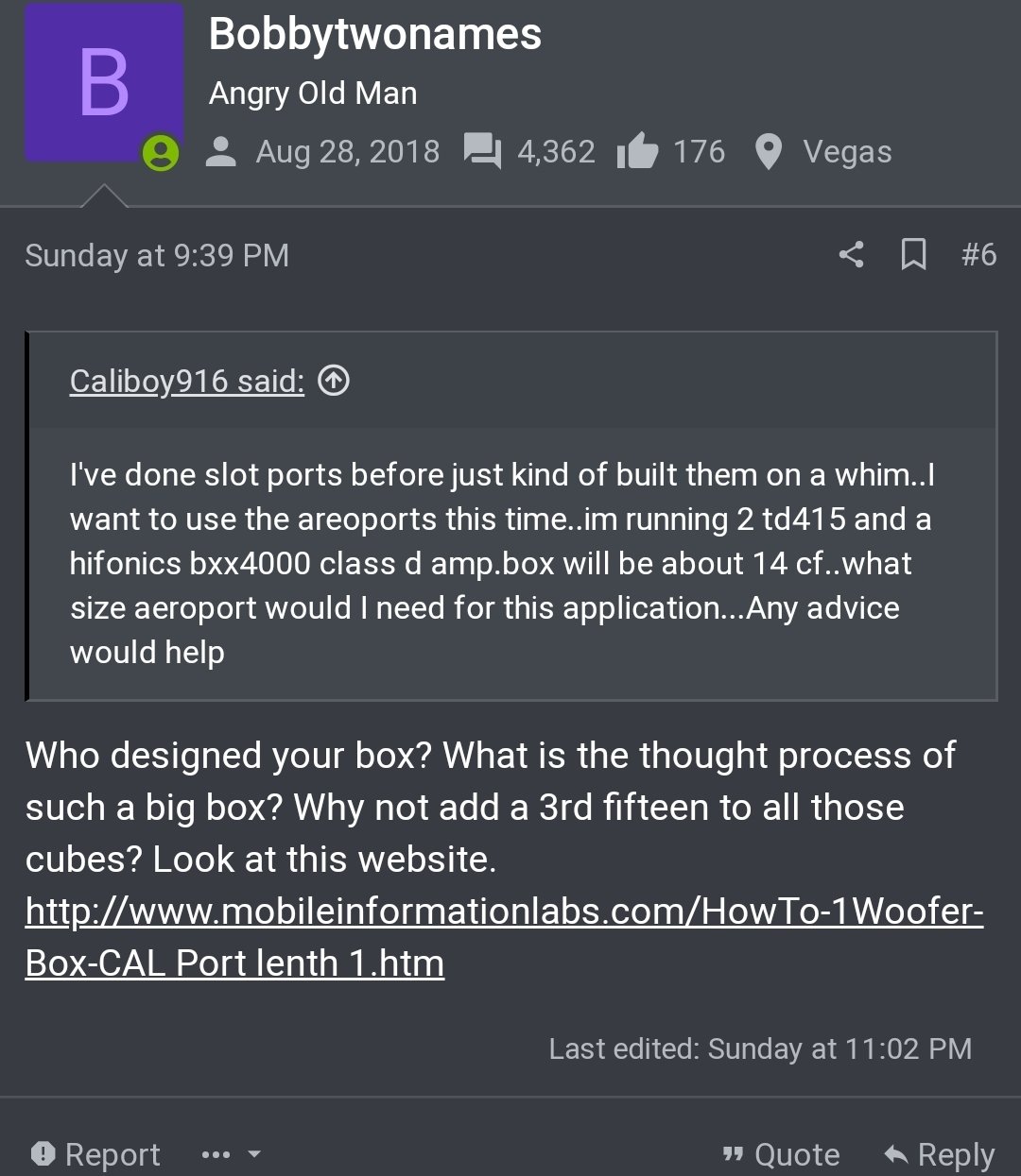

Because he has significantly more experience and just asked the question. And a valid question since that is on the high side and can get into mechanical trouble. You'll notice OP tried less airspace, wasn't happy and was happy with them in 6 cube each. All things being equal he will gain output and efficiency going up to 7 cube provided he isn't at the mechanical limits of his subs.
Build more boxes, test every variable you can think of, buy a meter and take measurements, lurk more.

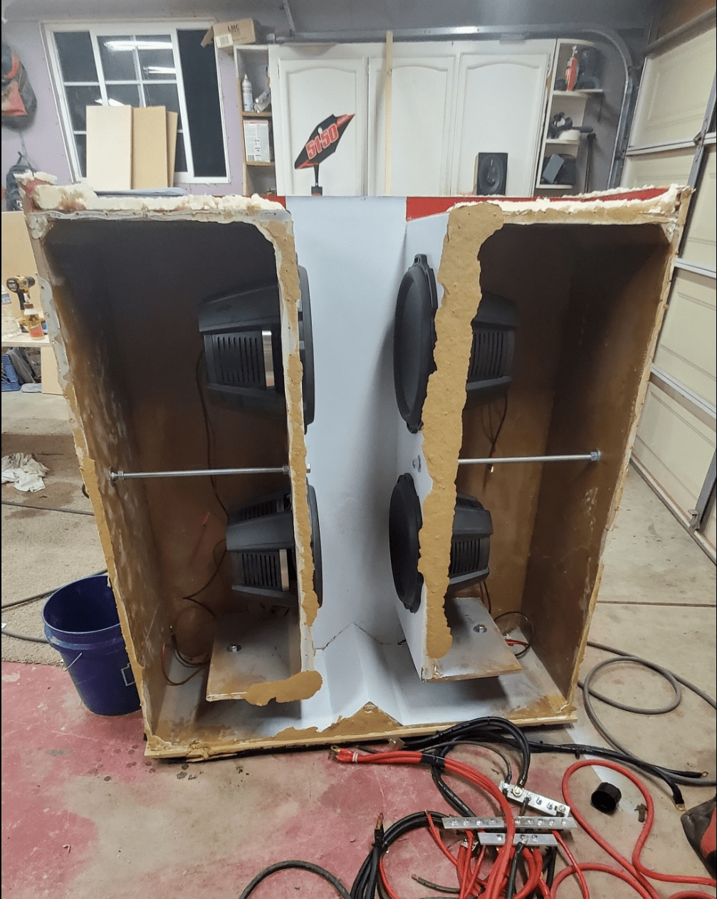

My last box was 7 cf per woofer with a slotted port almost blew the front window out...I've always put my woofers in bigger boxes and have never had a problem. Trial and error if it doesn't work I will build a new box...its just my hobby

Good luck with that fart box. Either output limited with 50in2 if port or oversized till its tapping + port limits, Either way its yours. And Bobbyjackass's.
2 15s is bad enough... 4 15s just no.

That thing had to be limiting output/maybe chuffing and def cancelling all the way to an epic fail... but ok.

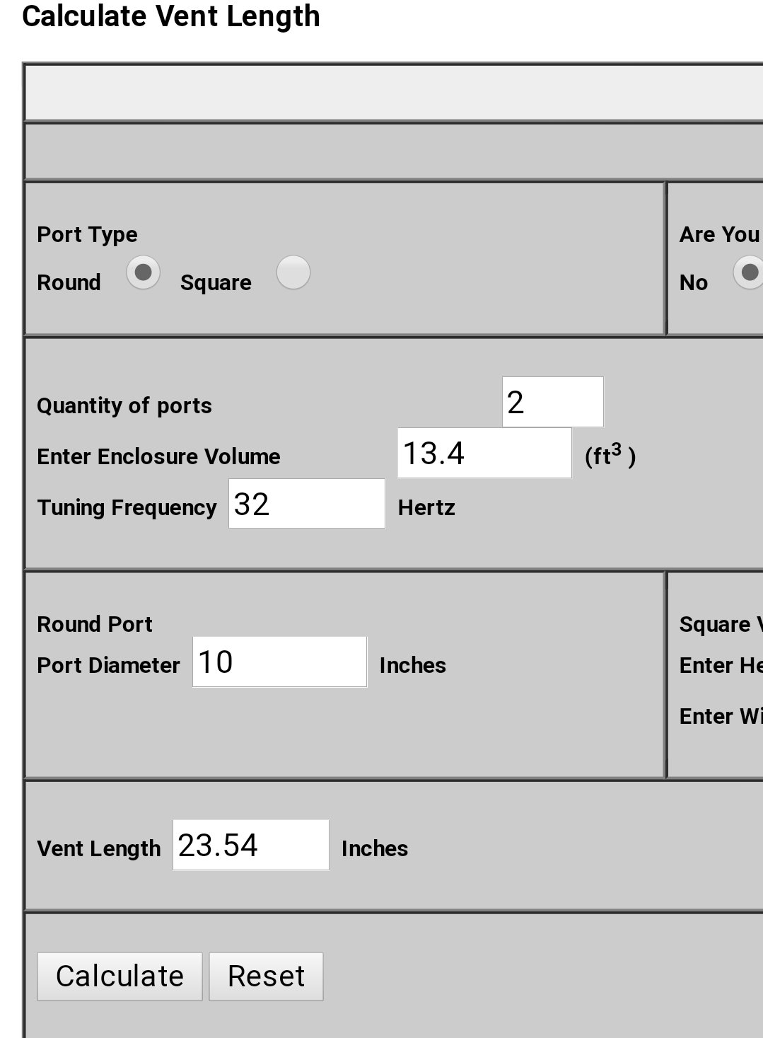

Hey man, honestly, why wouldn't this aeroport setup work? I'm trying to learn this **** the best that I can. We were installing until 5:30 this morning on a car that had to get done. I figured that 2-10" ports would give him just under 12 in2 per cube. Is that bad?
Whoa, that will be one skinny port. The width of the back wall ports will be 1.08" wide (27.5mm), but the front port will be shared by 2 subs so...
