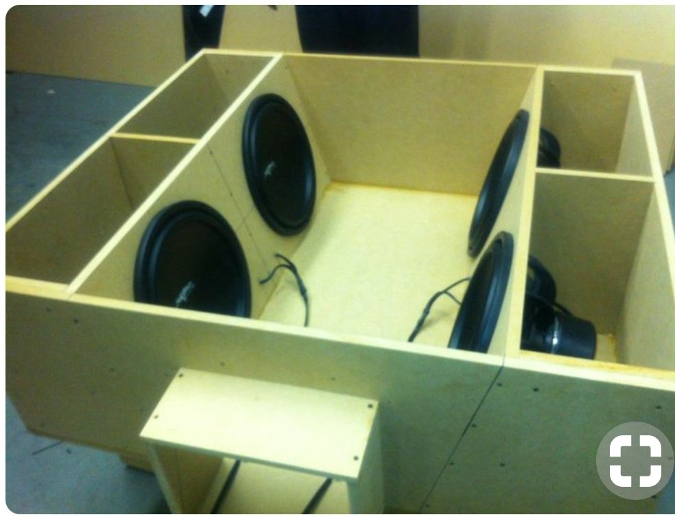

My opening is smaller then my box that's why this build has been a lil challenging...let me see if I can find a pic of my old box
Something like this is probably what you need.
I seen that was wondering the dimensions of a box like that
I'm no box guru. You should hit up @Buck or @shredder2
They are both geniuses in all aspects of box building. That box with the 15's facing each other doesn't make sense to me. It looks like they would be blocking the port when they were playing. A four 15" 4th order blow through would probably tear your truck up. But, you might need a 8K or 10K to properly power them. And, your electrical would have to be on point as well.
