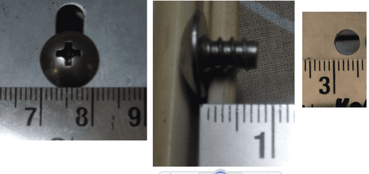

Hi All,
Anyhow I finally had an opportunity to remove my current Pioneer HU. The screw that came with it measures about 11mm in diameter. 8mm in threading depth and the hole on the mounting cage is about 5.5mm wide.
Here's a photo. Just in case anyone is interested!
