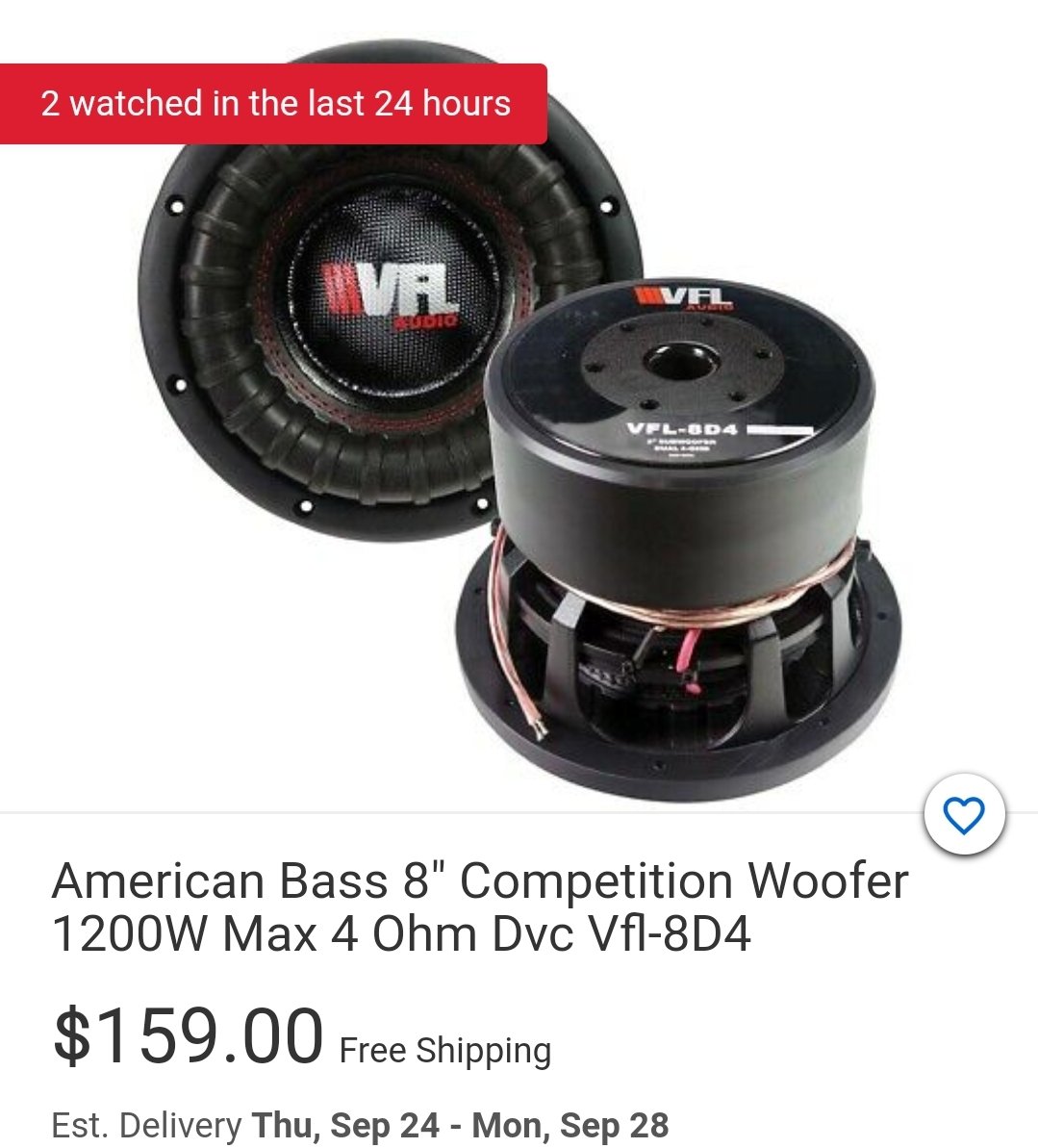

Look at the AB VFL8's. They can really get down. They are also rated for 600 rms. each.
