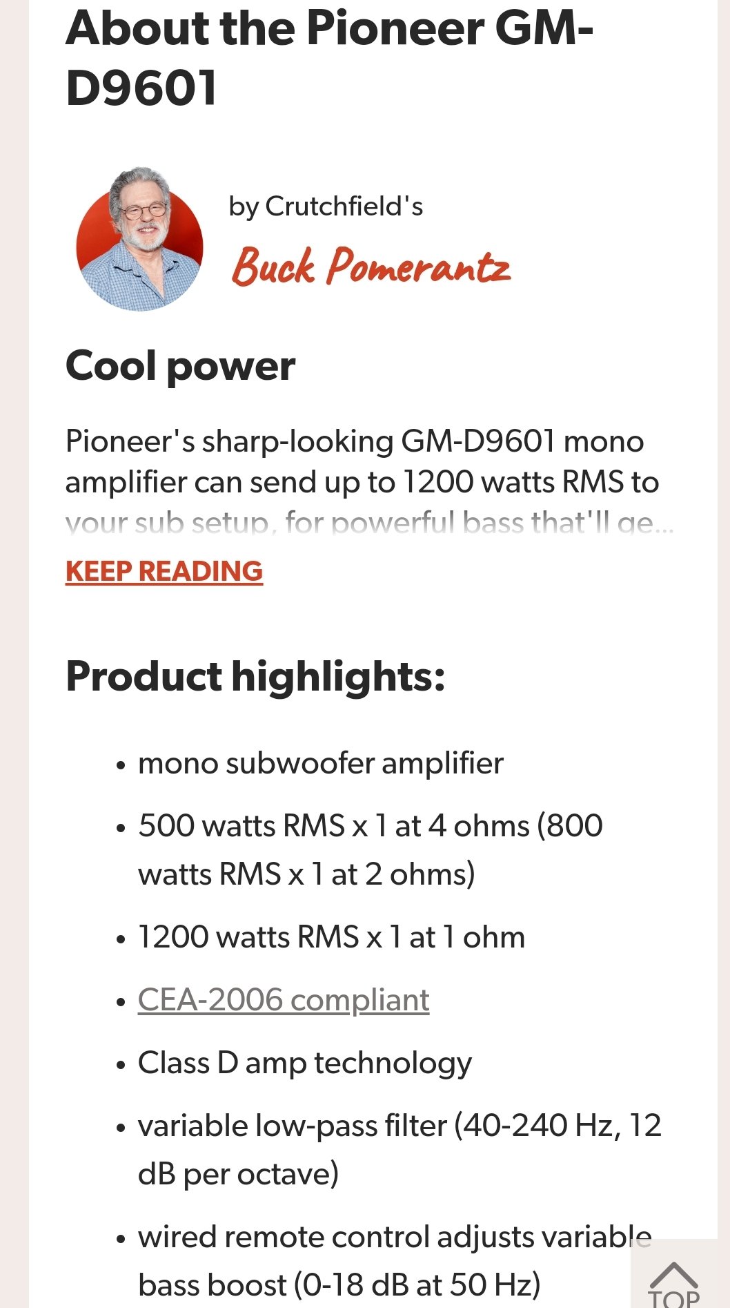

2- Type S 10's. Cone area is king. Make sure to get the dual 4 ohm voice coils. You will always have the option to upgrade the power if you want more. Something like this if you want more power. Or, a Taramps MD1800.
