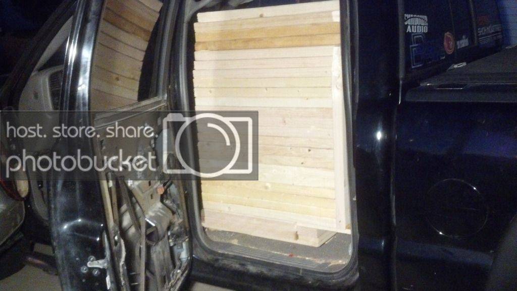

Lookin pretty good. Doubled up inner walls or just single with a thick baffle? Whats the plan for bracing inside the box?
You figure he'll need bracing with that shell and double layer 3/4?

I got the driver's side done today. I'm happy with how it turned out. wood at the top is the same length as the ones in the middle, but they're tapered inwards because of the window. That's why they look shorter from this angle
Looks very solid!
Sides will just be single layer of 2x4's, which is really solid. Back wall is two layers of birch and one of 2x4's. Bottom is just going to be two layers of birch, but it's covered with 1/4 inch of resin and cracking the resin with a hammer was hard to do when disassembling the last box. Top will be a layer of 2x4 and birch. Front will be two layers of birch and one of 2x4. Internal bracing will be 1" threaded pipe and more 2x4's.

I have only used 16 out of the 50 2x4's I bought and both sides are done. I'm not going to run out. Definitely easier to use 2x4's than a bunch of plywood layers, and cheaper too.

I have a crew cab. 4 full doors. You have an extended cab. I've got like a foot and a half more depth than you

How do you put all the 2x4 together? Glue and clamp them all or lay each one and put screws then add another one and screw? Just curious.

Glue then screw each one
