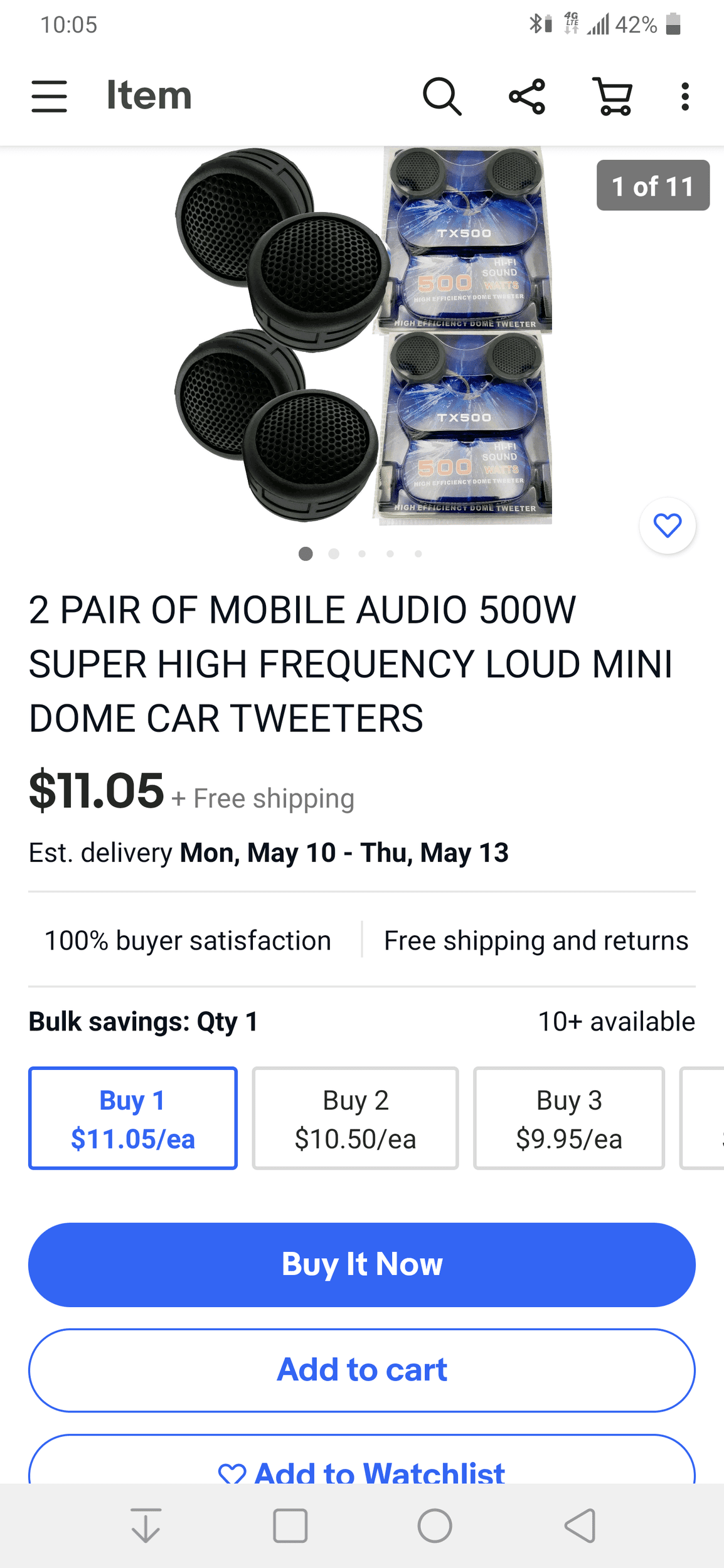

Well, after adding a small sub system on a few exe's cars, that was the first thing they pointed out. To overcome the lack of sibilance, I would add a set of $5 tweeters on the sails. The details produced by these is quite pleasing. Now, these were added to stock systems, I think amplifying them would make them harsh.

So you’re suggesting adding a couple of small aftermarket tweeters that are better than oEM, not amplified just connected to factory head unit?

Yes. They do look cheap, but the black ones much less.
I use the hole saw, pop them in from behind, voila. They look oem. They have different mounting options as well.

I’ve been thinking about your response and have a question... how are some non-amplified $11 tweeters going to be any better than the stock speakers that come with a new vehicle?
It is not that they are better, but that they have a higher sensitivity (95-105 decibels). Whereas the OEMs I think have a sensitivity of maybe 89 decibels. They are not conventional tweeters (no magnet or voice coil). They are a metal disc with who knows what inside, that vibrate when powered. You have seen these in musical B-day cards. They just glue a cone to those, house them, voila. Piezoelectric tweeters. These are not replacement as much as a compliment to the existing tweeters.
I see, that makes sense
