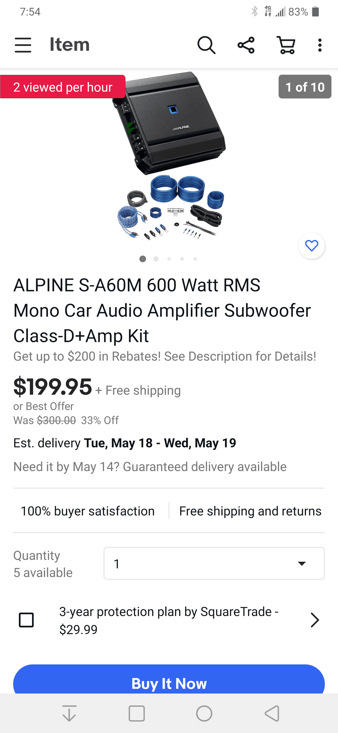

The alpine s-a60m was on my list, was even asking crutchfield rep about it, but in the end they recommended the pioneer. I assumed the alpine was much less powerful based on the rms ratings and assumed it would not push the subs as well. I admittedly do not know much , especially when it comes to all the technical specs and ratings about wattage and ohms and impedence. Too confusing.

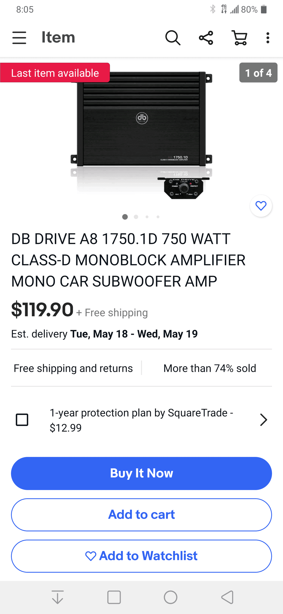

This is true, but 600 watts RMS is pretty powerful. 600 will push both subs quite hard and not overtax your electrical. The amp I had before, was the db drive a8 that I posted above. It does 600@ 2ohms. I left it as long as I could, so I could show a nephew that he did not need the 1800 watts amp that a local shop was pushing on him. He went with a 500rms plus low power subs and he could not be happier. Plus I do not think that todays Alpine is one to exaggerate their output numbers.
