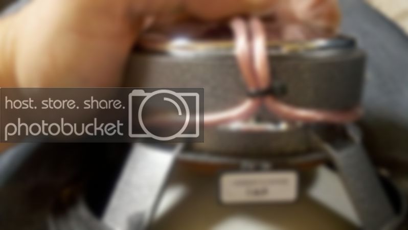

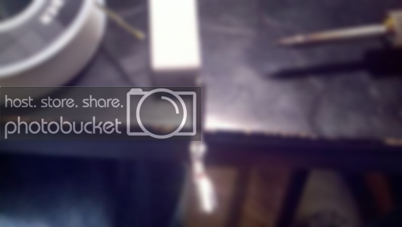

Getting resistors ready to easily snap into place for the ambient tweets.
Now how does that work?
Rather than cutting a hole into the dash for a center channel, I am creating a solid stage using an ambient stage setup. Theses resistors will "quiet" down the ambient tweets to the point to witch they are are more of a fill for that 3-4.5 freq fill that is tough to achieve in sq.

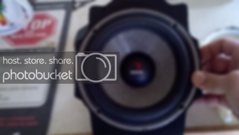

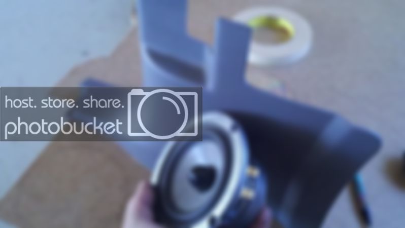

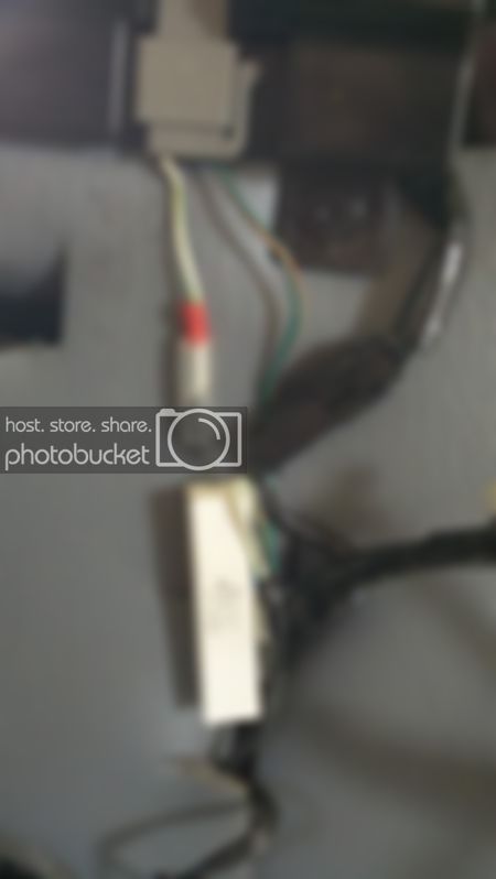

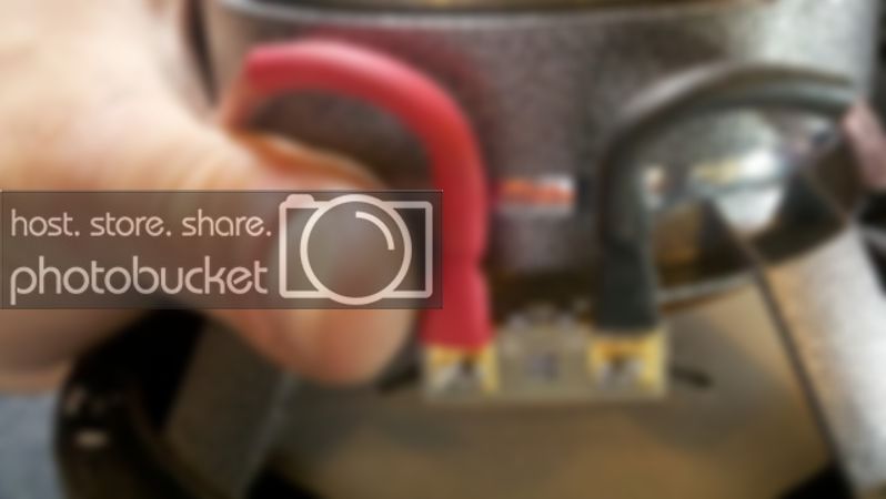

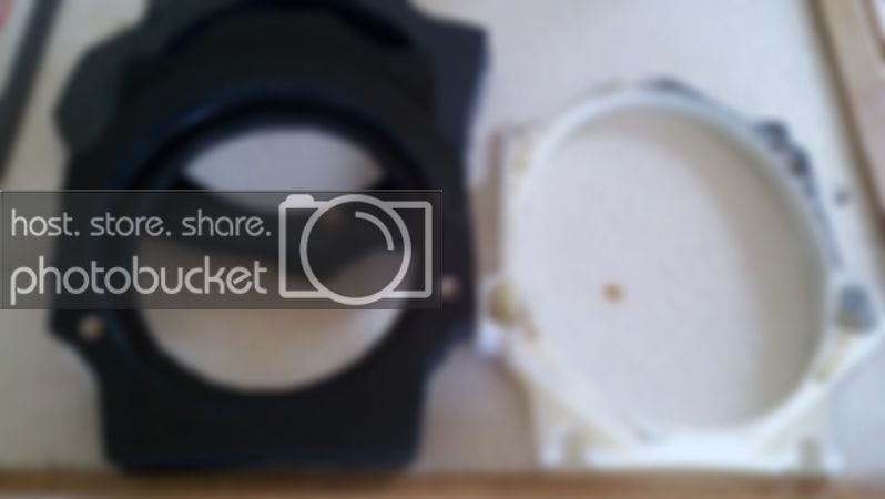

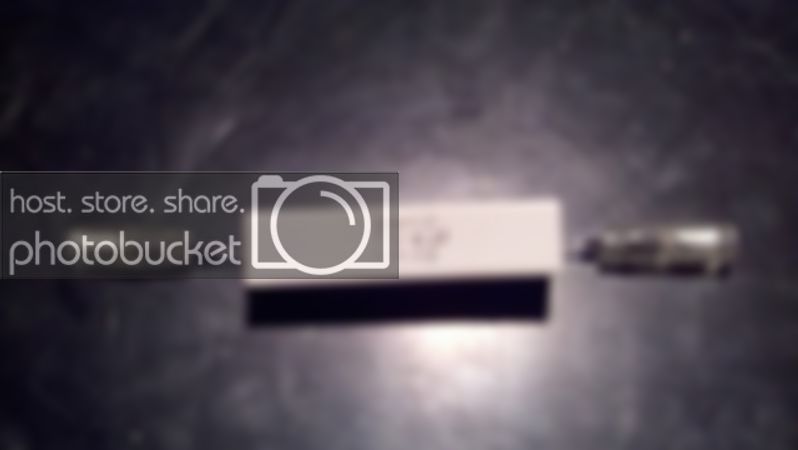

Made some tighter fitting mounts for the 6.5" woofers, ran some better wire (11 awg Ixos twisted) and installed the 8 ohm sandstone resistors.
New next to Old:

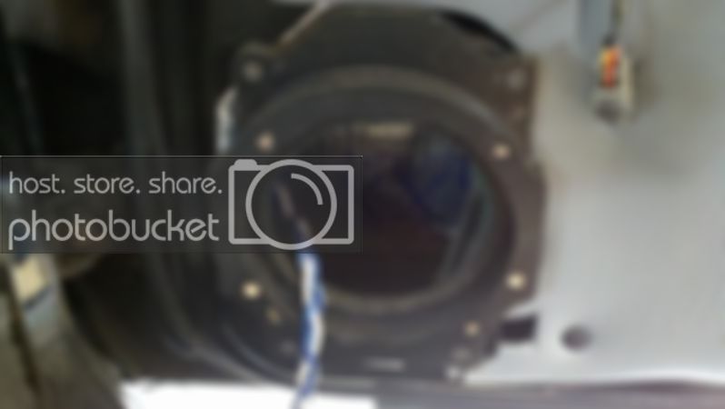

Nice fitment:

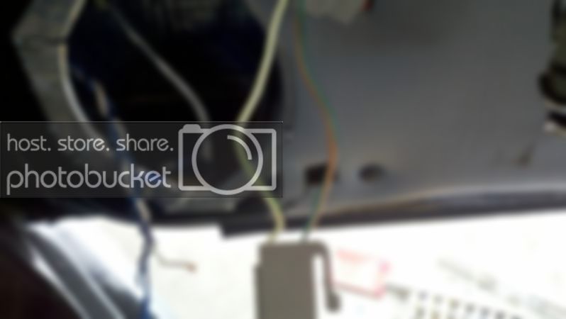

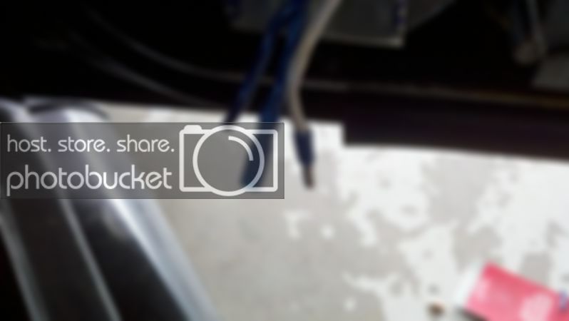

Fresh wire:

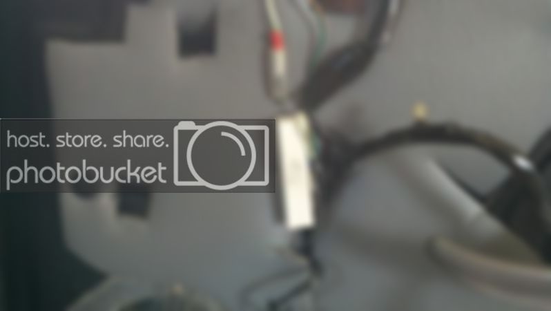

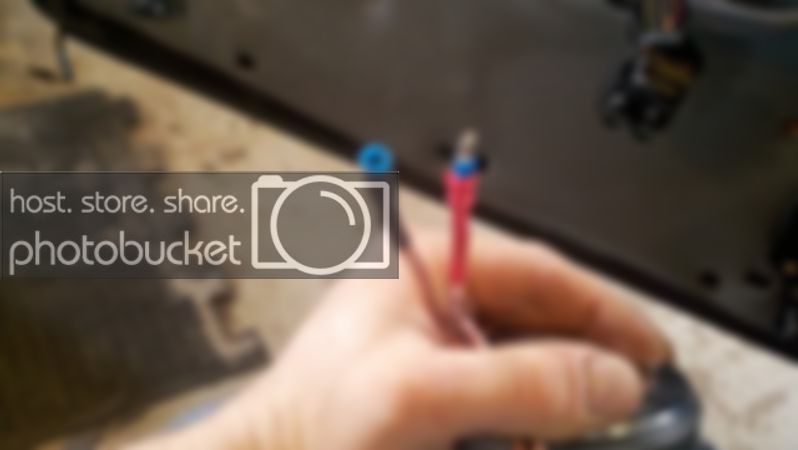

The Lt Green on White is the Pos wire so this is where the resistor will go:

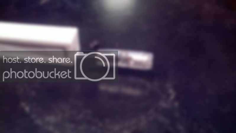

Nice clean plugs:

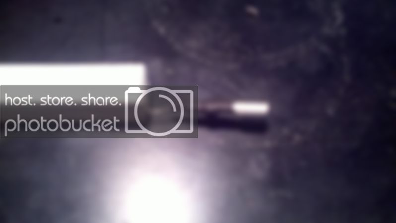

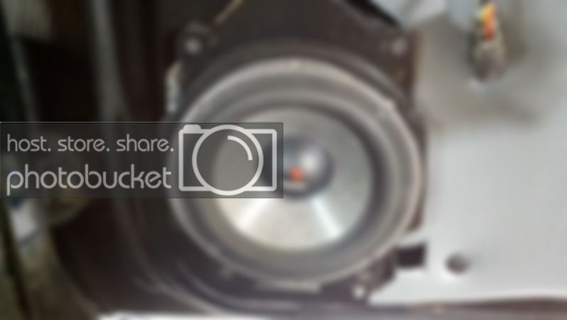

Bracket mounted, and it is ssssssssolid:
Woofer is in its happy place:

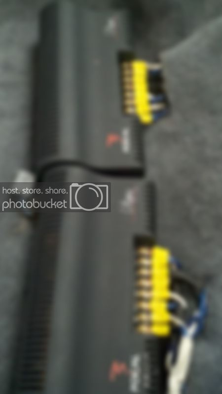

Picked up a Tsunami optima batt topper for the power/ground upgrade. Zapco DC Ref 650.6 looks to fit in the wheel well nicely. I will float it for better cooling. Power and ground dbs are mounted and solid, bout ready to start hooking up wires. Just have a few more things to add:)

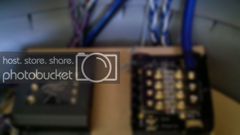

Few pics of how I setup the woofer wiring for plug-and-play:
Crossovers all wired in:
