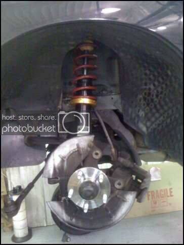

Suspension Mods:
Eibach Pro-S Coil Overs:
Part Number Manufacturer Part #: 3510.710
Front and Rear fitment
Ride Height: Threaded Adjustment
Note: Avg Low 1.0-2.5"F 1.0-2.5"R

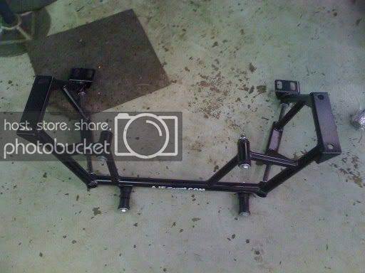

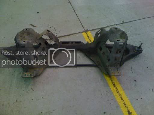

Also tossed on AJ front K-member, and A-arms along with Steeda balls. New Steeda tie rods, as well as a Flaming River collapsible steering shaft kit.

You ditched a lot of weight going with a tubular k member, Dart 363 sounds nice, Any idea on H/C/I combo? Don't ditch the auto ***** either, 5-Speeds do nothing but impress little boys and Auto's win the races! lol

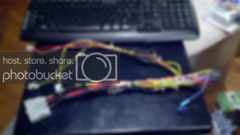

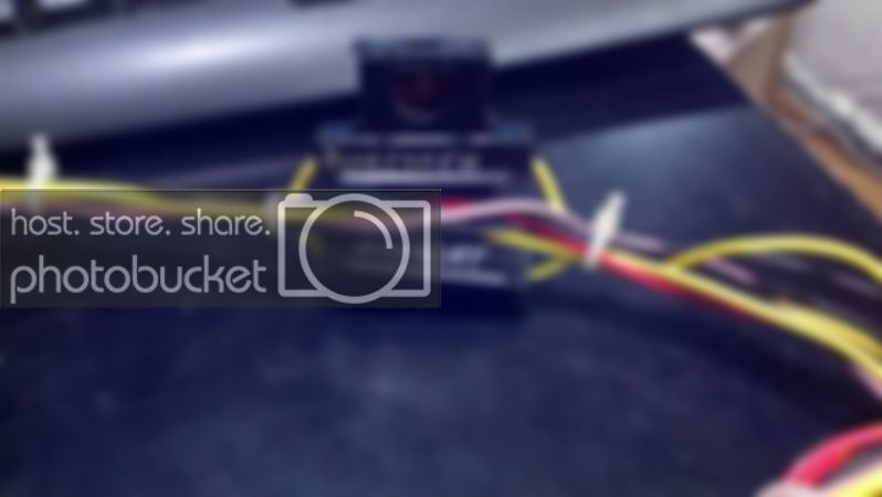

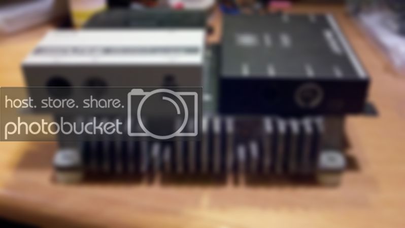

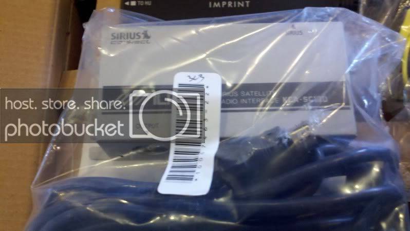

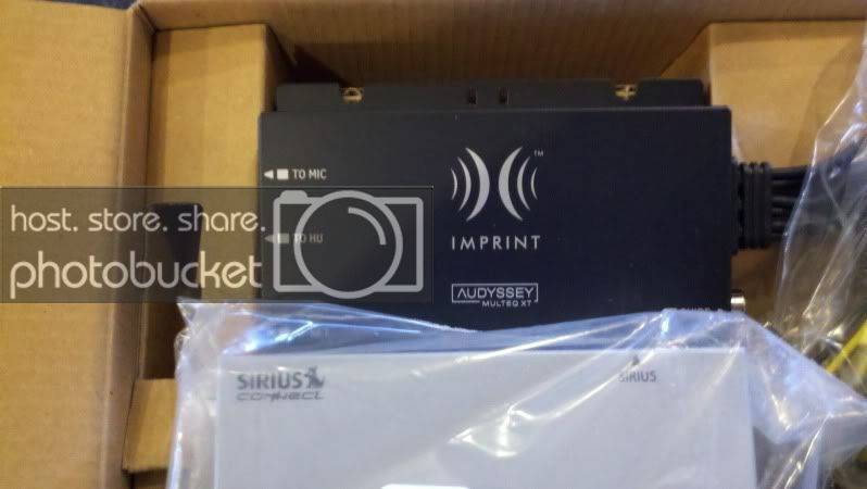

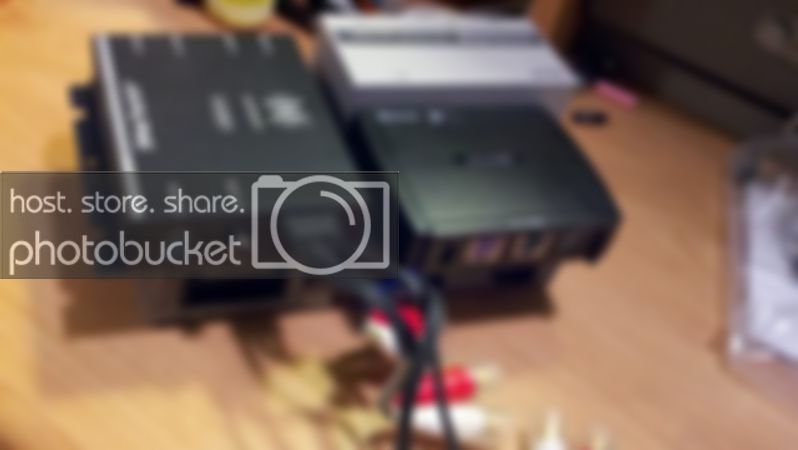

Coincidentally the OE front amp sits the same height as the three units going into the dash. Since I am not running a DD unit I have a little play on height. My plan is to mount these guys on a 1/4" piece of wood, drill matching holes to OE mounts, mount units to wood and secure them nicely to OE mounted location. Looks like they will fit B-E-A-U-tifully

There is definitely a difference when you let that clutch out vs an auto doing the work for yah. The suspension took A LOT of power loss out of the equation. When you push the gas, you feel the power at the wheels instantly. When you hit the brakes the car does not lean forward at all. It positively and negatively accelerates as a solid unit. I will get more pics up as soon as I get the HU and components into the dash. I need to get going on fabbing the 3-way crossover pods.
