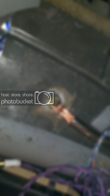

The attention to detail on the wiring to use grommets when it runs through the frame areas is nice touch. For taping down the wires try some left over soundening. I found it sticks better than duct tape.

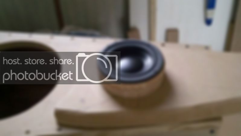

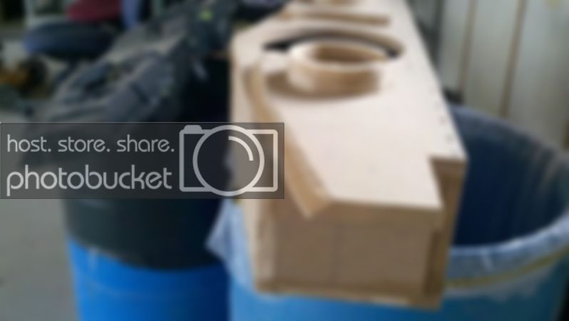

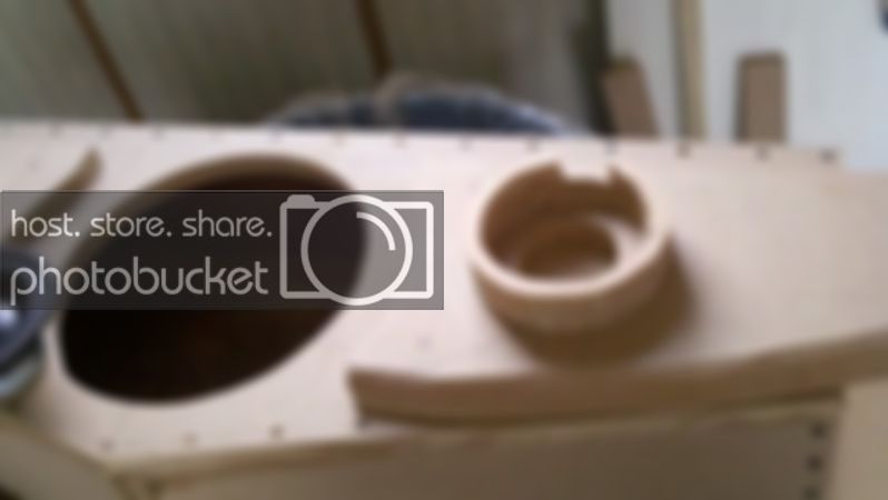

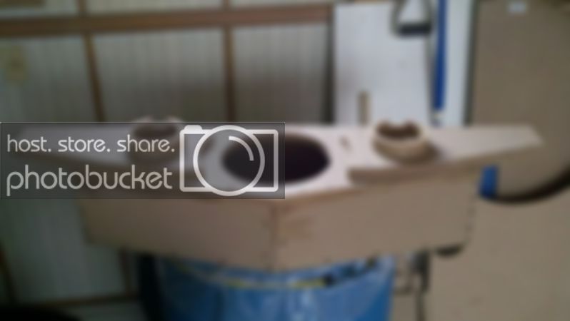

Enclosure is slowly taking shape. I need it to fit right up into the rear deck area as well as possible. The sub will fire into the cabin along with the rear fill. I will be cleaning up this thing cosmetically and matching the trunk carpet with it. I am borderline on the paint thing. Just going for function for now.

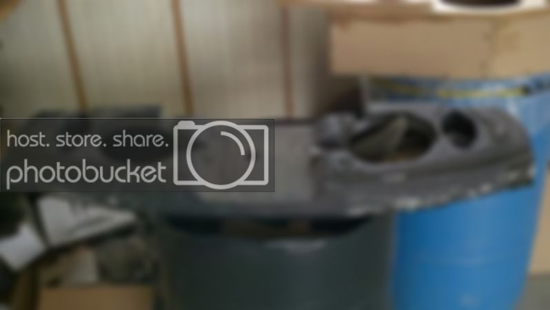

Old sound board to mimic:
The mock Mach replacement:

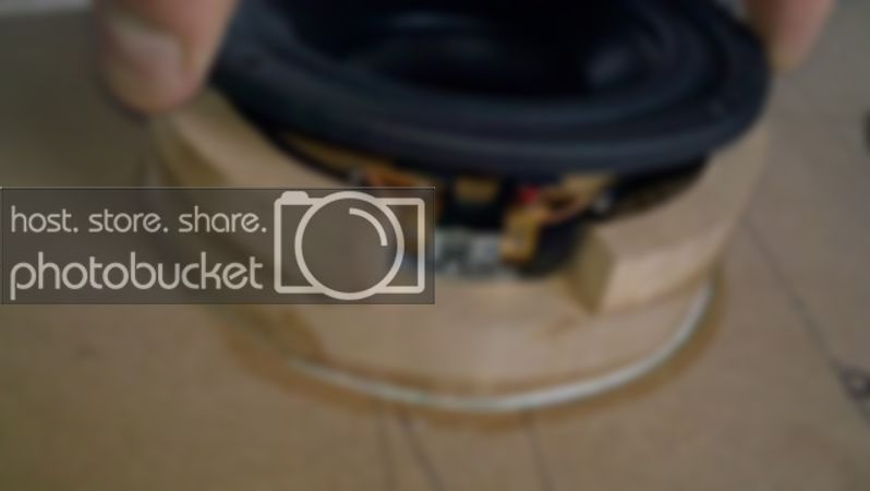

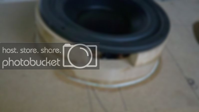

I have 2.5" from the bottom of the deck to the top of the covering on the OEM deck cover. I have 3" tall speakers.....soooooooo I drop the speakers 3/4" into the mounting board and support the rest with 1.25" rings, add a cutout for wiring aaaannnnddddd there you have it:)

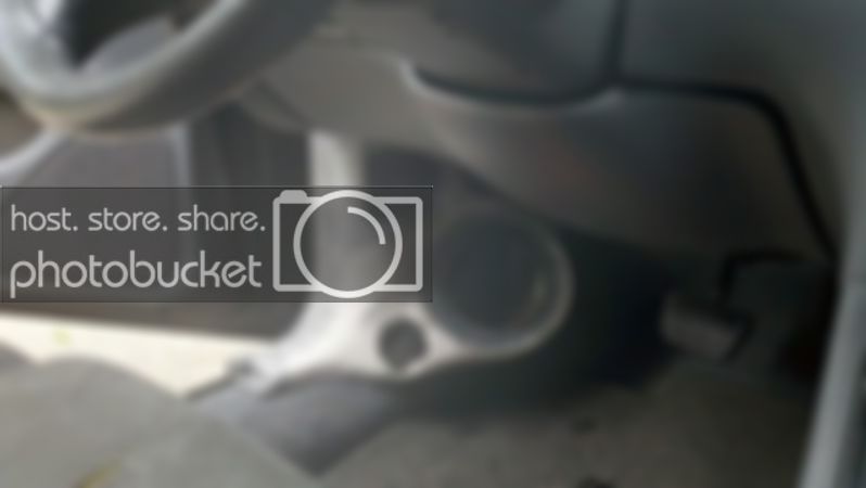

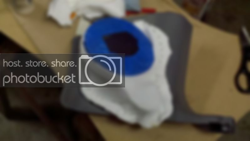

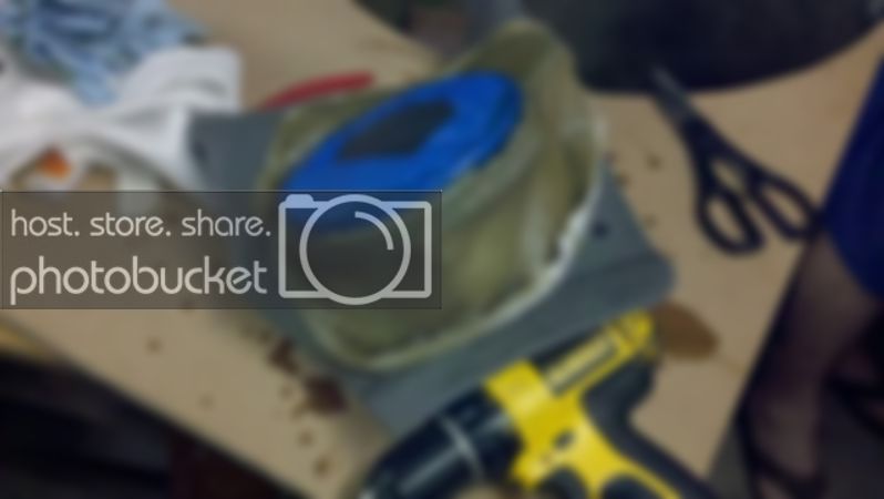

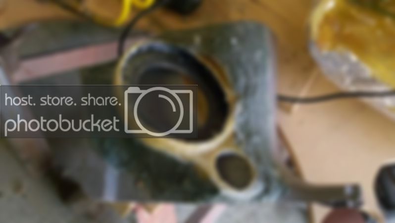

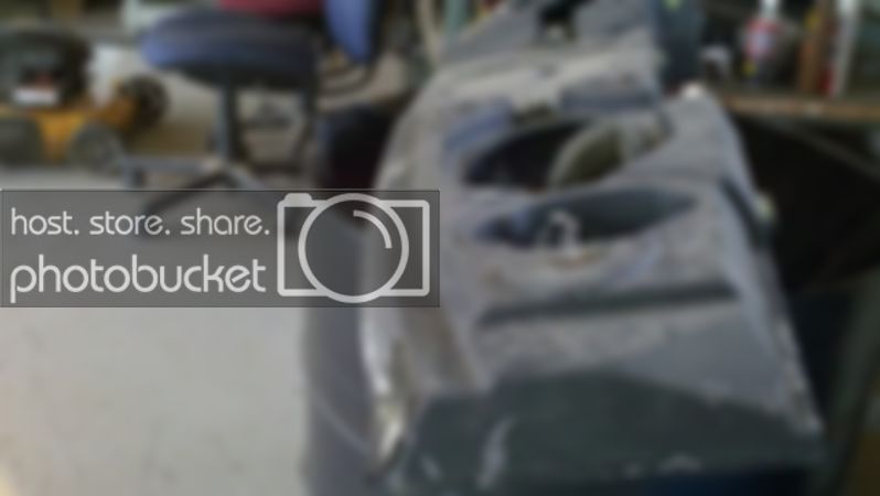

Getting the kicks slowly rounded together. I will be fleesing and glassing a nice smooth transition into these pieces. I WILL DEFINATLY be cutting into the kicks and getting a tight hug on thses panels. I need to conserve as much room as I can. I will be aiming the pass kicks at the driver headrest and the driver kicks at the dome light.

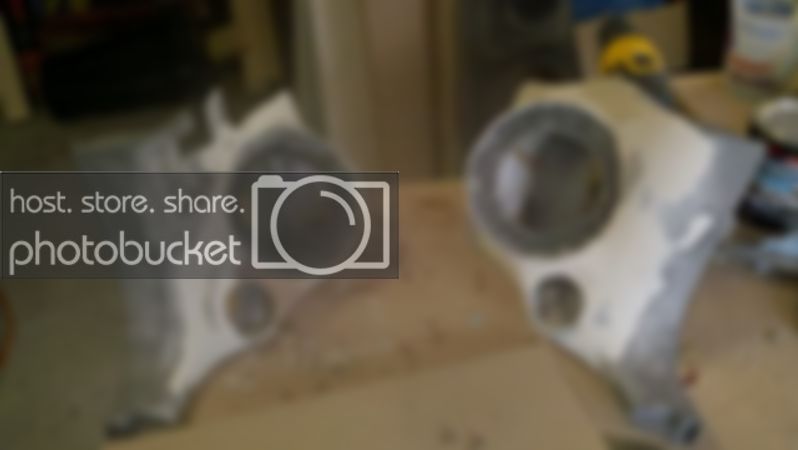

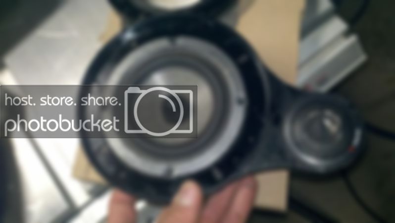

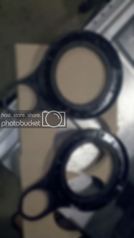

I used a 5 1/4 grill ring which was AMASINGLY the EXACT inside diameter as the outside diameter as the 4" mids. The mids and tweets fit flawlessly //content.invisioncic.com/y282845/emoticons/smile.gif.1ebc41e1811405b213edfc4622c41e27.gif

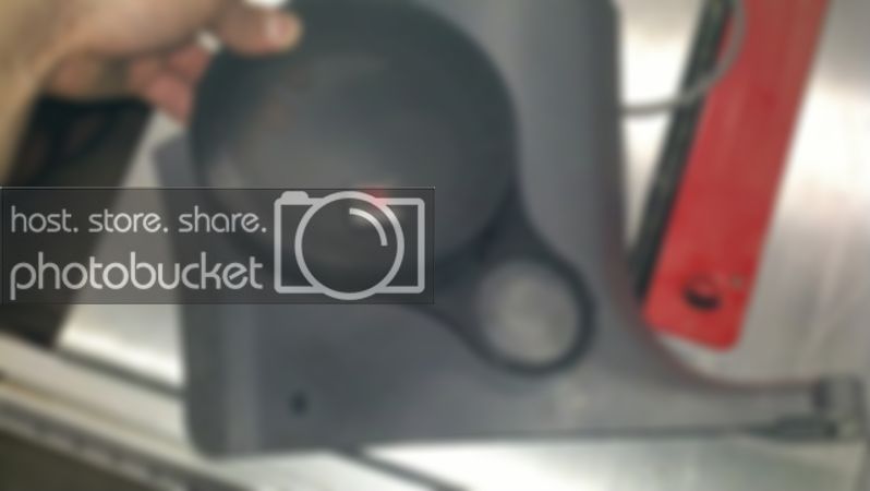

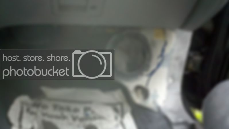

Next step is to get a dot laser and aim these bad boys the way they need to go!!

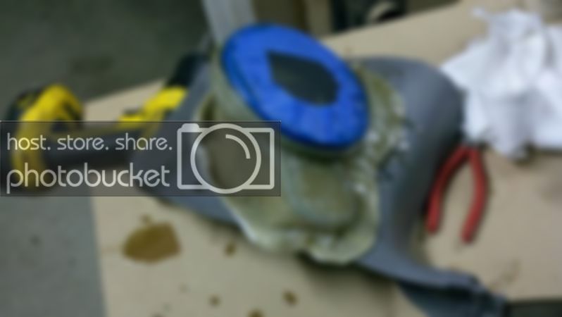

It took an hour or so, but with a dremel tool and a laser pointer these mids and tweets on the passenger kick are aimed directly at the head rest of the driver seat maybe a little to the right of the driver head. The midrange also clears the dash flawlessly. A little fleese and roesin and this one will be ready for glass and filler tomorrow:)

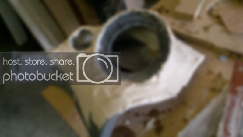

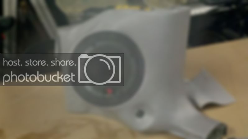

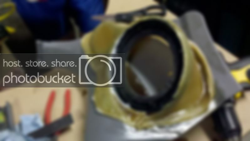

The fabric adhesive is not 100% cured so I have a screw/washer keeping things tight till it does. A tweeter will be in its spot tomorrow:
