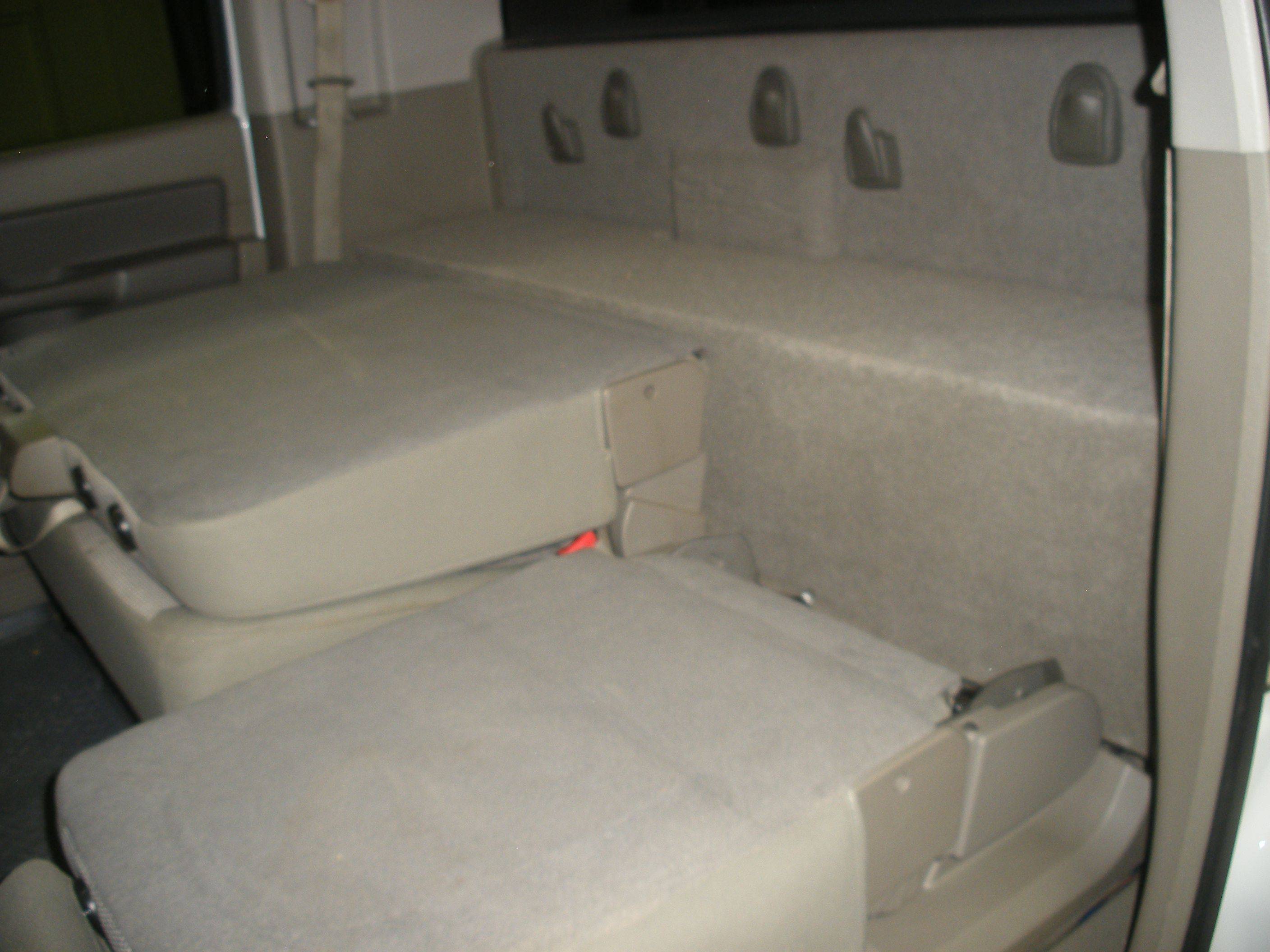

3.11 net behind the back seat. I have enough to give each sub about .75.

What is your max dimensions under the rear seat? And you have the option of raising it too.....to gain some space if you want.
These will be going behind the back seat. There's a ton of room back there but I'm restricted a bit by height. I'm trying to keep the top of the enclosure as close to being level with the folded seats as possible. Like this...
