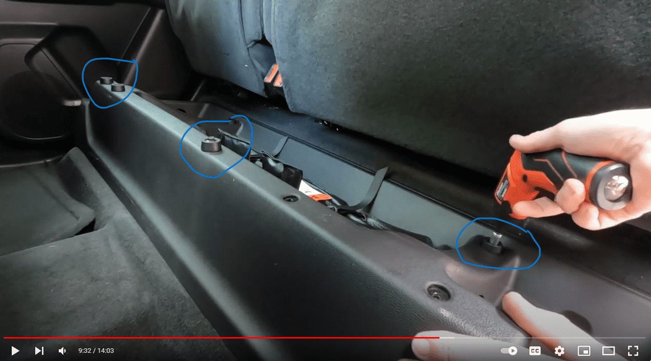

I wonder if auto manufacturers now do this because radios are very integrated that they have become expensive. Good thing that Kicker foresaw this issue and built in the resistor.
Are you talking about the module brackets or the ABS beauty side panels?

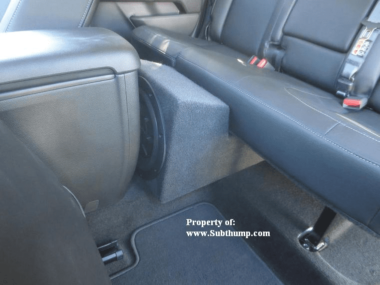

Subthump Enclosure
Approx. Empty Weight: 26 lbs
MDF Construction
Installs under rear seat
Plastic cover and support bar must be removed for box to fit
Box is held in securely by seat
No modifications to truck are required
Speaker fires down with
1-1/2" of box to floor clearance
Fits one 10" shallow sub
Will also fit JL 10 TW3
Normal Cutout Size=9-1/8"
Mounting Depth: 3-1/2"
with restrictions-see below
Volume: .90 cu.ft
Sealed Box
