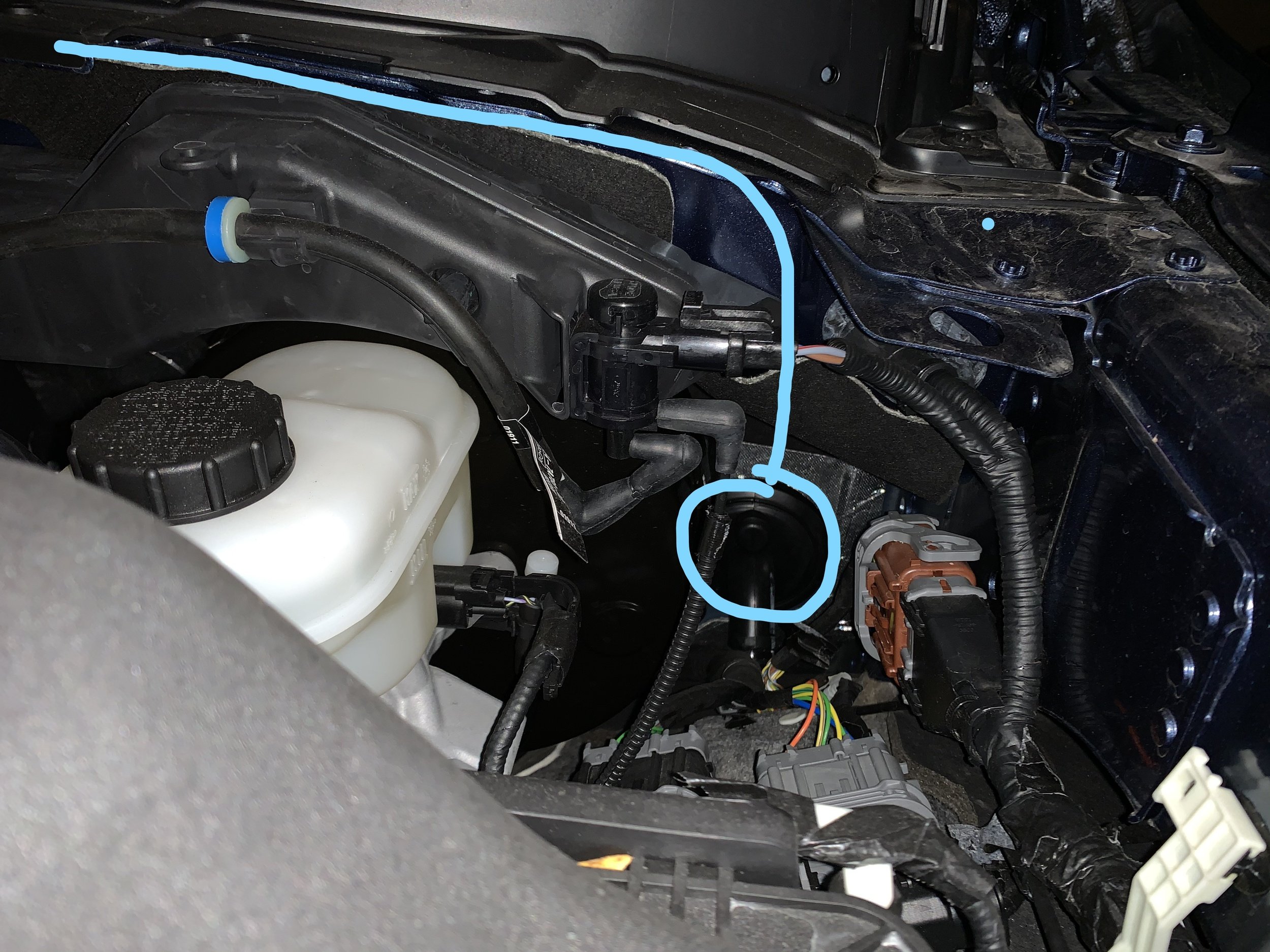

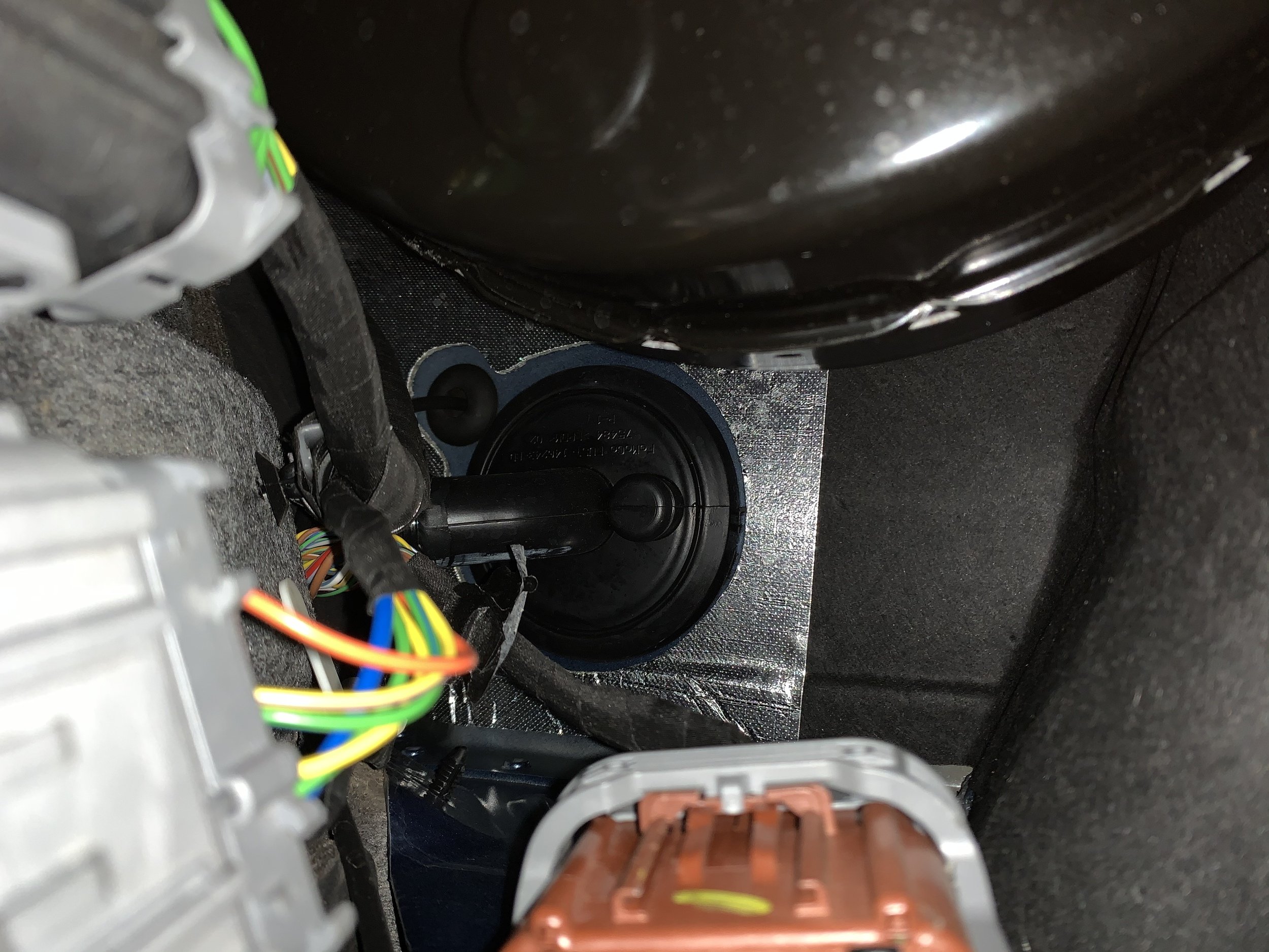

Hi all, looking for some confirmation on my power cable route.
I'm thinking of mounting the 30A fuse on top of the fuse box cover, then routing the cable up under a ridge in the rear of the engine compartment, as shown the blue line below. I'll drop into this large rubber gromet which has a wire harness already running into it. Does anyone see an issue with any of this?
Thanks!

Looks okay to me. Similar to what I did. Fortunately, I had a large rubber grommet on the passenger side. I used cable ties to secure the wire to keep it from moving around.
What size wire are you using? Make sure your fuse is appropriate for your wire size.
okay, thanks. I have a 10ga OFC cable and 30A fuse. I'm all good there, just want to make sure the routing of the cable is okay. I'm also planning to use the black cable cover (I forget the name) and cable ties to secure it.
