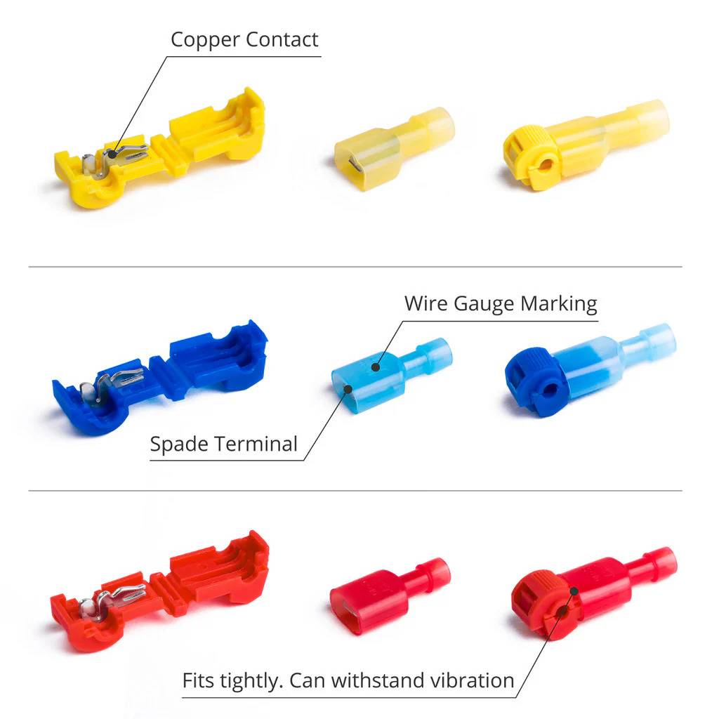

If you are "tapping" into the door speaker to get the signal for the DSP make sure you tap the left and right side speakers to feed the DSP so that at a minimum you have a stereo signal. There is nothing wrong with using T-Taps as long as you use the correct size.
