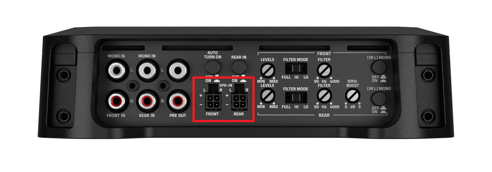

Just get a 4 ch amp with speaker inputs.
