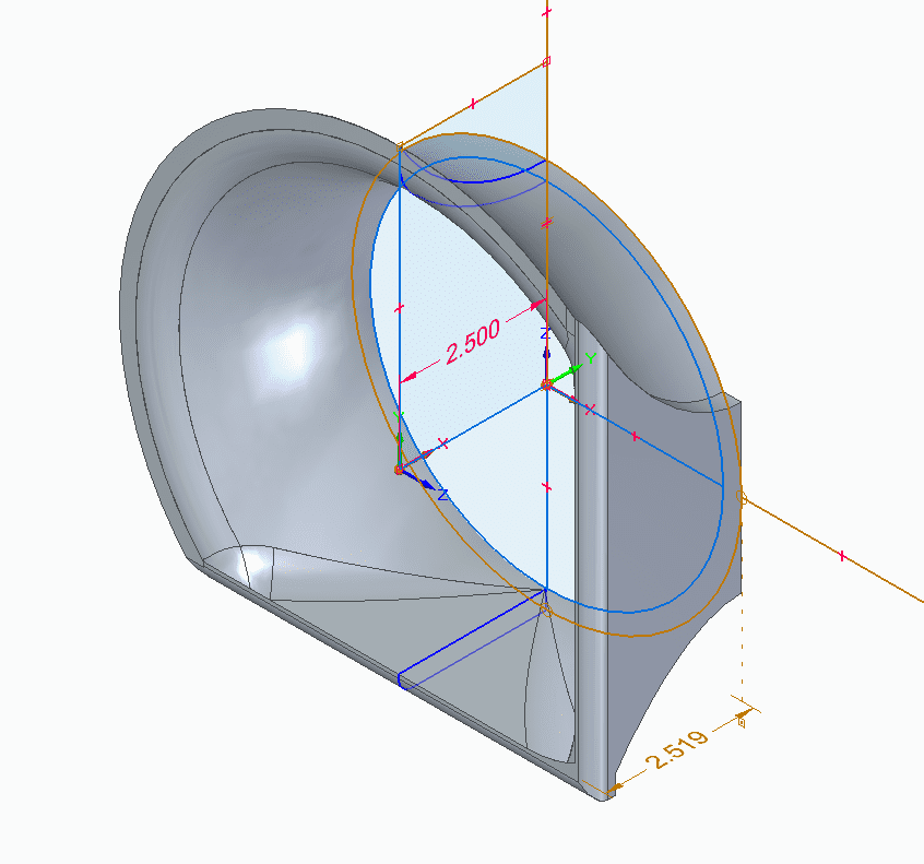

Solid Edge
Looks a lot better than sketch up haha. That's my jam man doing stuff like that, looks awesome. I designed my own aero models in sketchup before

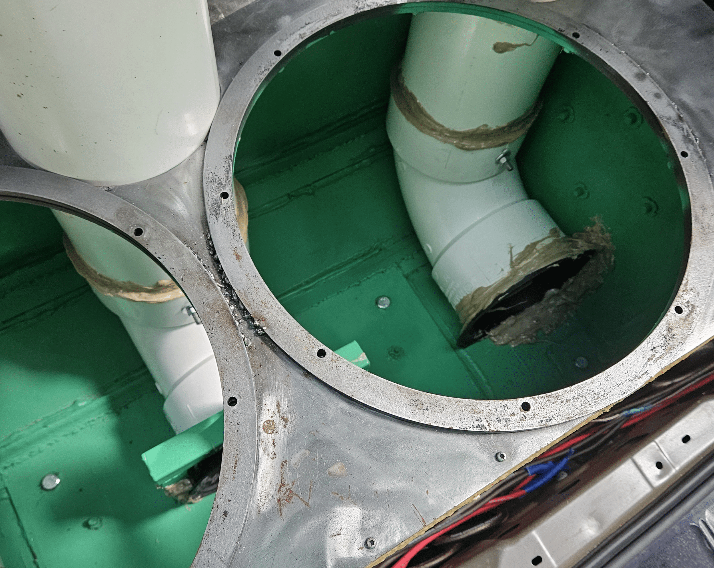

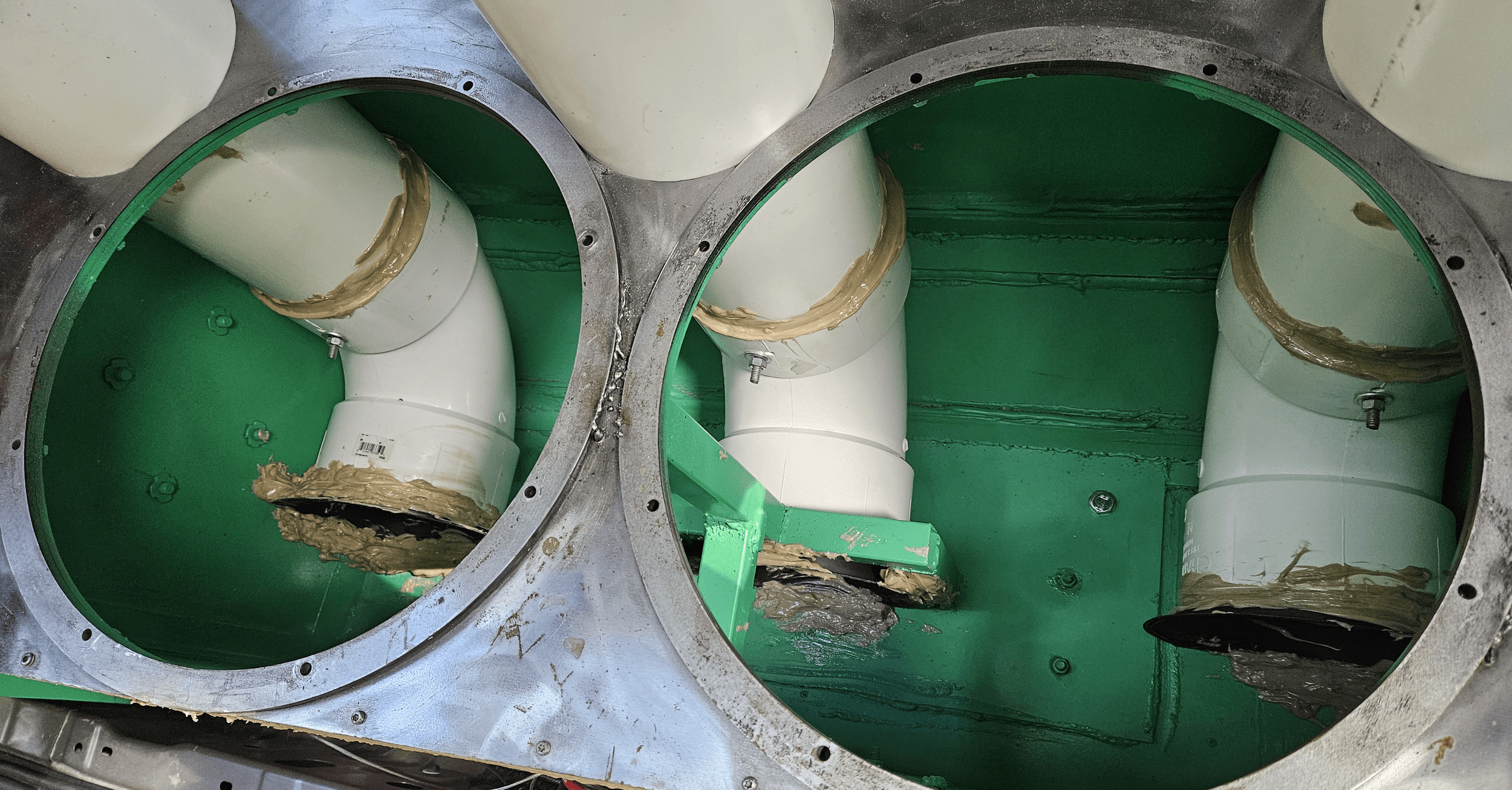

I actually called this with my bud with the SoloX-15s... I did not think the sub was salvageable. Something in the gap was my worry... impossible to clean.
You took that sub nuclear man. I haven't seen the extinguishers deployed since someone was tryin' for 180db and his amps went. That was a few years back at regionals iirc

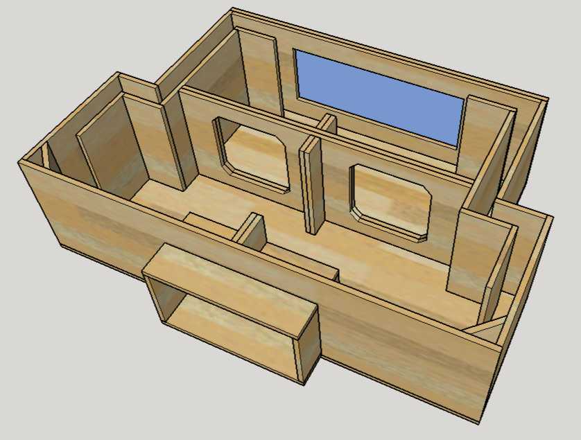

I honestly designed mine as I went. I knew roughly what airspace I had, and I made several cardboard mockups to try and figure out how much I could fit. I had to find a way to fit all the batteries, amps, ports, internal airspace, etc.
I had the entire interior (except the roof and trunk lid) done before I picked subs or started building the box. Center console battery bank, 3 way active front, rear speakers, doors deadened, the works.
I think the box looked like this when I settled on 2 15's:

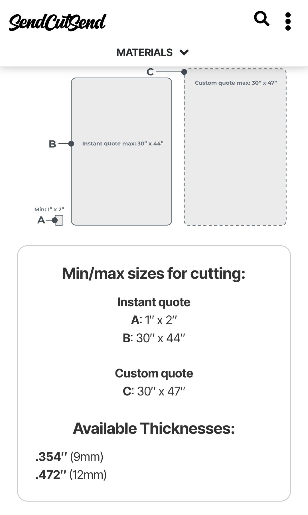

That site I used to get my steel baffle CNC machined actually has baltic birch as a material you can specify.
Normally it wouldn't make sense to pay to get wood cnc machined, but I wonder if it would've been useful for something like that with tight tolerances and odd shapes.

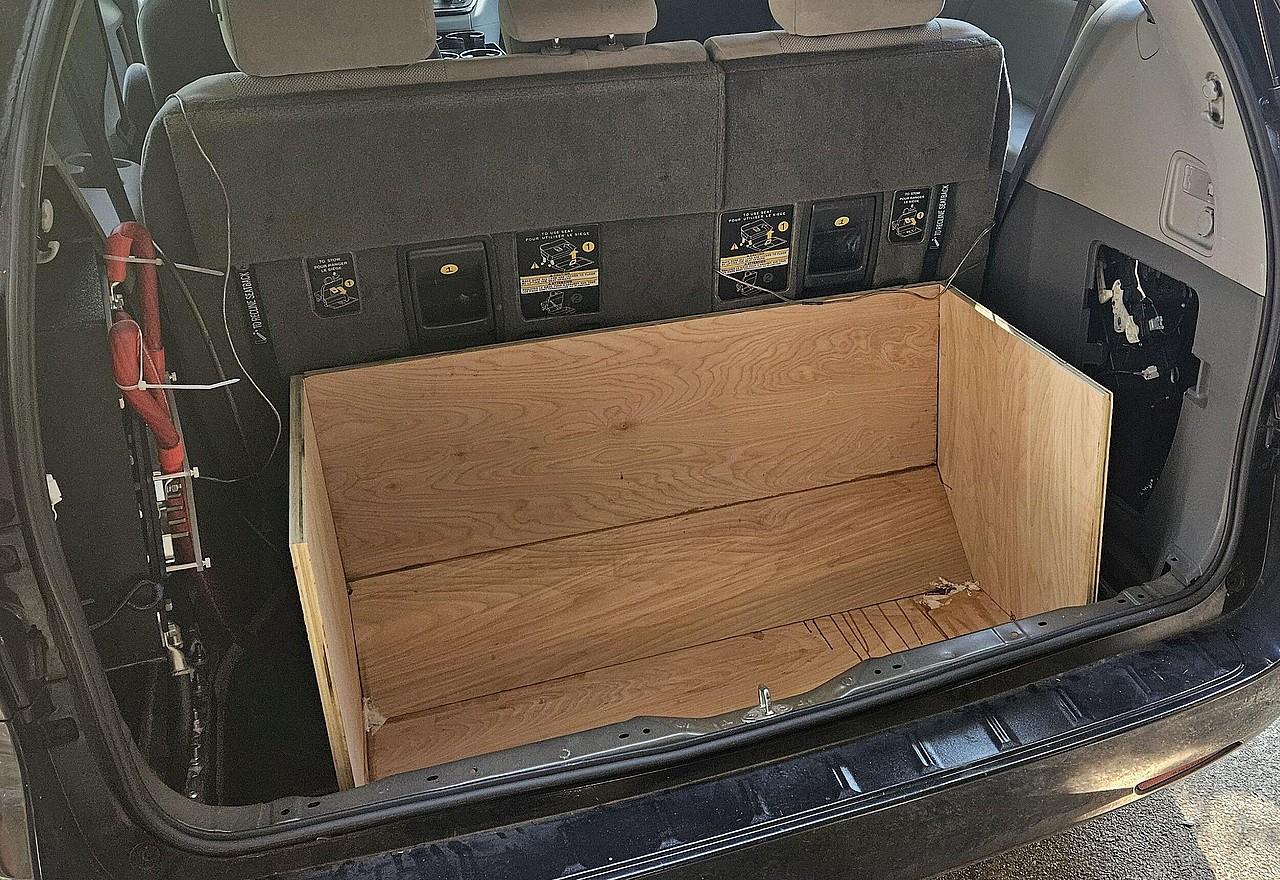

Got the interior flares in. I made them super shallow so there's 6" of clearance between the opening and the wall.
Probably overdid it with the construction adhesive, but I wanted to make sure there was no leaks or vibration.
