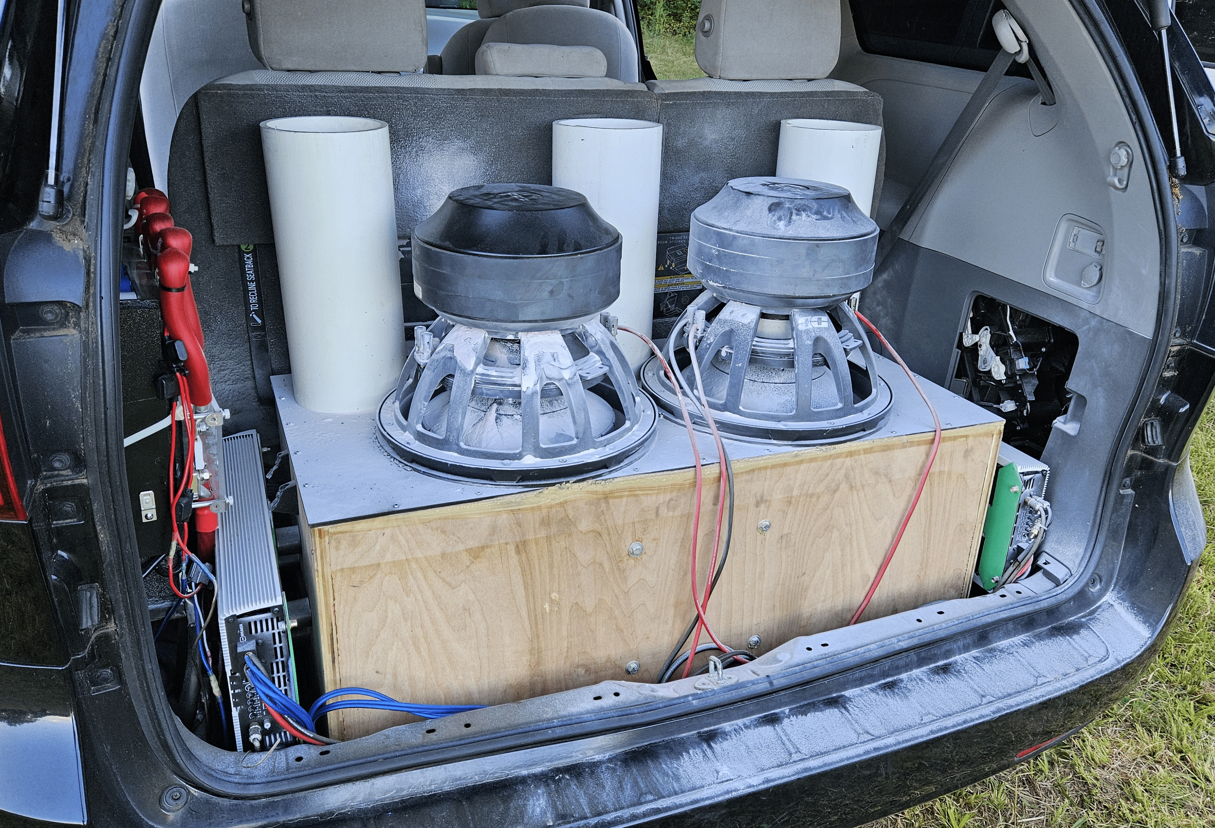

Featured 2018 Toyota Sienna minivan with 2 DB4515R on 2 Taramps Smart 8 Bass
I want to see what it can do.
I say 'it's done", but yeah it's "done" until something else breaks 😂
Last guy with a Sienna on this board who posted about his basshead build had 4-18s on 15k I believe. He was replacing windshields weekly because of the flex. You at this point seem to have the bases covered, so did I until my upper hatch pins walked out at regionals during a street beat run and that was on a single sub build. Those DB9515s are no joke and an 8K per sounds about right to me even though your enclosure screams low port area to me. No shade thrown man... I'm sure it'll dig hard but ultimate output may be limited with 3 6" ports.
Sounds right. I didn't even plan to wood panel my roof over until I got the system in and started bumping it, and it broke all kinds of things lol. I can see why his windshields were breaking - 4 18's is much more cone area, and I didn't even fully use one 8k before it was an issue, so he had over double the power. Did he have a stripper pole?
Potentially. You are correct, it's small for the amount of power I'm using. Winisd modeling (which we both know is just a guess) says I won't have port velocity issues until 10 kW if I remember right (that's real or clamped power). I forget the exacts because I did the modeling awhile ago. I was trying to maximize my space, which isn't much, and I wound up on the 2 15's. Increasing the port area greatly increases the gross enclosure volume. I think I picked it over 1 18 or even 1 15 just because having the 2 gives me more power handling because 2 coils. I think for music, having the better power handling is better, just because you spend less time at the max. Hopefully I picked right.
I had to balance it with the tuning also. I wanted 30 or less, wound up on 28, and you know with big port area and low tuning the port length (and thus volume) is huge. I maybe could've gotten more port area if I went for high tuning, like 35.
Basically, I think my "low" port area + 2 15s is maximizing my airspace over something else.
But yes, good call. You know your shit. The ports are small but it's a trade-off I made to fit this shit into the trunk.

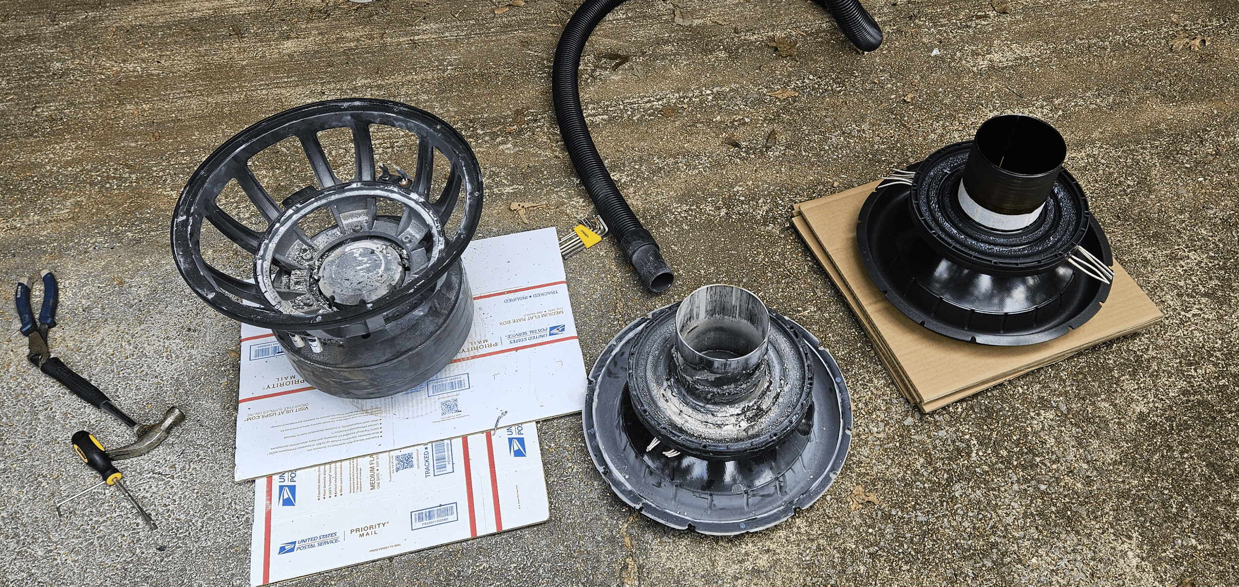

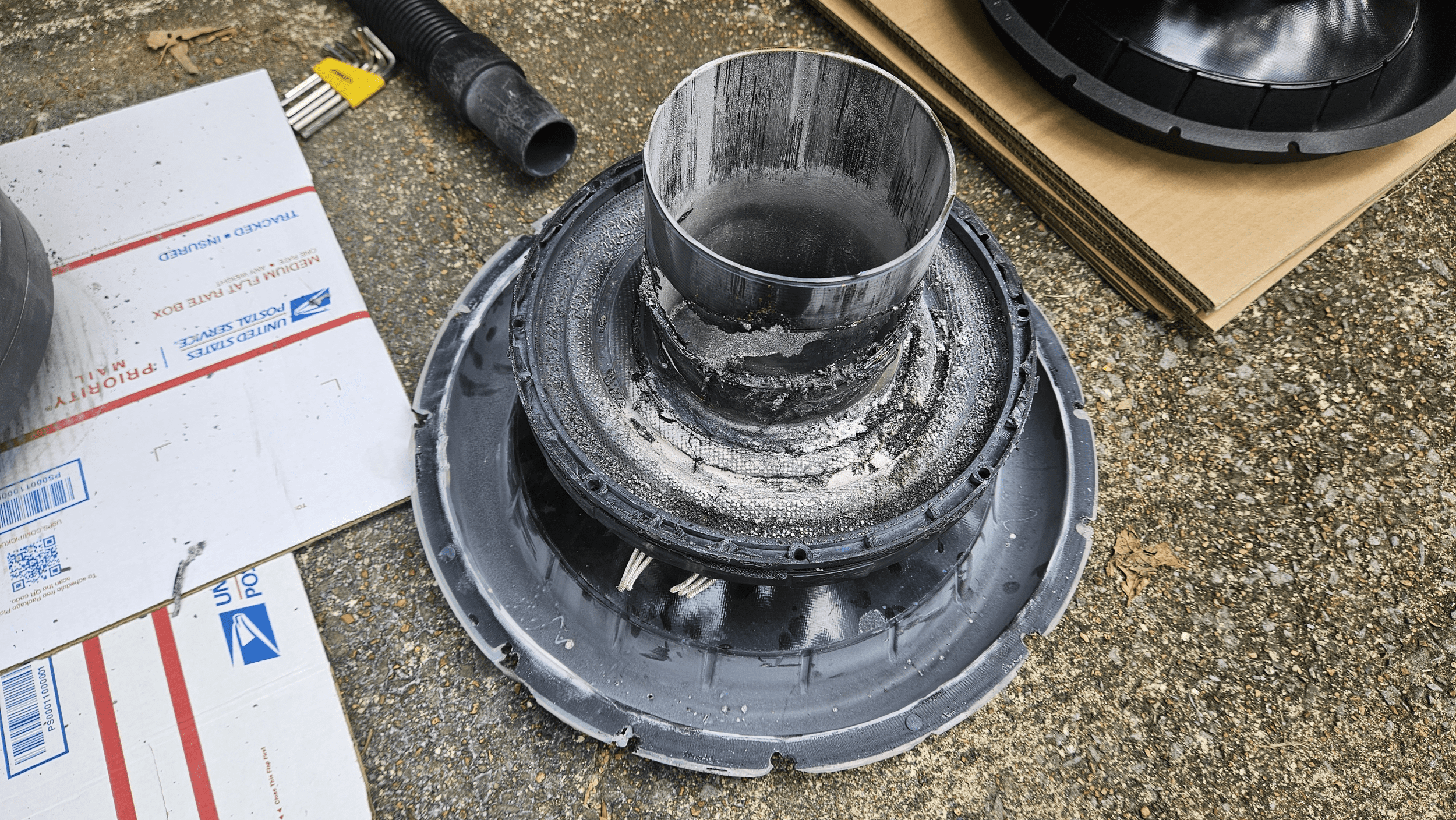

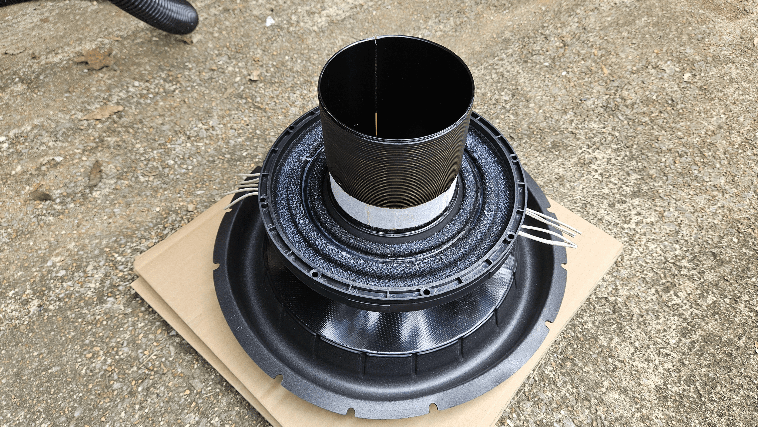

I got the car apart. Thankfully, both amps survived, and one of the subs survived. So I have to clean the fire extinguisher dust out of everything and recone one of the subs, and I'll be bangin again.
I also competed in 2 classes, both music. I got first place in one of them. It was pretty cool.
It was either clipping or over excursion that killed it I think. It failed suddenly so it wasn't slow heat build up that got it. It's possible the coil scraped the gap from over-excursion. I don't think I was clipping, but I wasn't running a clip monitor so I can't rule it out. I ordered a clip monitor for each amp just so I don't have to worry about it in the future.

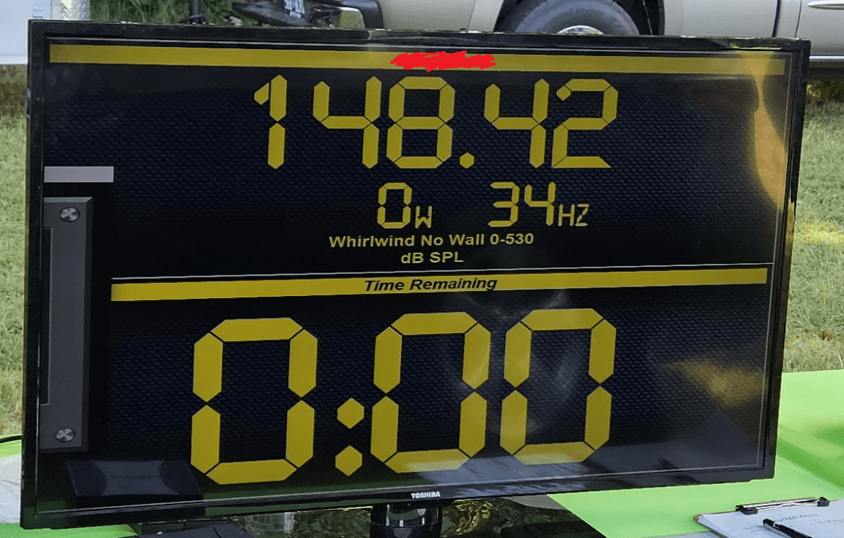

NBAC. I competed in 2 classes, both 30 second music averages. One of them was the second lowest tier of modifications, just above trunk only. I fit into it because the only interior modification visible in my car is the pole. I have all my interior panels and headliner. That's the class I won, with 148.2 at 34 hz
The other class I took 2nd with 148.4 dB at 34 hz. That class was just a no-wall 0-531 sq in cone area (2 18s or less) class. Exposed panels and deadening allowed. I didnt see the car that beat me but he did a 153 so it must've been loud.

Looking at that poor sub in the photo with dust all over it from the extinguisher... Ouch.
rip
