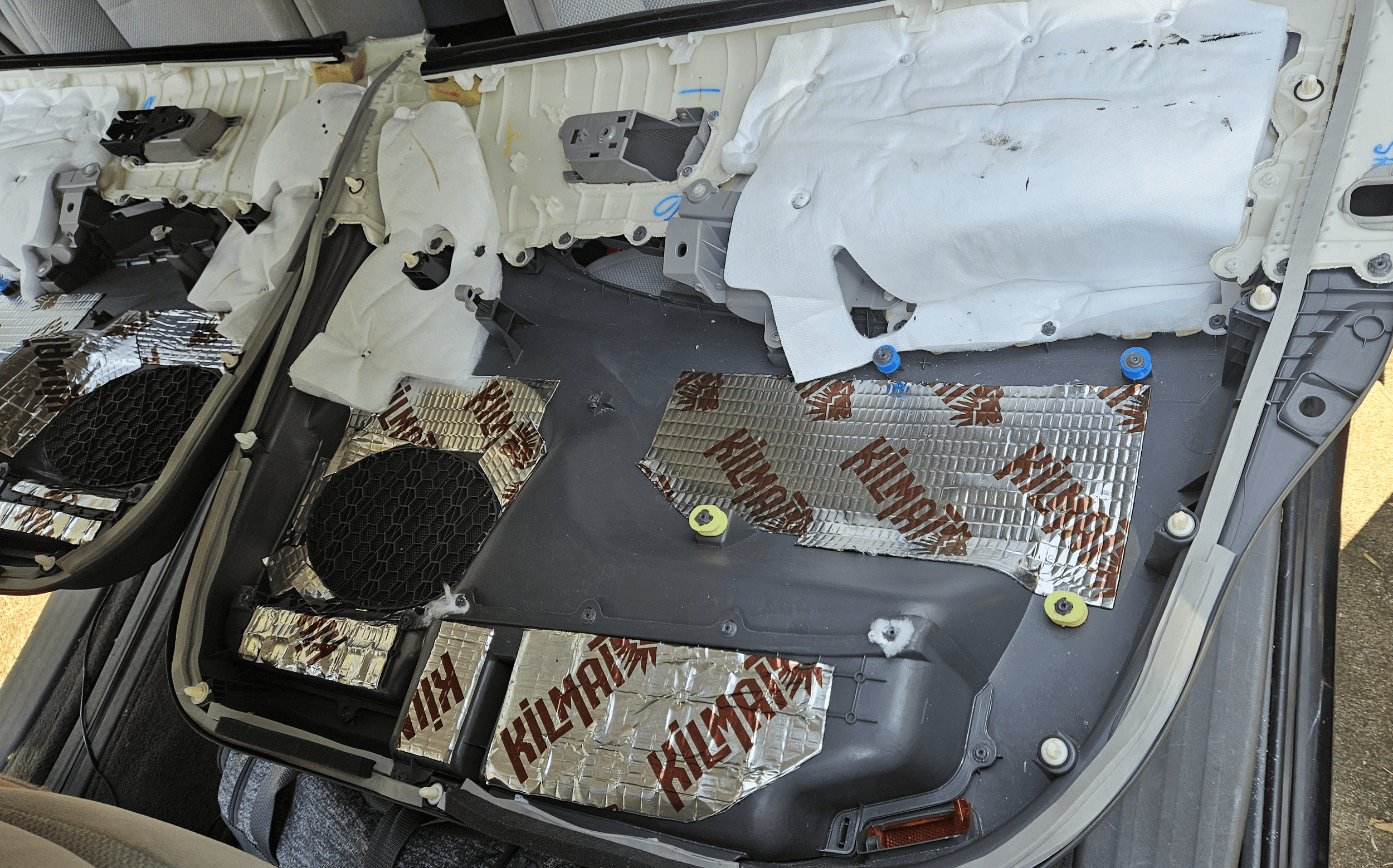

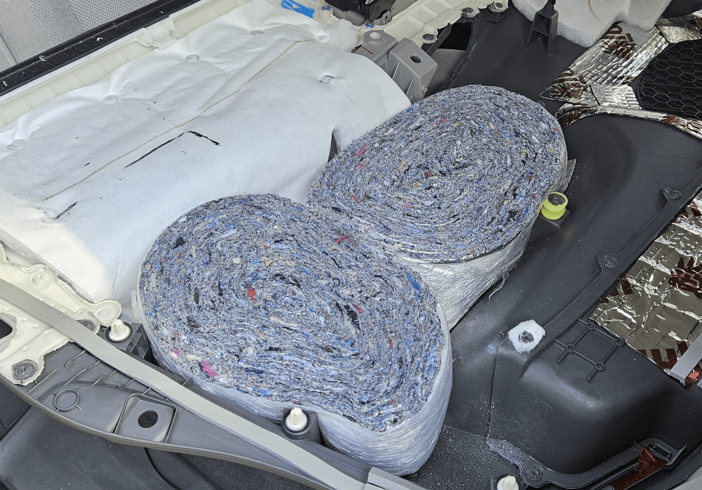

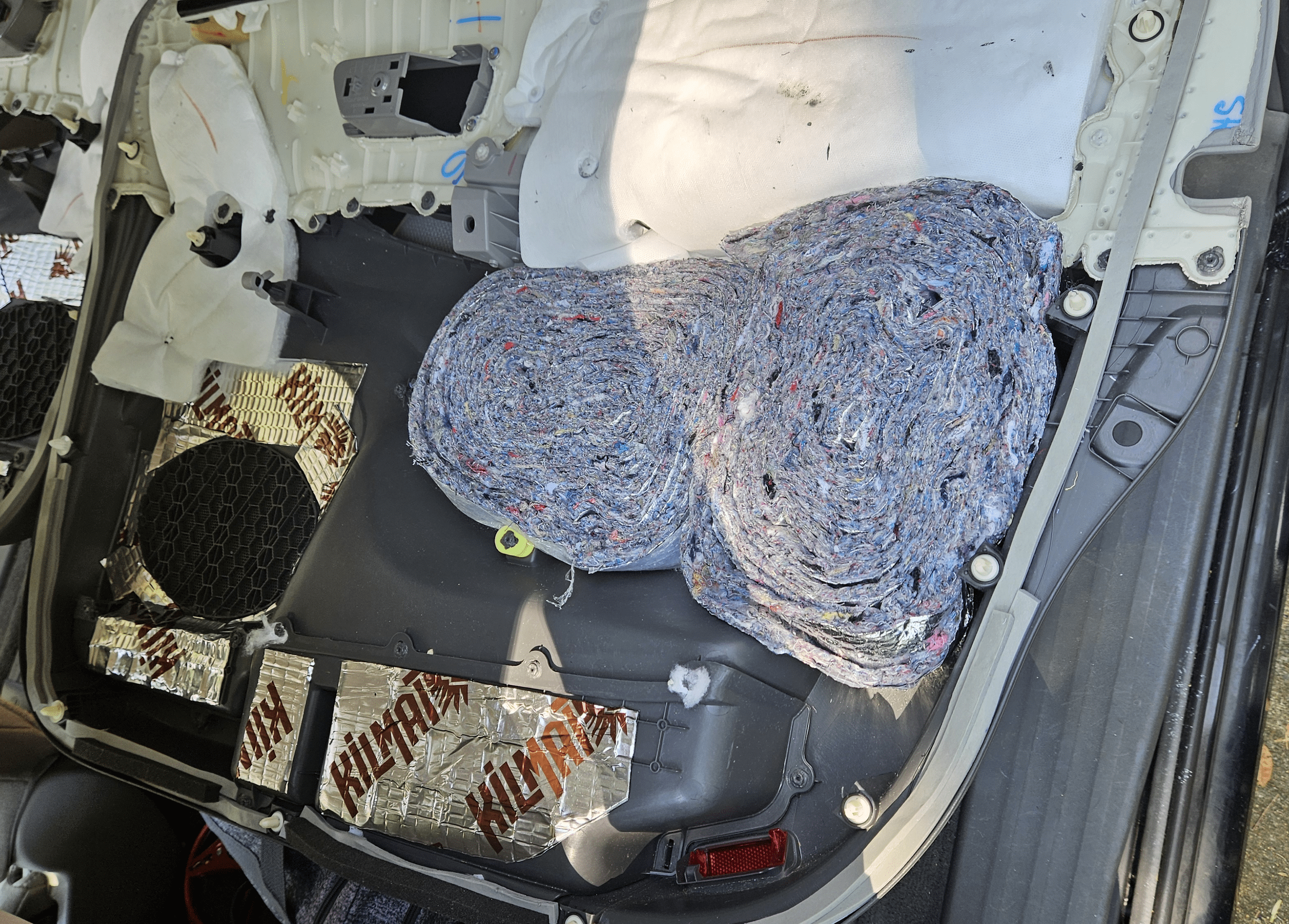

Bit of a boring update, but I added denim insulation and foam weatherstrip to my front doors. I was getting a bit of glass rattle and rattle from the plastic panel. I wanted to fill the biggest void in the panel with it so it would be better damped. I have the 8" midbass in the doors crossed from 80-400 hz. The subs are low-passed at 60.

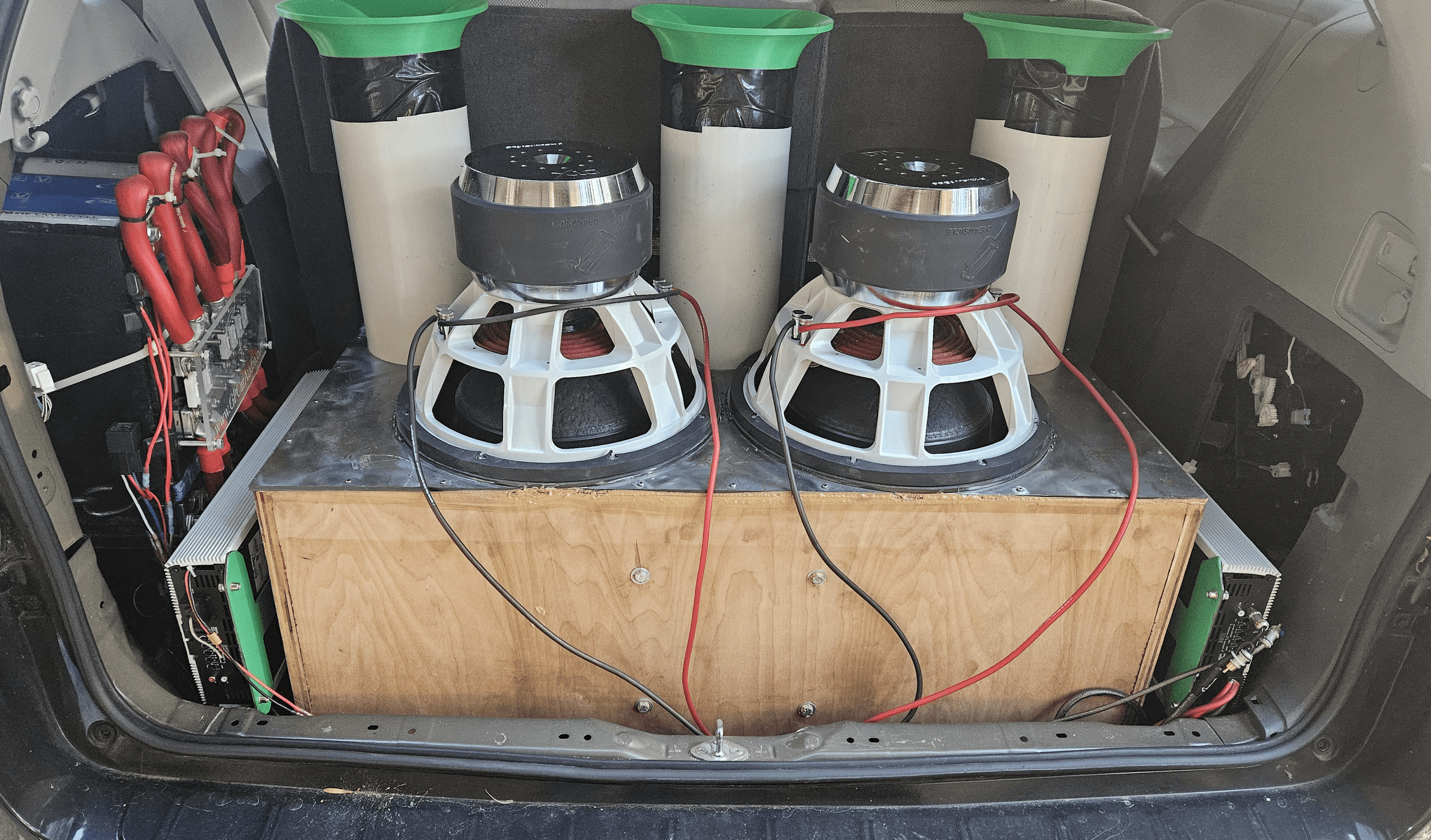

I think the blown subs motor is trashed. The new recone lasted maybe 1.5 hour on moderate power, just trying to break it in. From the scoring on the coil I think it still wasn't clean enough. Disappointed I lost another recone to trying to salvage it. The pole is also visibly shifted ever so slightly, there was no rubbing issues but it may perform worse idk.
It seems like the only way to bring it back would be to demagnatize it, disassemble it, clean it, reassemble it, and recharge it.
At this point, I'm considering selling the other db4515r and getting a new different pair.
I also reached out to deaf bonce a few days ago and haven't heard back. I was mainly just curious if they knew what to do here.

That maniac with the 2 soloX 15s just retired the set after he literally slagged the coils until liquid metal was dripping out of the motor. I should say told him so but... Lol ... He knew what'd happen eventually. He just replaced the subs with new.
I warned him it'd be impossible to clean out the gap after slagging the coils. Hey... I hear magic unicorn tears can lubricate the problem.
Sorry... Old joke
I'm sorry trial and error cost you. $ is no joke

Probably best to just get new subs at this point, but did you blow out the voice coil gap with a real air compressor? That can get a lot out if you have the pressure at 120 psi or so. And look in there with a good light and magnifying glass if needed. I don’t think I’d waste anymore money on that sub, looked like it burned up pretty good, sell it for parts to somebody that likes to tinker. At the price of re-cones, that’s just more money down the drain if it fries again.
I hate when companies don't reply to simple inquiries. Granted its only been a few days you said, but some never do. That alone would make me go with a different brand. 😅
The person I paid to do it the second time used his shop air on it. I think because it's forced cooling instead of having vents on the bottom, its especially hard to clean, maybe impossible without disassembly on this one. He charged me $80 which is good, but the recones are $350 so that stung 😂
