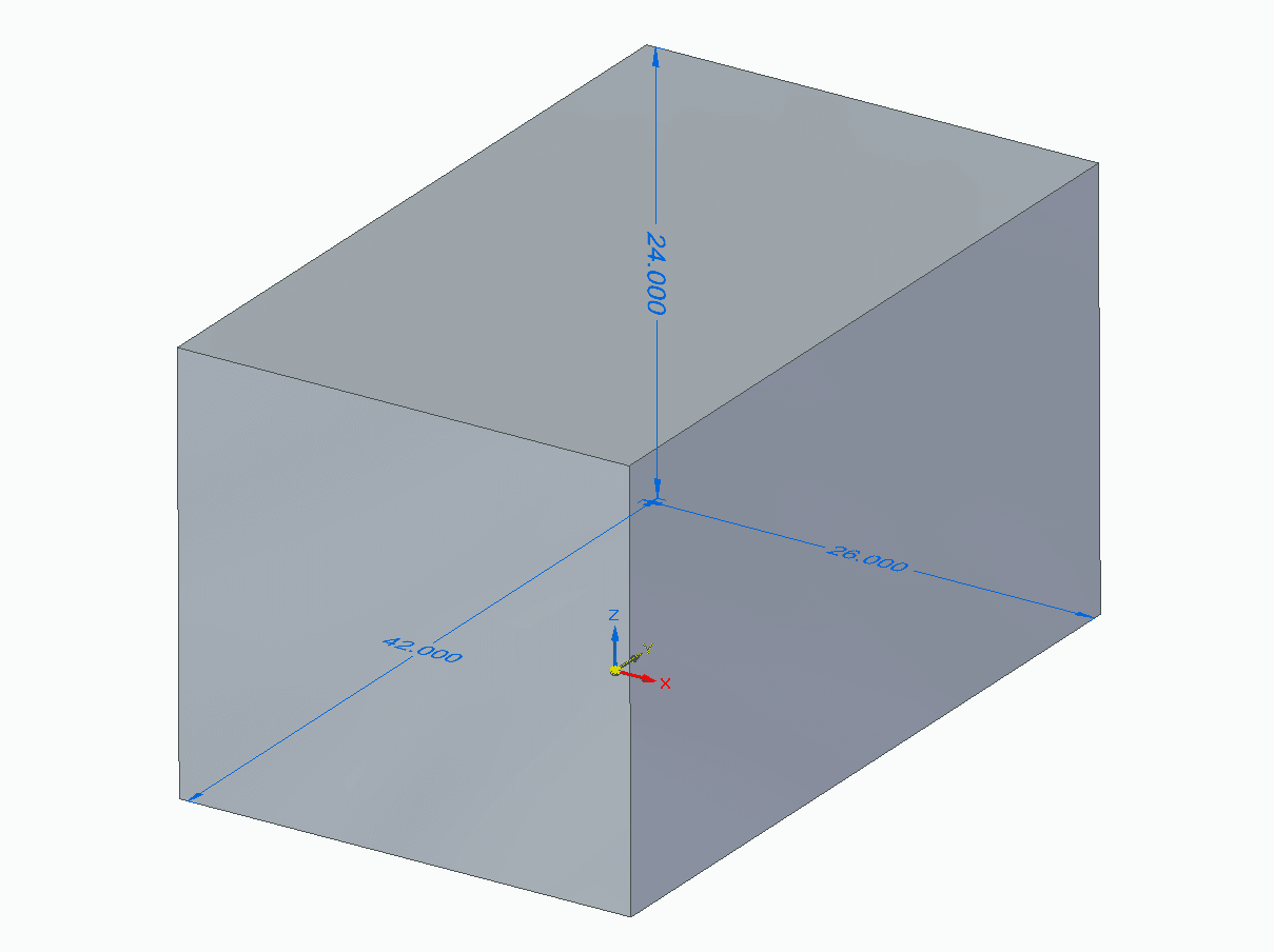

The box extends below the bumper pretty far, the floor in the trunk of the car drops all the way down basically, that might be why it looks smaller than it is. Here's the outside dimensions:
That's 15.1 ft3 gross before you subtract the 45 degree section on the bottom and the displacement of the port tubes.
I really wish there were a way fit more port but I just don't think there is. I'd have to move to a pair of 12's. That would give a lot more room and also require less box volume. I've been thinking about getting a DATS v3 and measuring the box. I know what you're saying with something being off, after seeing other people compete and what #'s they get, I think something doesn't add up. If there's something unexpected in the impedance sweep we'd know for sure if the box is messed up.
I keep checking my models and physical measurements from when I designed the thing and can't find mistakes. So measuring might be the only way.
