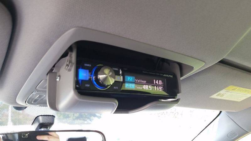

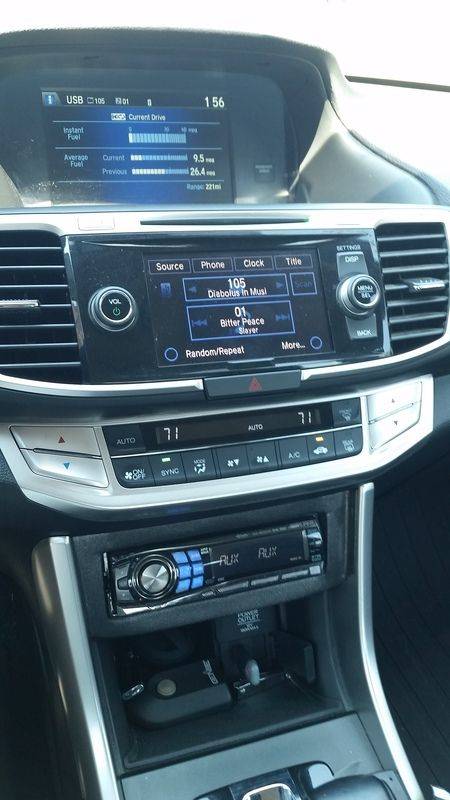

i have tuned the car some more, and i use two laptops to do it
dash looks the same

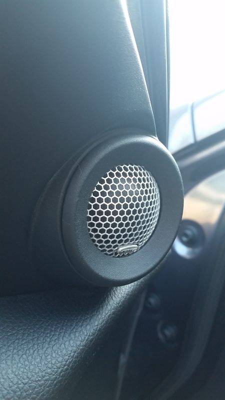

i may rebuild these in the near future for better aiming and less diffraction

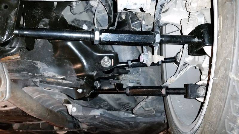

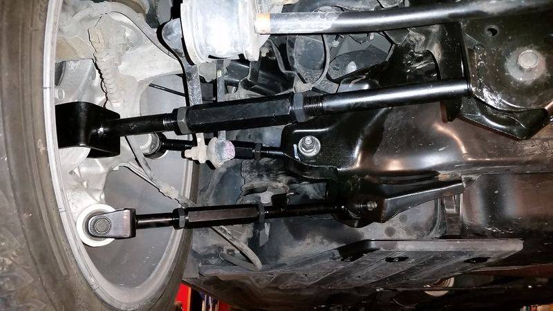

I could not get the rear tires to last more than 30k miles without being terribly noisy. 3 deg of negative camber on one side was the issue, and it's not adjustable. so i replaced the three rear link arms with adjustable arms and replaced the tires.

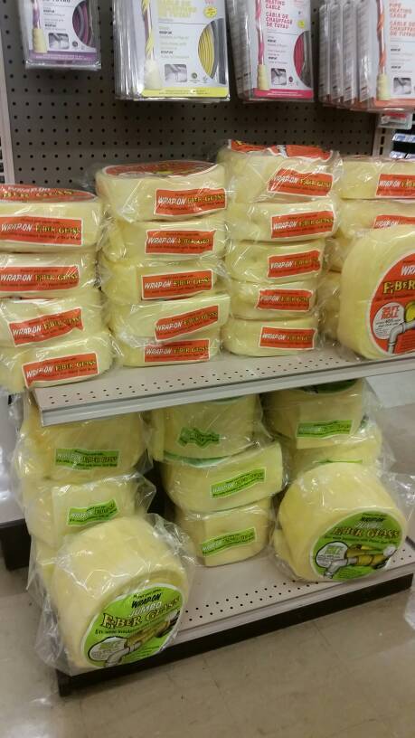

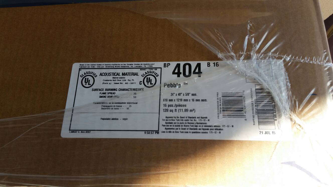

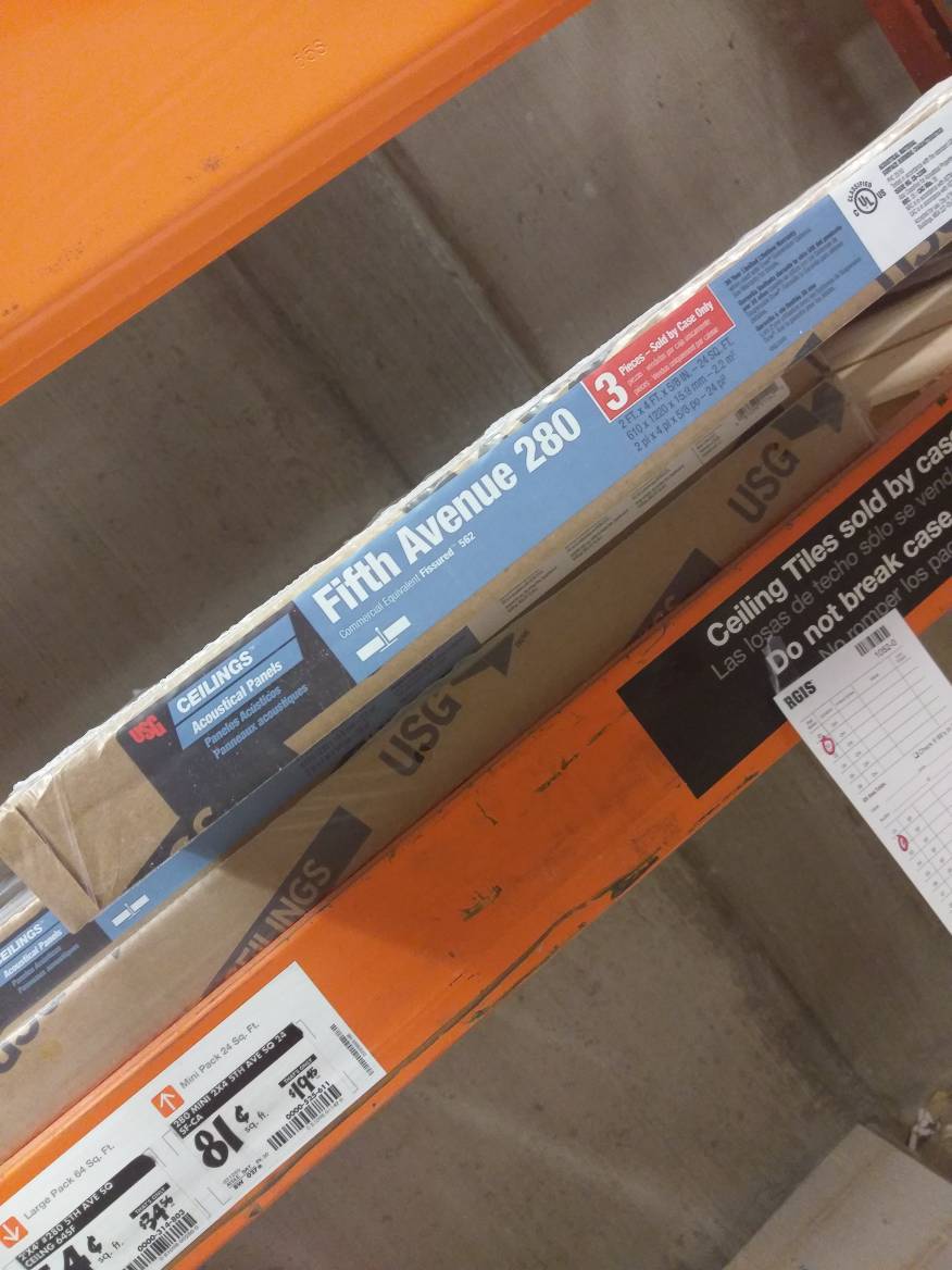

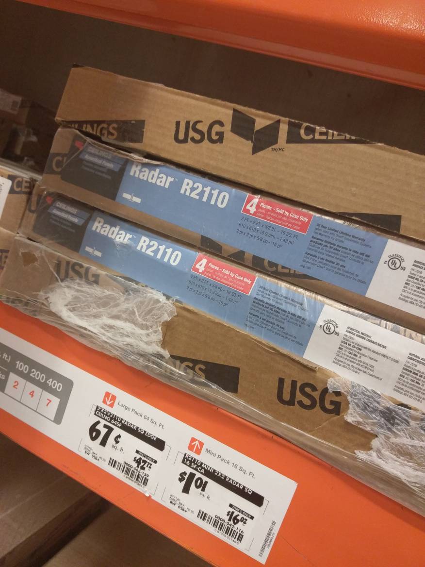

hey I can't seem to find the ceiling tile you used in there doors anywhere. at least not without buying a while box of them for about $150. is there an alternative to the ceiling tiles that can be sourced locally? thanks for the great build log

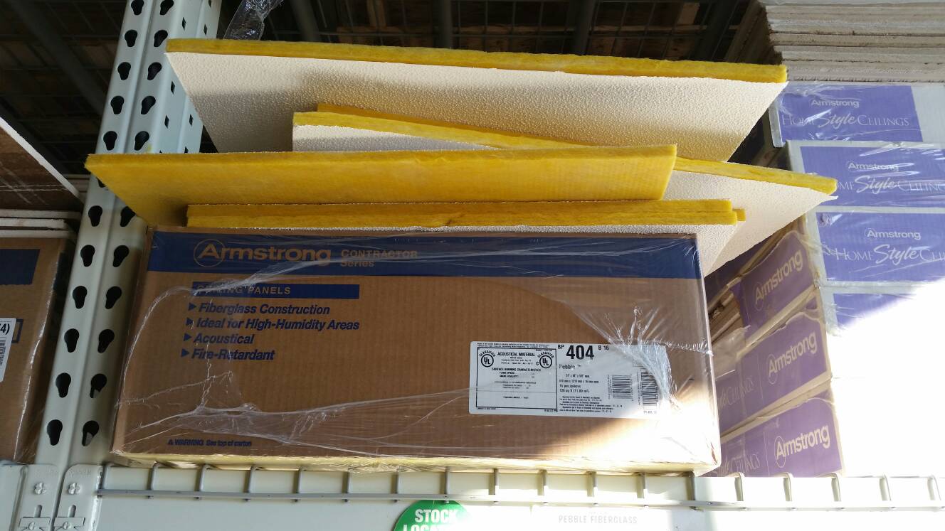

This would work well, smaller pieces are easier to fit. Fiberglass is inert and not prone to mold if it gets wet.
Rich V.

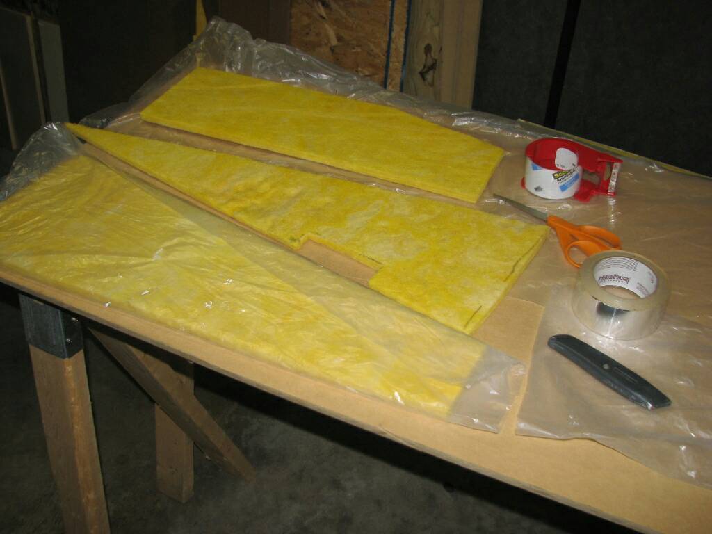

sweet thanks for the quick reply. this would still need to be wrapped in plastic correct? even though its Inert. should i try to compress it before installing it?
I recommend 1 mil plastic. Don't bother compressing because it won't stay. Aluminum foil tape holds it in place and can protect from moving parts.
