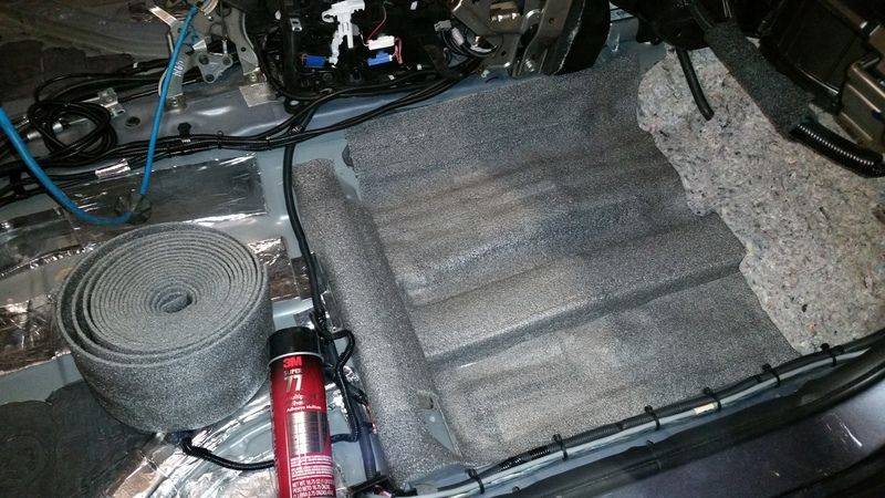

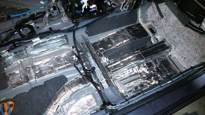

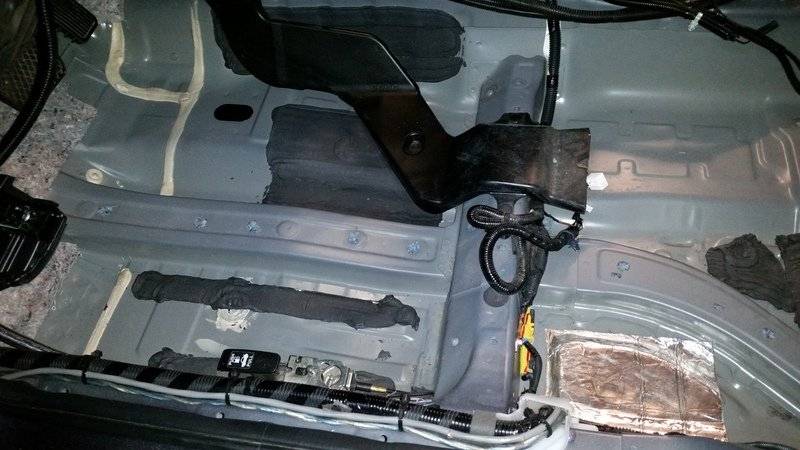

I added deadener, foam, and MLV to the flooring - huge improvement in road noise
starting
cavities stuffed with cotton sound insulation
Raammat BXT II added on the floor

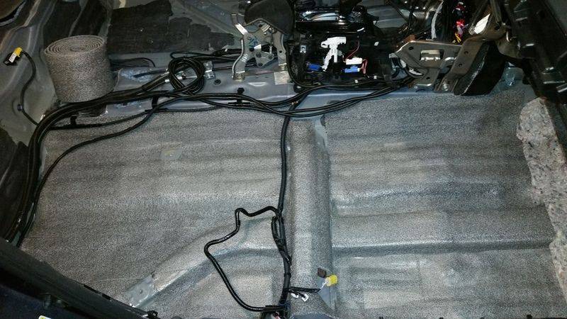

CCF glued to the floor (decoupler for MLV)

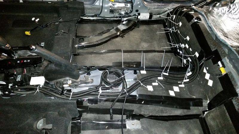

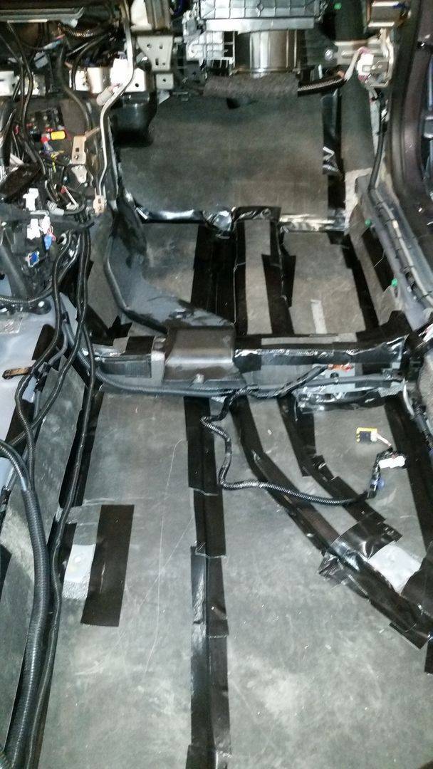

MLV applied with gorilla tape on seams
wires secured with tie mounts (glued on)
reassembled
