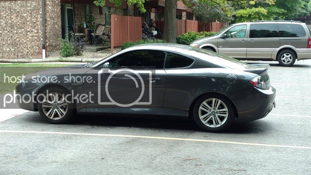

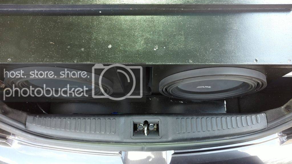

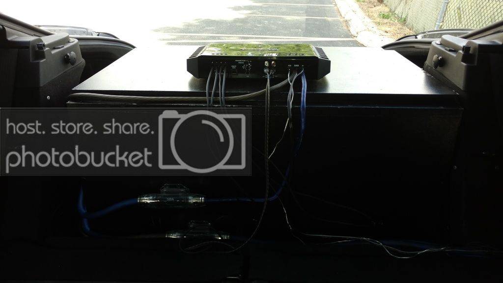

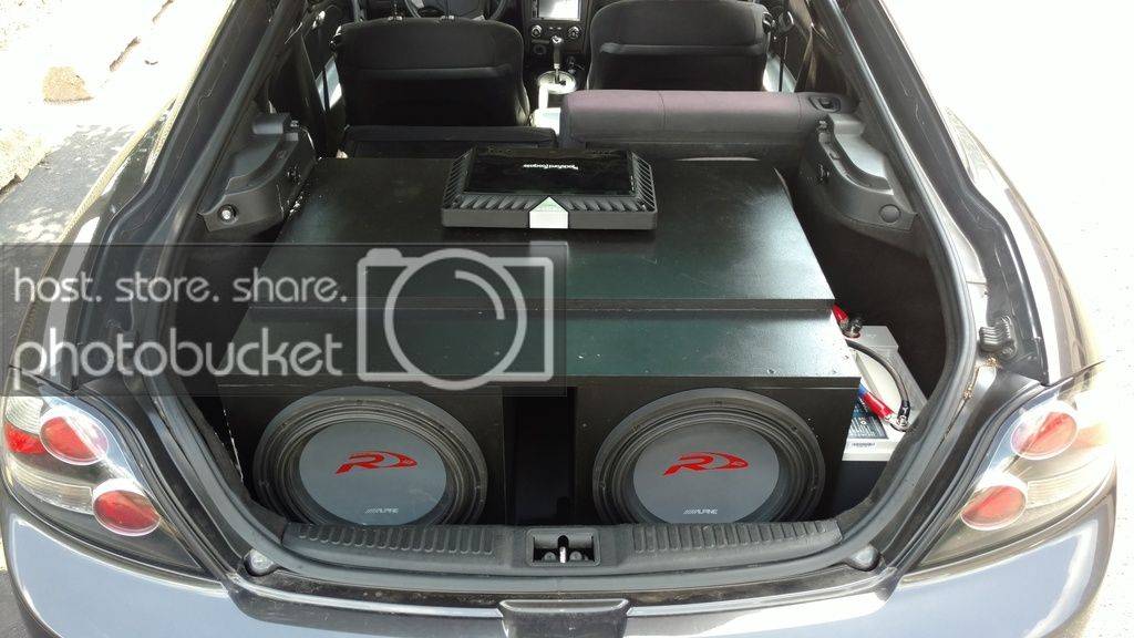

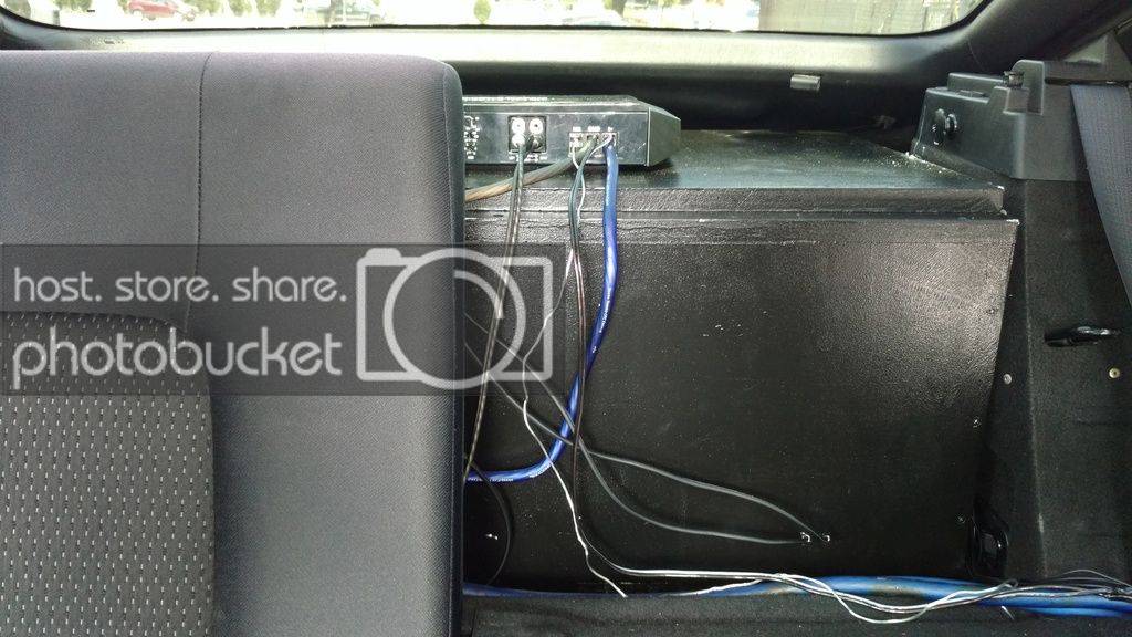

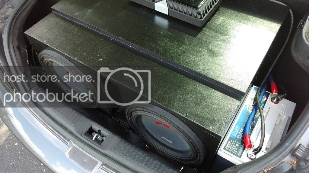

Thought I'd update this with some pics of it all finished

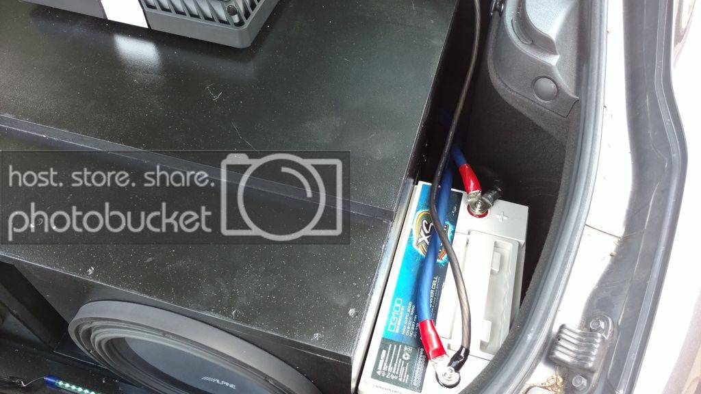

This is how low I'm riding in the back now, 90lb box, 75lb battery, two 20lb subs, 10lb amp, im doing a wheely haha I'm gonna have to lower the front

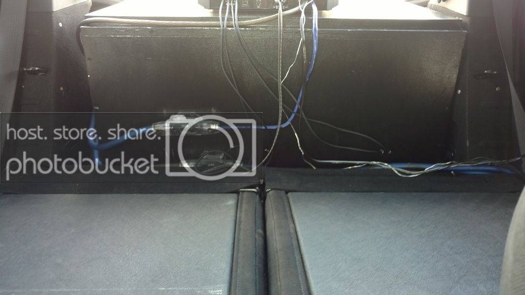

And this is how I ride around, the back left seat is up so a passenger can ride there and just remind people the back seats do work. Then the other seat I leave down just for any possible air that can pass through
With it like that I metered it today with a term lab. With the mic on the windshield by the dash and my windows down I peaked at 34hz at 141.5db.
With the windows up there were two peaks, one at 38hz and one at 56hz. I metered a 141.2db at 56hz with the windows up, but I never ride with the windows up, always got them down.
The first test tone sweep I played my amp put out 1024 watts which the guy was quite surprised at. Then my later scores it was putting out around 700 watts.
I didn't make this for numbers, it's for music and not competing but I thought I'd meter it just for fun to know. I can play my subs full volume the way I have it set for forever and they never start to smell. The show I was at yesterday, everybody had to turn their bass down after a while cuz their subs were smelling so I like that about mine, although their systems were way louder

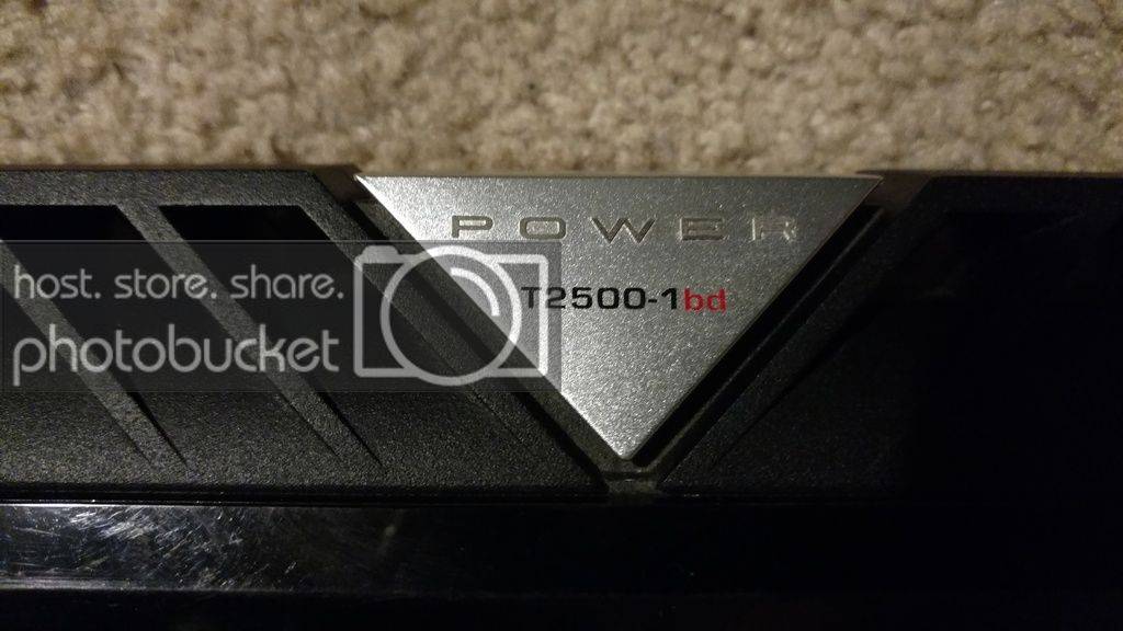

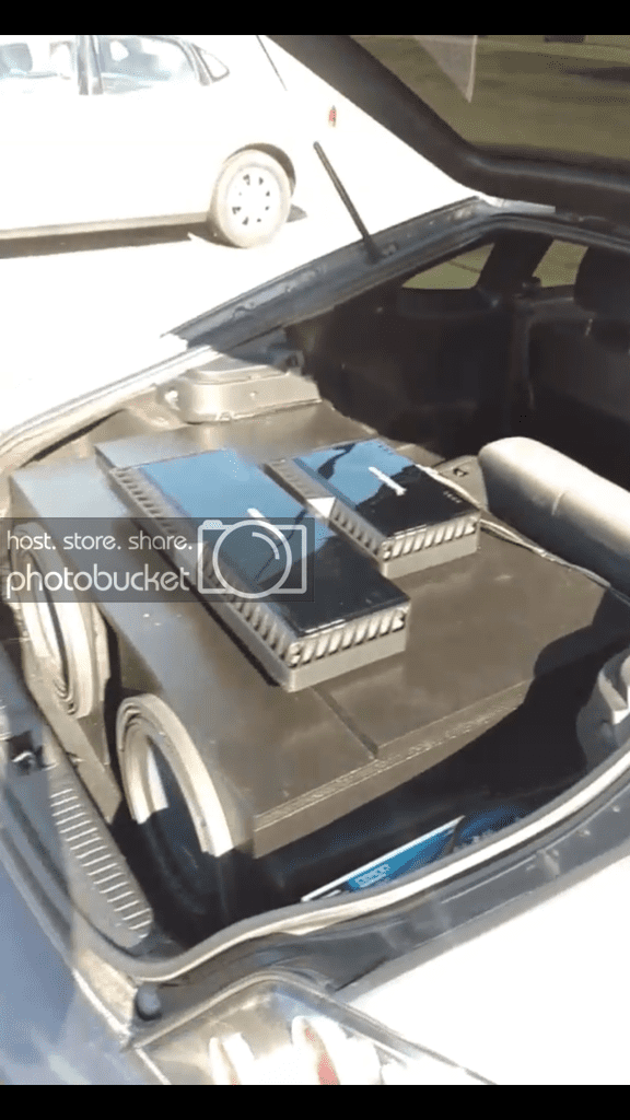

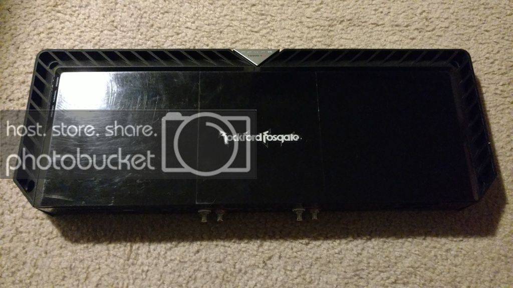

Time to update this thread, got my car alarm installed today, also a few weeks ago I got this
So excited! I've always wanted a beast Rockford amp, I don't have it hooked up yet because I don't want to damage my type-r's
Sitting next to my current little baby rockford for size comparison

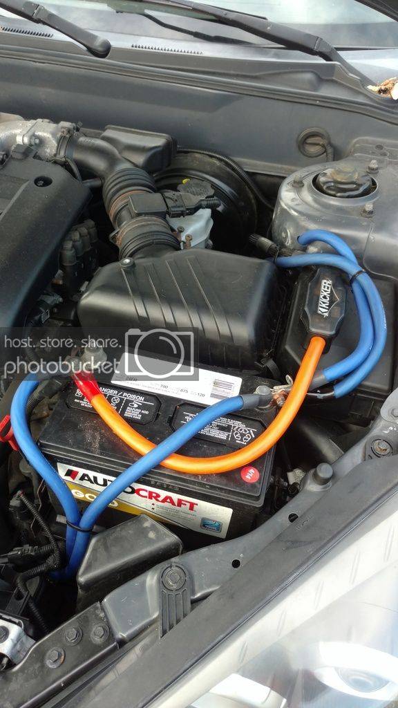

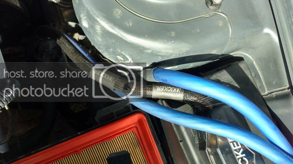

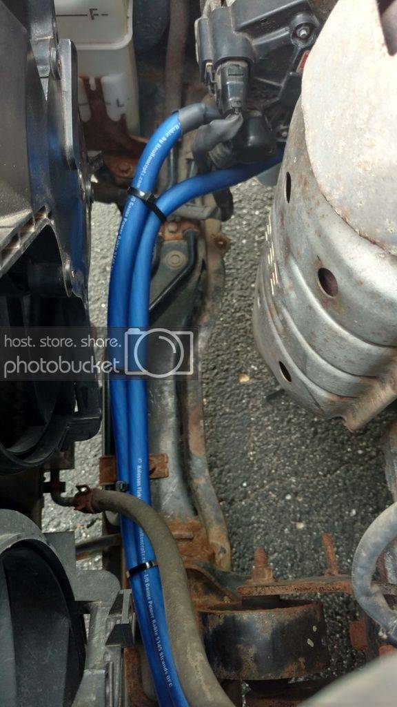

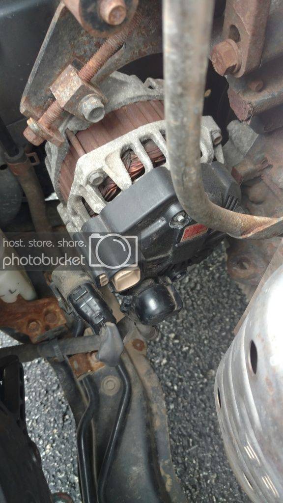

I did the big three upgrade, first time I ever did this, my car used to start at 14.0 volts now it starts at 14.3v. At idle the voltage still will start dropping down to 12.2 on peaks after a while, but at least while driving 30mph the rpms being up keeps my voltage at 14.0.
Hope I did everything right, here's a bunch of pics of it

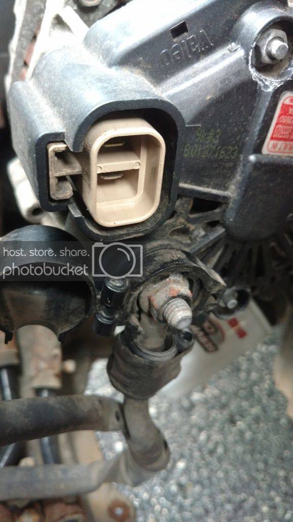

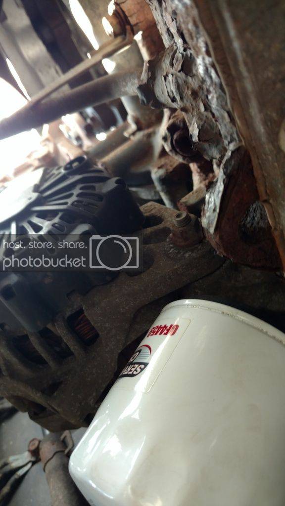

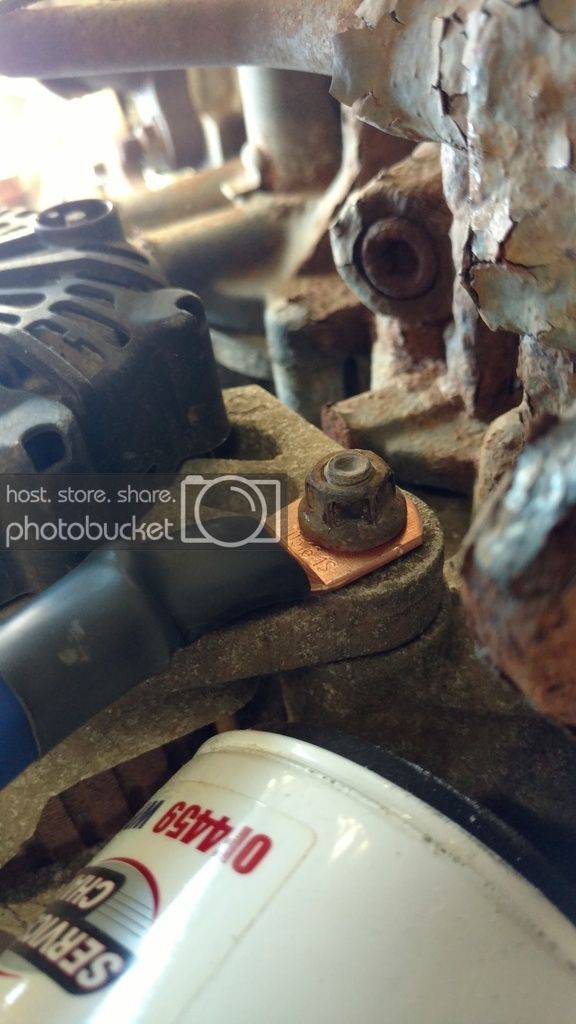

Looking at my alternator to find where to connect the positive
Here's where I put my 1/0 positive to

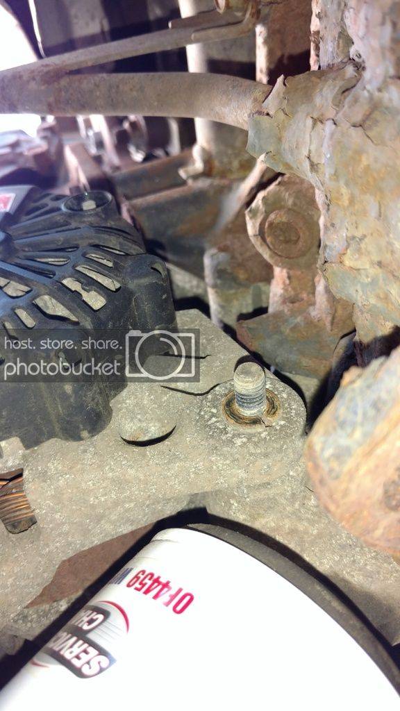

Here's where I grounded the battery, the bolt for the fuse box
Before I sanded the paint away
After I sanded the paint away

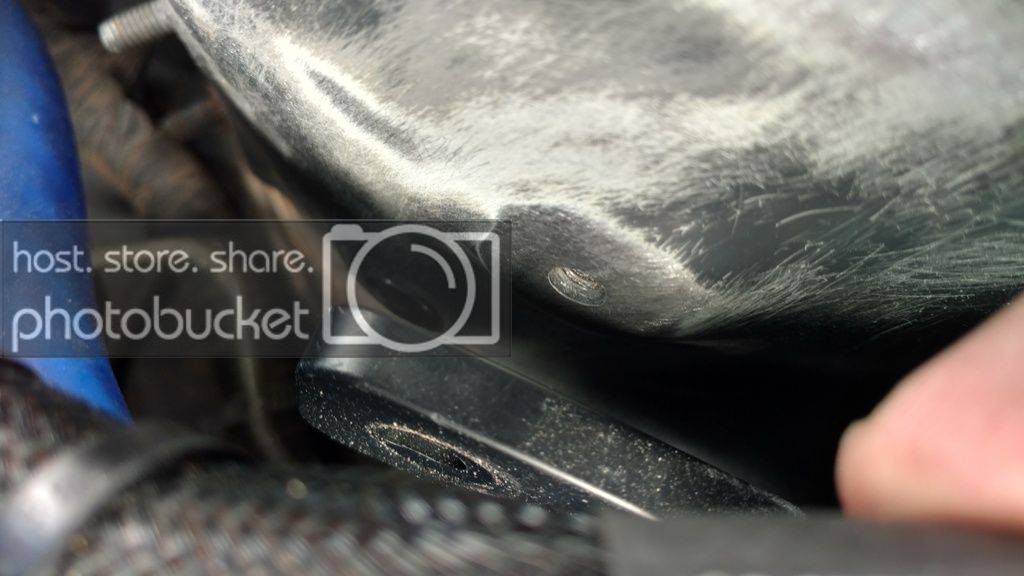

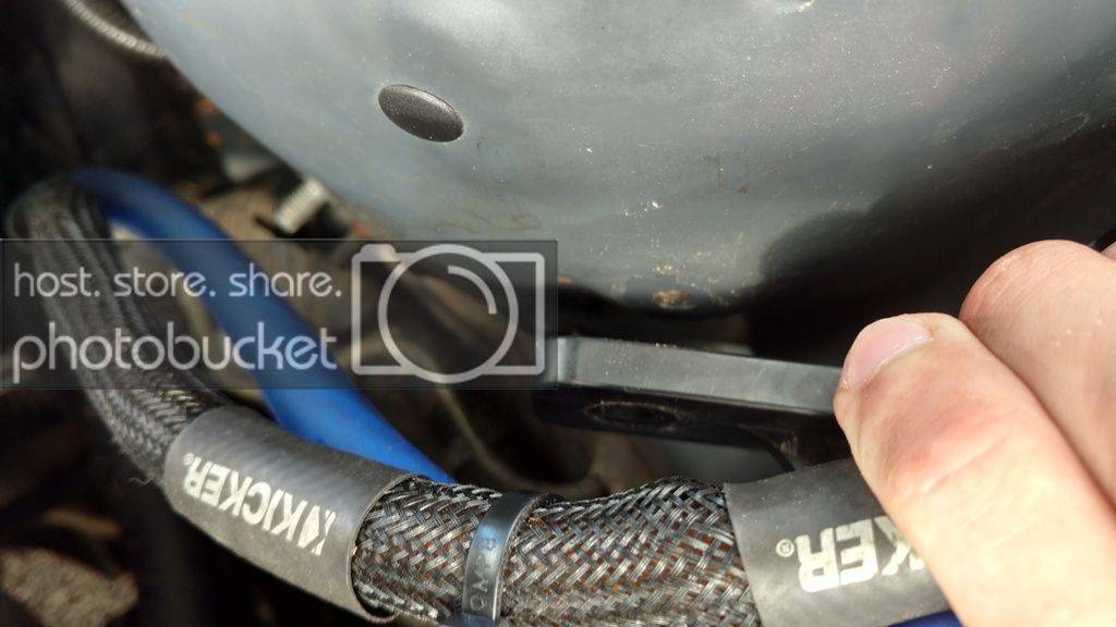

Then it was time for the battery negative to alternator negative. Decided to mount to this bolt here
Bolt unscrewed
Connected
Had a local shop do the crimping for me

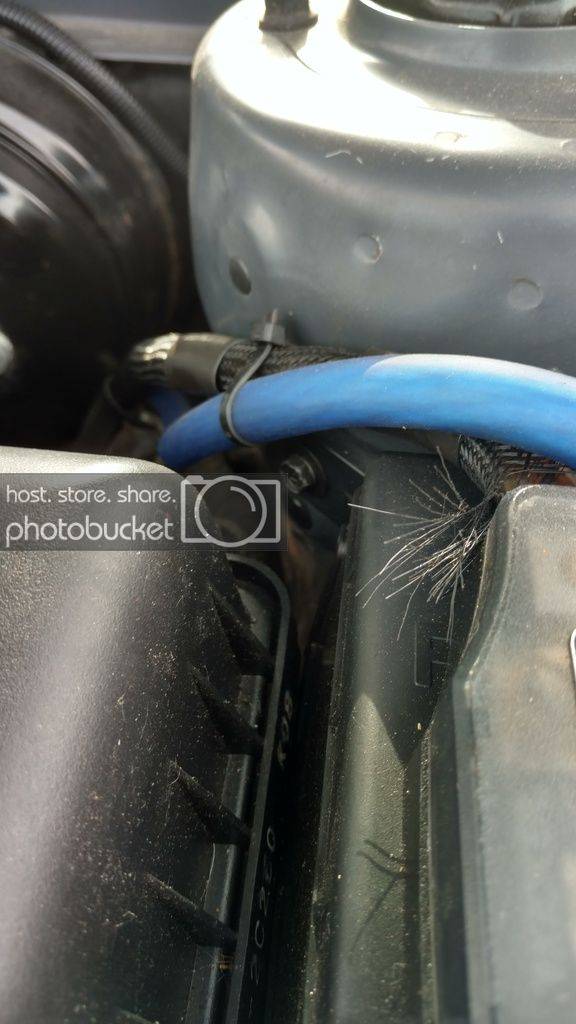

Zip tied both the alternator wires
All finished
Will be upgrading this battery to an XS power D3400 real soon, thinking I won't need to replace this tiny stock 90 amp alt as long as I don't bump my music full tilt at idle after I hook up my T2500-1bdcp
Yes, sand off the rust/ corrosion unless you already did and I'm just seeing things. ( which is entirely possible)
I did sand it slightly after that pic was taken but I was in a hurry at the moment and could probably do better if I had something other than sand paper, I think I'll take a look at it again soon and try to sand it with a power tool, thanks!
