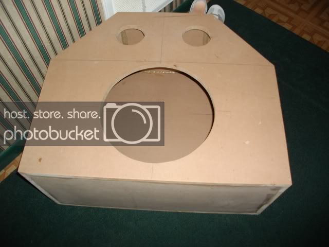

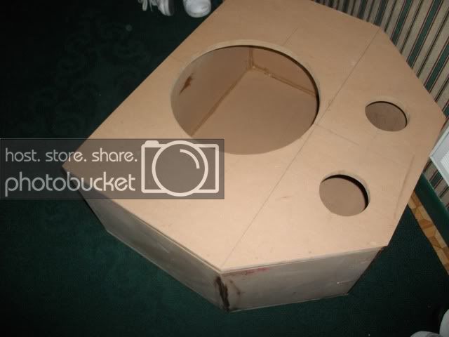

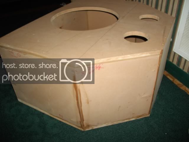

FINALLY, new pics:
It's not perfect, but it will be when it's finished. I'll just need to add some filler here and there and maybe do a little sanding. I'm going to use some 1x2 furring strips for bracing. The false floor will act as a double baffle.
Its a face! lol
So i guess it is firing up into the trunklid?
Yeah, it's ugly as all hell. It doesn't matter, because it'll never be seen. It has plenty of airspace and the 4" aeros will allow me to tune to the mid 30's. The enclosure is going into the tire well and I'm going to brace around it and build a false floor. I know you have/had a LS, so you should be familiar with the trunk. This enclosure is going to raise the floor in the trunk about 6". It'll be nowhere near the deck lid. The sub and ports firing up isn't ideal, but it should be far from terrible.

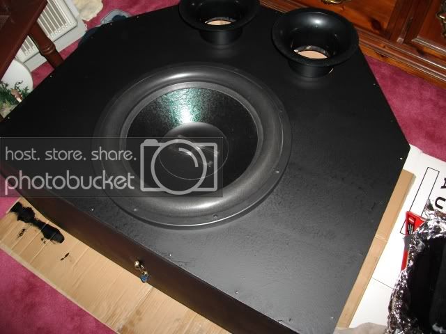

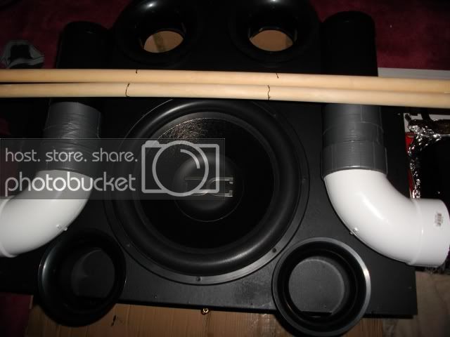

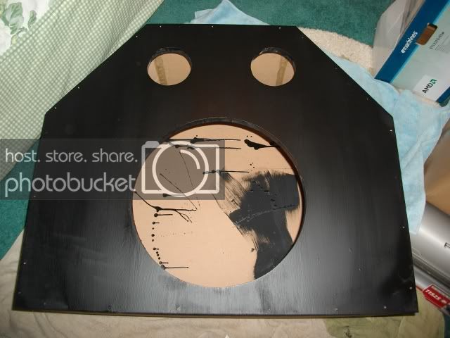

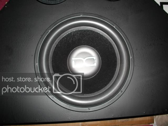

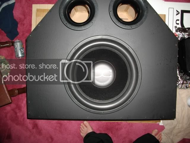

An update:
The enclosure has a few coats of black paint and the bolt terminals are installed. The bracing and aero's need to be cut to length, but I already have the proper measurements ready to go. Making a cut or two isn't a big deal. I'm still debating whether or not I want to put in some polyfill, though. It really isn't necessary, but the inside of this thing is even uglier than the outside. //content.invisioncic.com/y282845/emoticons/smile.gif.1ebc41e1811405b213edfc4622c41e27.gif
About 30 minutes of work will have this thing officially ready to make some noise. Once we get it sitting perfectly level in the tire well & have a solid idea of what it's going to sound like, maybe it'll ignite some enthusiasm to finish this build once and for all.
Here are a few pics:
And please remember this: The enclosure won't be seen. It'll be concealed 100% by a false floor that will also act as a double baffle. I'm well aware of the enclosure's goofy look, but it has the correct internal volume and the tuning frequency that I was shooting for. The only problem is the ports are a little close to the walls of the enclosure, but I didn't see a way around it.
And yes, the duct tape on the port tubes is just there for the pure hell of it. The joints were roughed up, cleaned and glued. I just took a double precaution with the duct tape to make sure everything is 100% leak proof.
